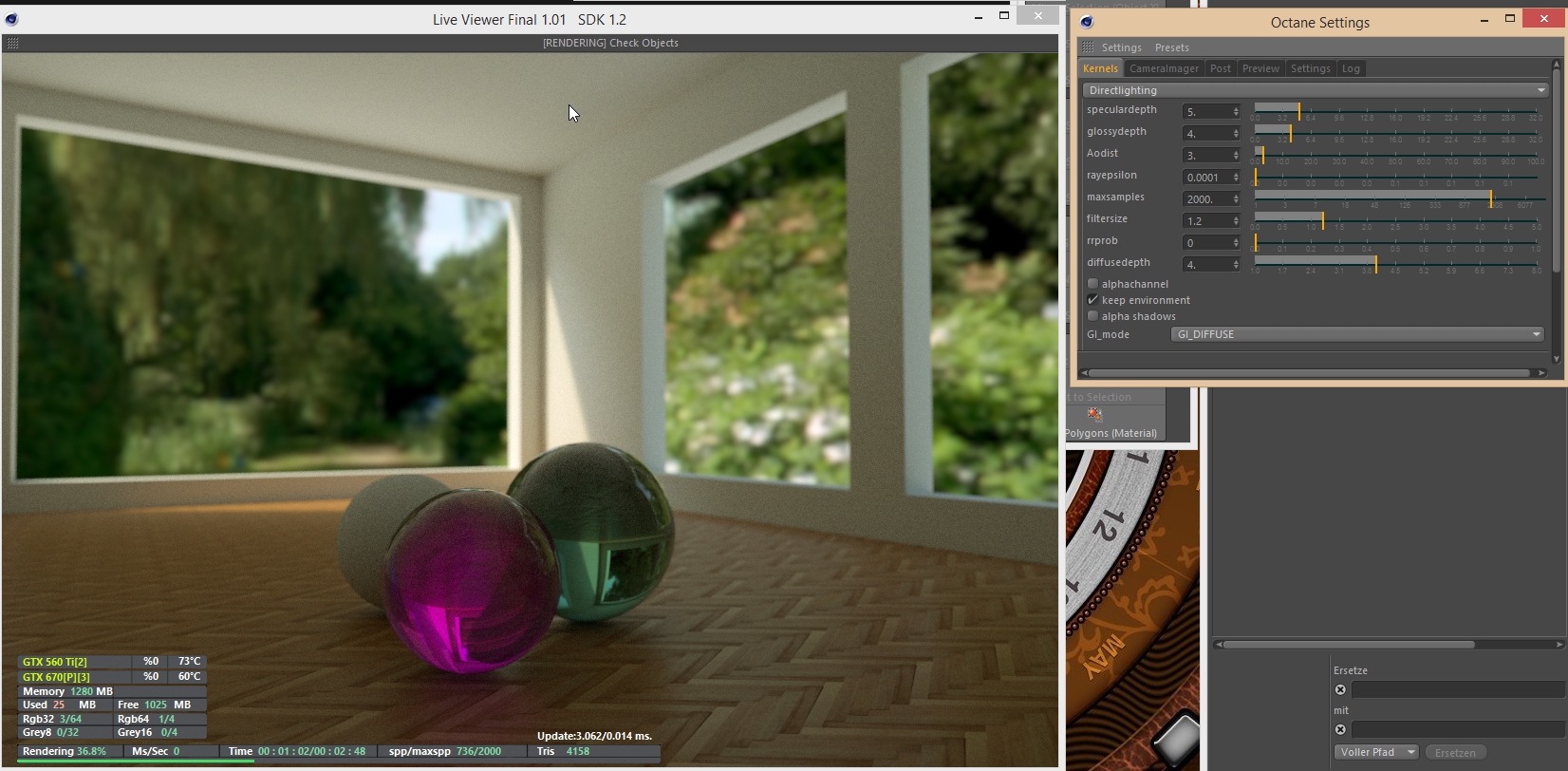

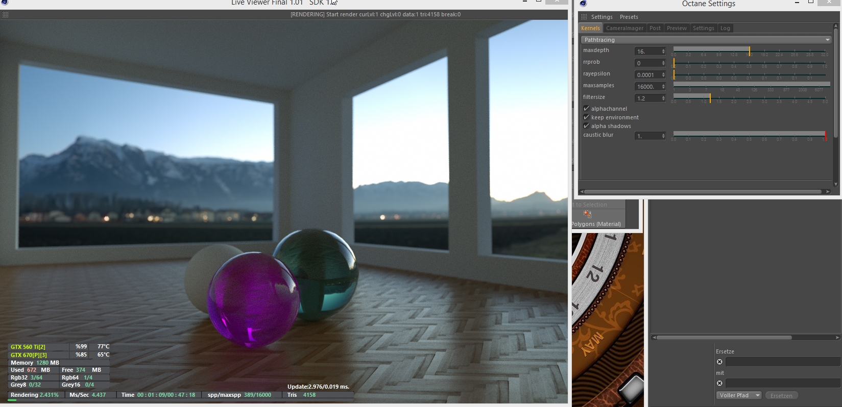

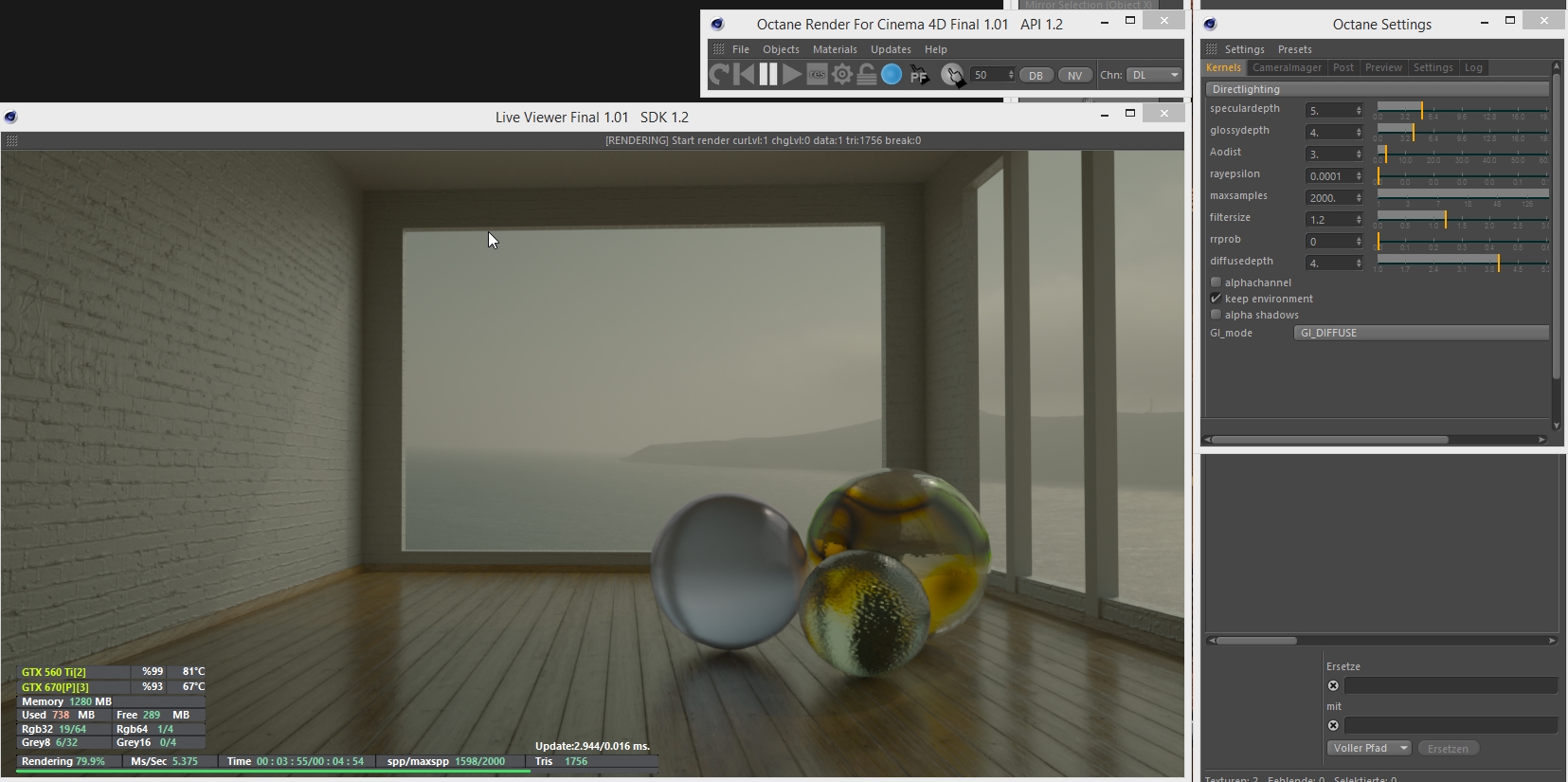

Hi Aoctar and other repliers,
it is weird. Yesterdy I had this bad results I showed but today the same scenes are perfect. Your scene untouched is perfect like yours and my scene as well. I figured out that the problems seem to be related to my big HDRI files (160 MB). Today Octane stated a memory error using such files. Yesterday the same files had no errors but may have been the reason for the noisy results? My graphics cards supply 2GB and 1GB. I thought that should be enouph for handling such fils. But obviously it is'nt.
Anyway - results look good now.
Saveing images is still not possible. Maybe I am doing it wrong? Under FILE > SAVE AS PNG16 ... it opens the SAVE-DIALOG, I put a name and save that into my RENDER folder. But no file is saved after. I tried that with images that have been rendered full and others that have been stopped rendering. No file is saved in either way.
Edit: the images were rendered in Live Viewer. When renedered in Image Manager I can save the files, but then the parametric spheres are not visible. Only if those are editable. Am I wrong or did you fix this issue a million years ago, too?
