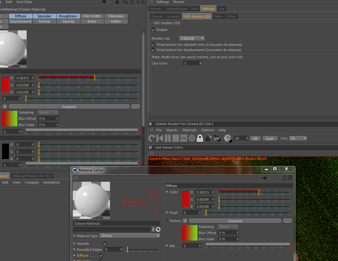

Hi Aoktar
I've juste purchased Octane and I don't get it.
With c4d shader I don't see any modifications in the material preview window.
It worked in the demo version.
Is that normal ?
ps: I'm running octane on c4d r14 with a k4000 and the ndvia drivers 340.52

hi and welcome,FxDesign wrote:Hi Aoktar
I've juste purchased Octane and I don't get.
Is that normal ?
checking now and you're right. I'll try yo find what's wrong here, sorry

gray preview is caused by my mistake on c4d shader things. I'm checking now this sections.miohn wrote:Hi Ahmet,
