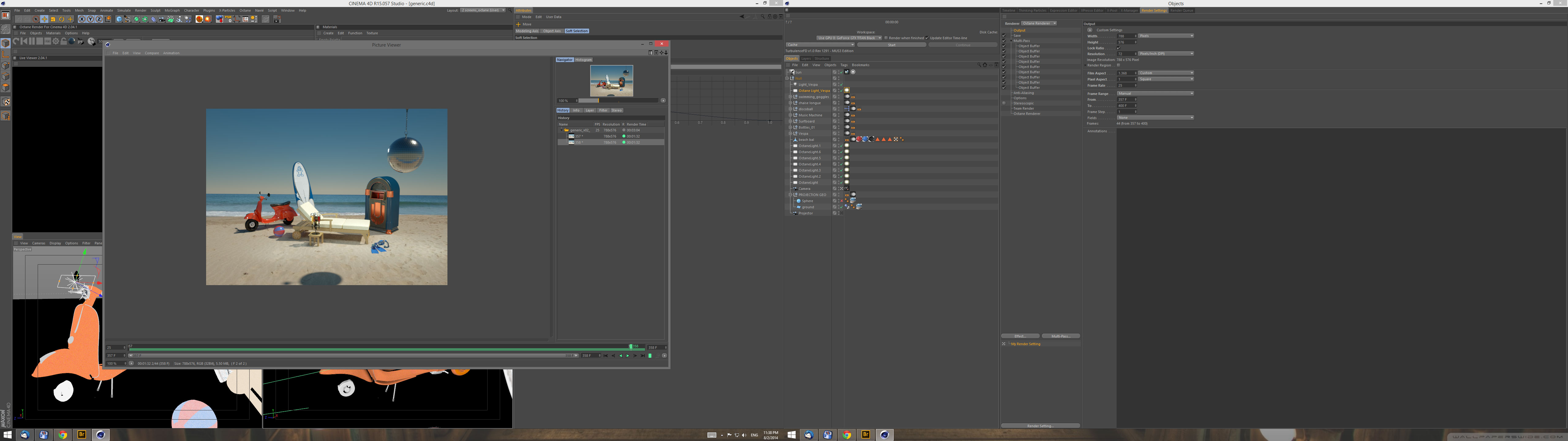

Now I have again the old issue from 2.02 if I recall, when I can't render more than one frame.
I attached a screenshot and a log. The log has 2.04 version from what I see, but that version crashes C4D from time to time during rendering (about 4-5 times in the last ~20hrs) and I just switched to 2.04.1
octane 2.04 140802 234437.log
(24.81 KiB) Downloaded 222 times
win 10 pro | 1 x 2070, 1 x titan black | 4930k | 64gb
Posts: 16068
Location: Türkiye
alexmunteanu, what kind of crash? don't try except 2.04.1. If you have crash, pls send to me bugreport.zip and your scene. Also can you send me this scene?
