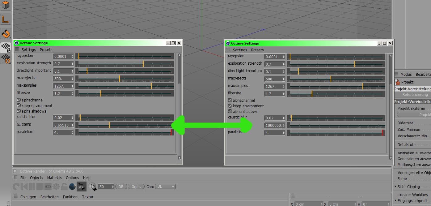

Hey Achmed, I do not know whether we of the same one speak .:)
See picture what I mean.
Which setting is better. Left with 0.65513 or the right side with 100000.
Posts: 16068
Location: Türkiye
Rudi wrote:Hey Achmed, I do not know whether we of the same one speak .:)
yes we talk for that. I have no big info expect some words, they are on standalone 2.04 thread. let's test it to understand

I've tested clamp value...
It very usefull for bad hdri (before I was tweaking gamma and power but you loose color this way) it gives smoother render and keep hdri color, i love it.

LudovicRouy
Posts: 216
Joined: Sat Apr 03, 2010 5:05 pm
Location: FRANCE
depends of the power of your hdri for this one around 5 seems to correct a lot of noise
