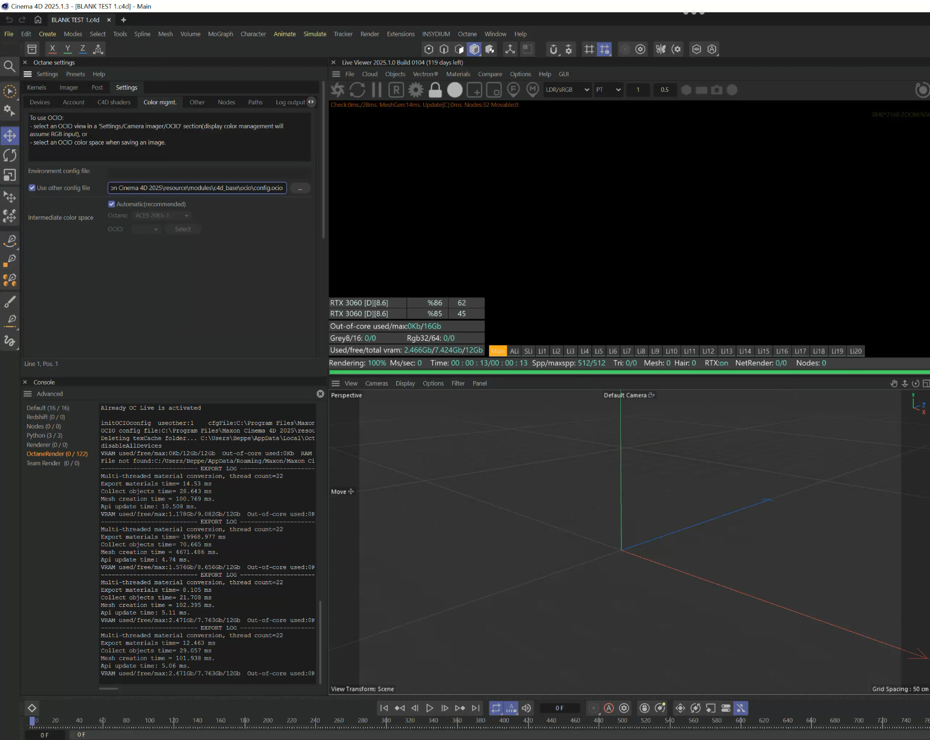

UON.Visuals wrote: Sat Apr 19, 2025 11:03 pm I've narrowed down the problem for you guys! It's the Octane Settings themselves causing the issue. I loaded the Octane settings while in C4D default blank scene with no changes to them, saved those as a preset, then opened up my custom blank scene that doen't render and loaded that preset. Worked on first try!
So there's some Octane setting that's causing issues with the last few plugin releases
Sorry, I cannot reproduce the issue, your BLANK_TEST_1 scene works without errors here:
Please note that I'm using the config.ocio file provided by Maxon C4D 2025.

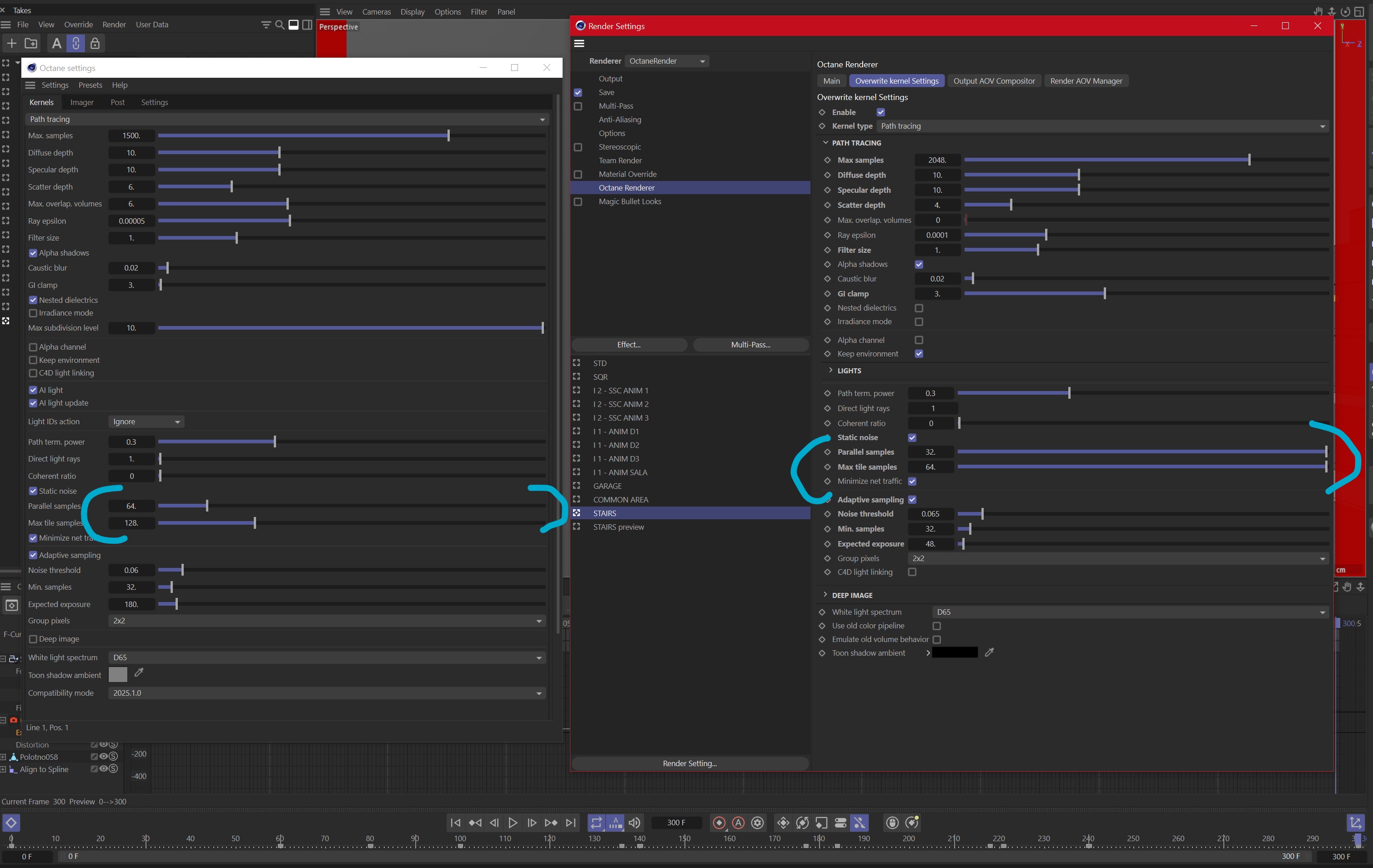

Hi, team
Just wanted to make sure:
So Parallel and Max Tiles Samples increased values in the kernel options are only for liveview window?

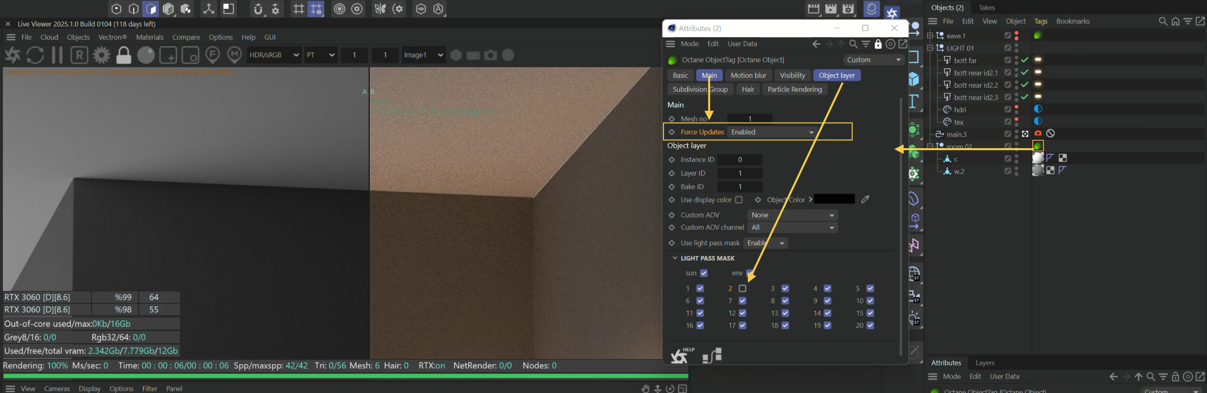

Thanks for sharing the scene.
Light Masking is working as expected, but there is an issue with Live View update, so please go to "room_02" Octane Object Tag, Main tab, and enable the "Force update" option:

Thanks for the report, Parallel and Max Tiles Samples must be updated also in Overwrite Kernel Settings tab, so it must to be fixed.

Thank you, Beppe.
Glad to help!

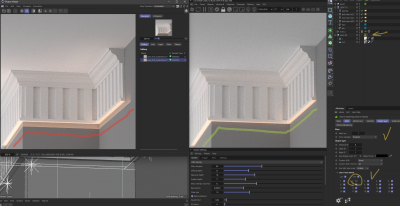

Hello, thank you for your answer!
Did the same as your instruction with no effect. Still get a wierd result to PV while "as expected" work of light masking at LV. Please see screenshot.
And you say nothing for a second question, unfortunately.
Here it is "a few versions ago the ability to add alpha channel to a beauty pass while saving PSD through Render AOV manager is gone. Why so? Could you fix it please?"
