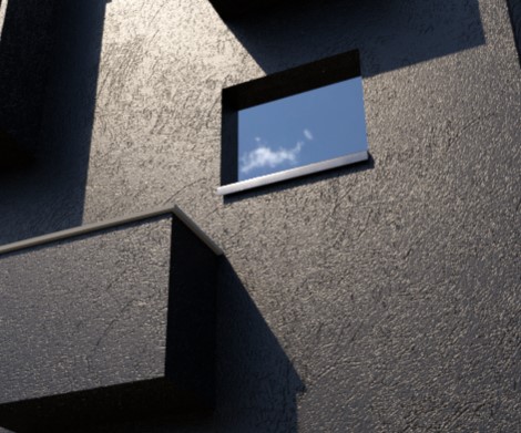

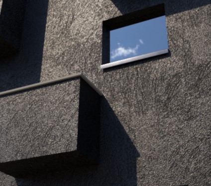

Box Texture Projection cause that Bump Channel completely doesn't work compared to UV or other projections :
Box Projection 0.25 image bump strenght :
UV Projection, the same bump :
Also Box is about 25 times smaller than UV.
