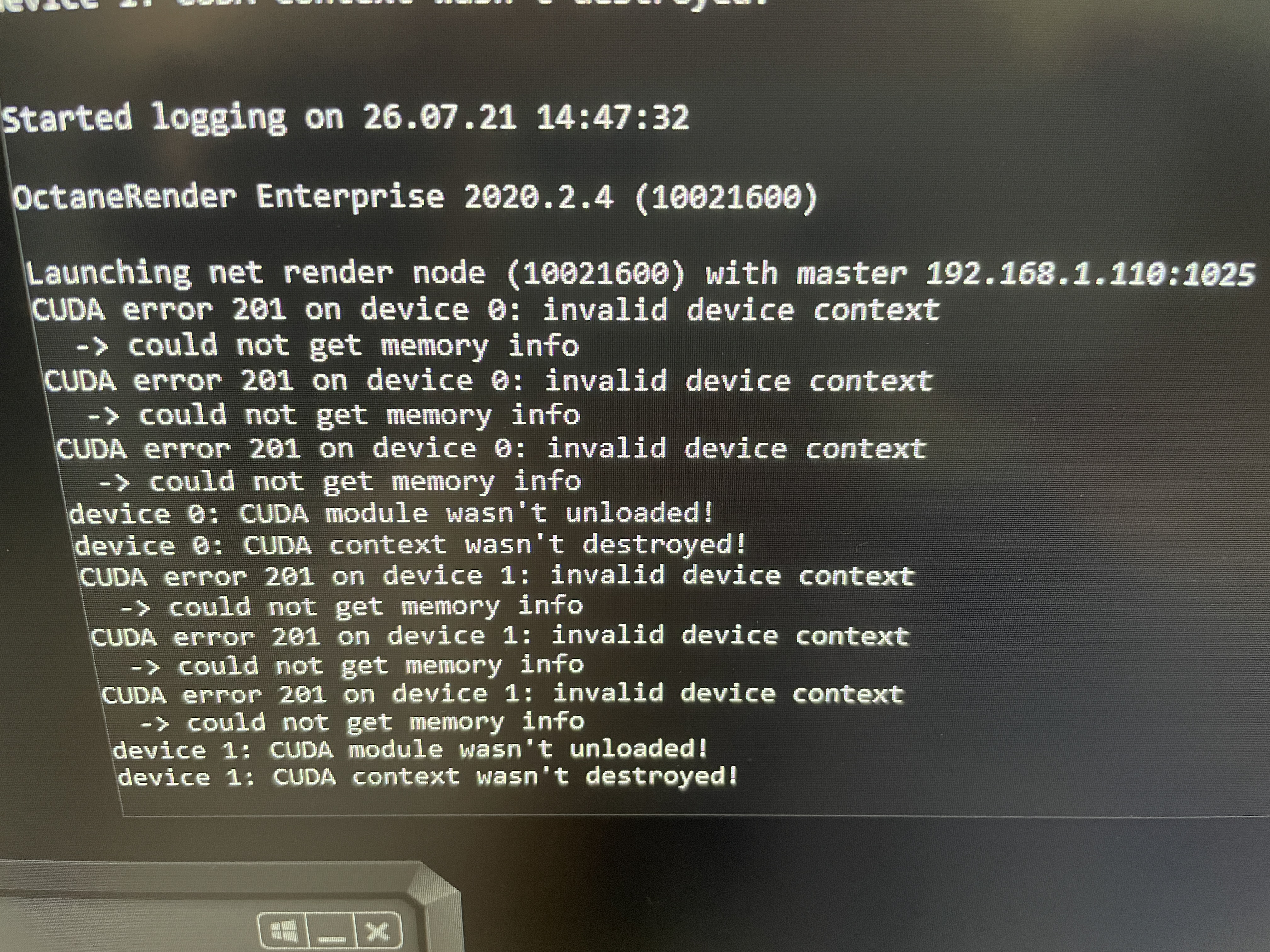

But I have a very pressing matter which I communicated twice in the past without solving it. This happens almost in all of the scenes I tried render as sequences. They are all complex type of scenes with particles or scatters or alembics etc so its really hard to do tests and see why and what.
PV is simply freezing (and c4d doesnt crash) while network rendering. It stops working on a random frame each time but c4d is responsive. Doesnt crash i can just cancel manually the render and resend it.
- I did format my slave machines, vram is never above 3gb in all gpus. Using win 2009/ 471.41 drivers/ r23.
I am using splashtop (but first time so this might not be related as this issue was present in the past) and noticed that it also drops randomly on one machine sometimes. Maybe this relates to my issue here? Maybe something in network configurations?
thanulee
Posts: 712
Joined: Sat Dec 19, 2015 11:00 pm
So after formatting, tried this scene both r23 and s24 and its freezing when slaves join on frame 1:
https://www.dropbox.com/s/aa42515dhn6o0 ... r.c4d?dl=0
This is an old scene I exchange with Beppe 2 months ago. Today had this issue again on another scene, and it seems that there is something wrong here on my setup in network. I d appreciate some remote help.
edit: uploaded the specific slave error.

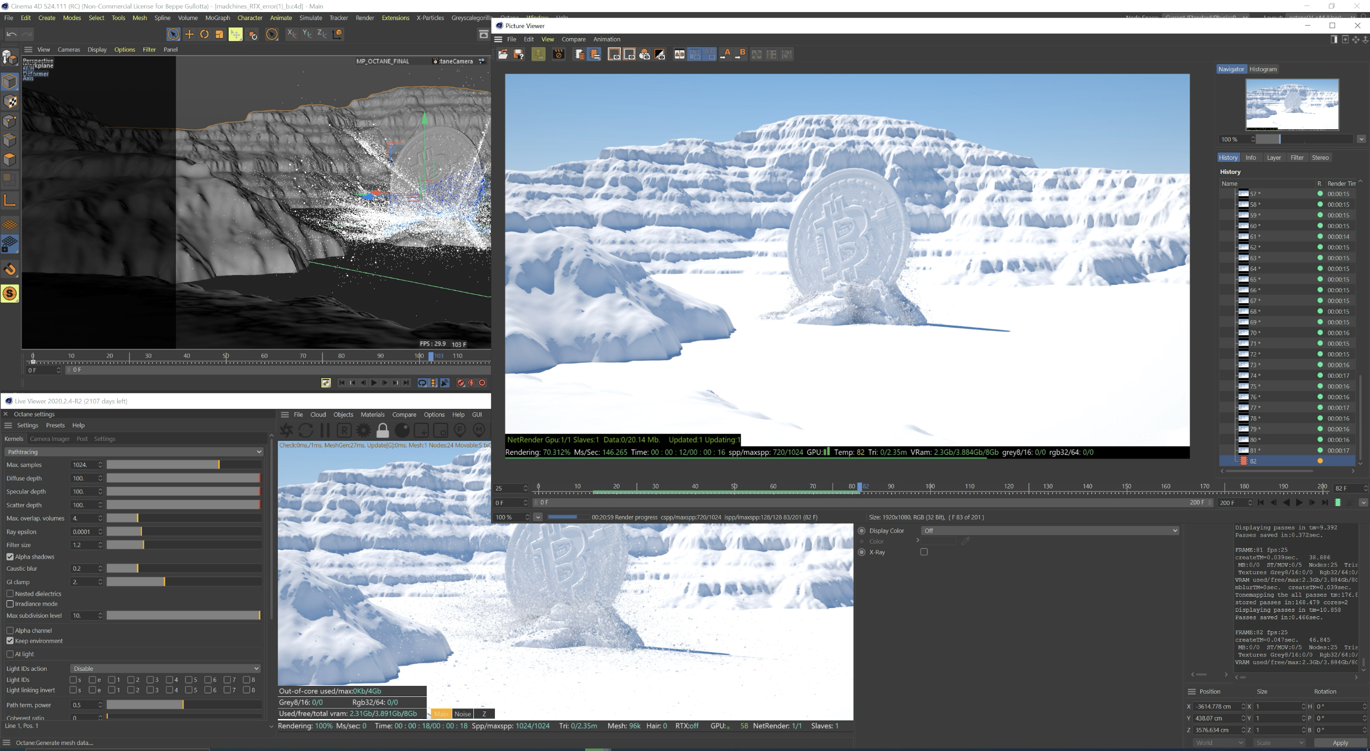

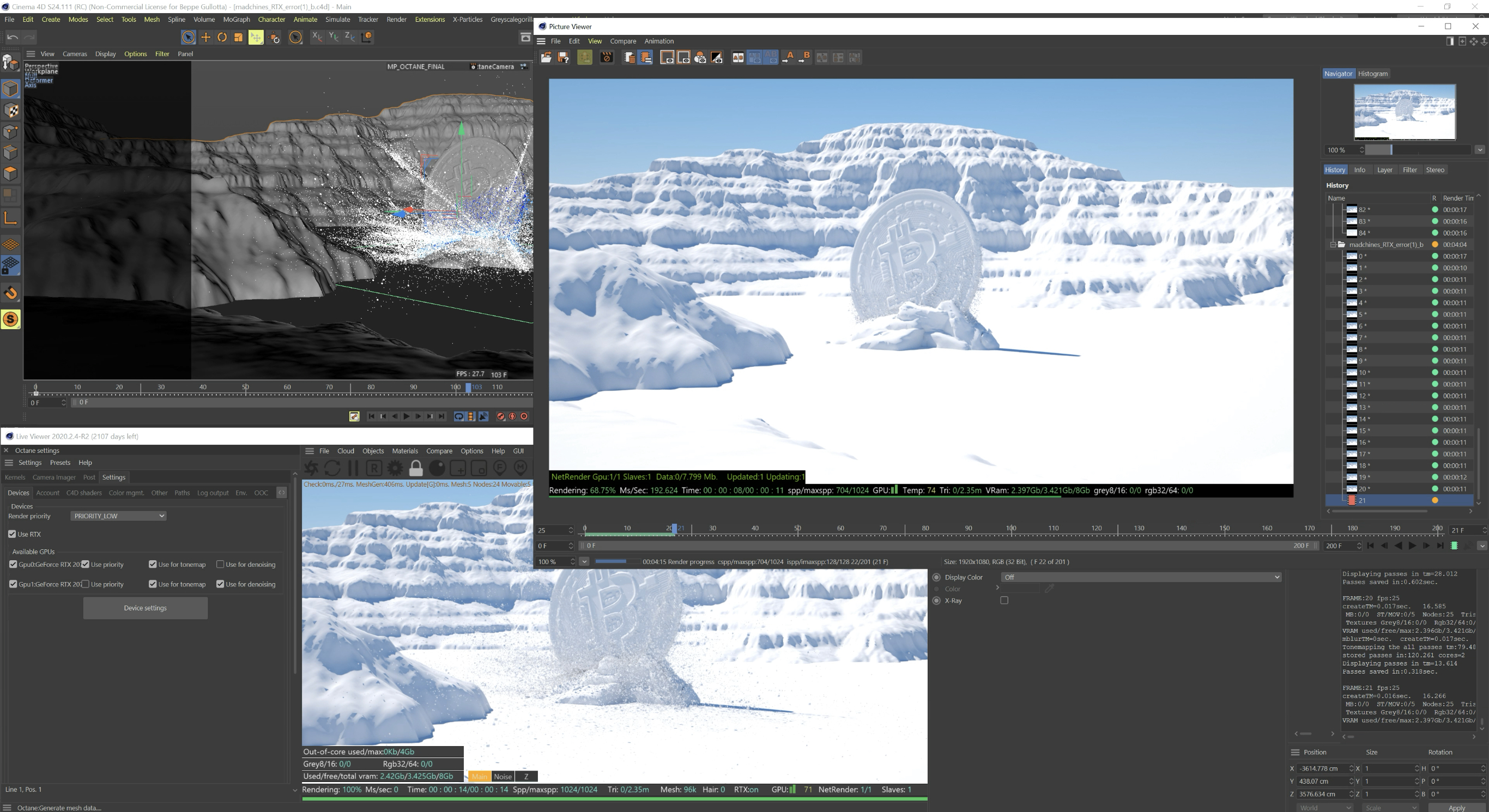

Posts: 10611
please make sure to install Standalone in both Workstation and Render-Node, to correctly setup the TdrDelay registry in Win 10.
Your scene works perfectly in Net render here, wiith both RTX ON, and OFF:

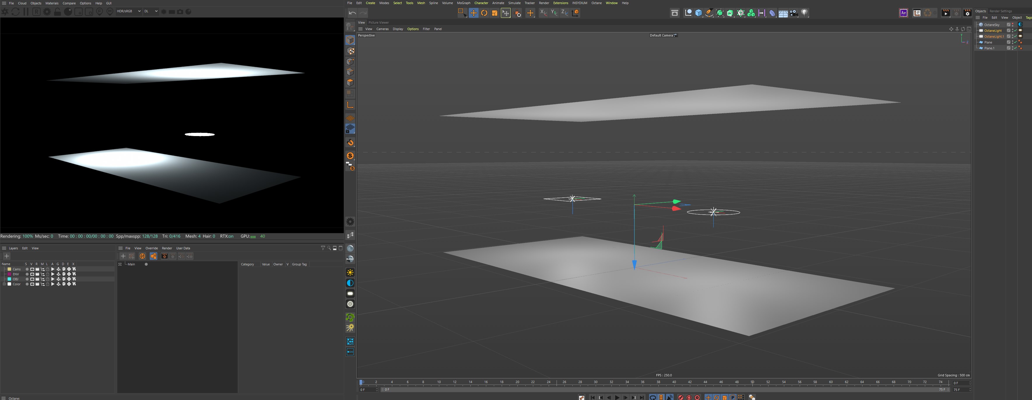

iDani
Posts: 38
Joined: Sun Jun 07, 2015 9:24 am
Location: Germany
the Octane Light as a disc has a wrong direction (- Z). Rectangle Light is right (+ Z)
cheers Dani

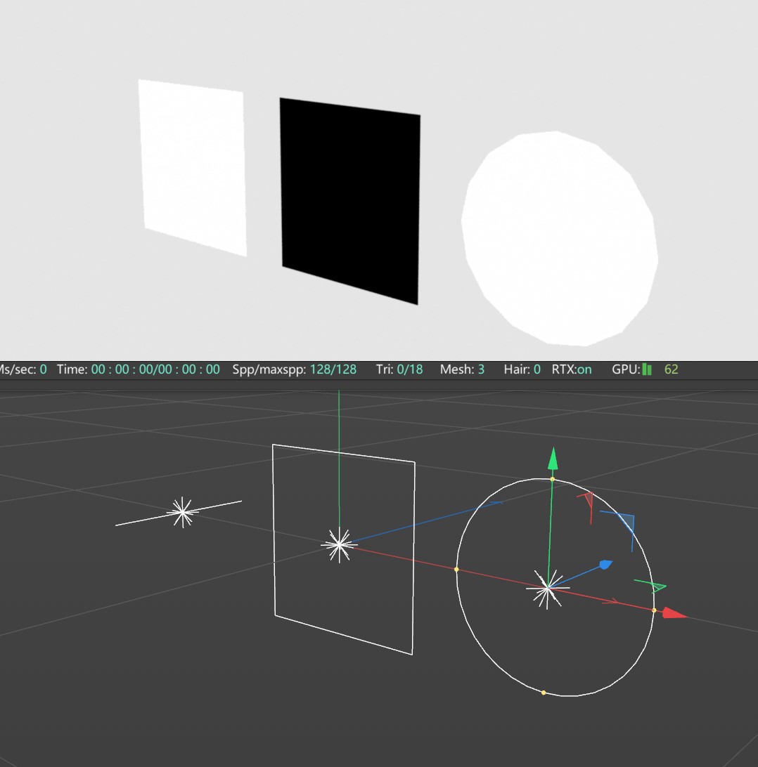

iDani wrote:Hi,
cheers Dani
The attachment Screenshot 2021-07-28 082933.jpg is no longer available
Yes Finally someone point this out! I wasnt be able to post in the forum before I was deperately wishing someone will find this problem and report to developer since the latest stable build lol. After long weeks finally!
Here is more screenshot of Wrong direction of OctaneLight.
Wrong Z direction Light
Thx
