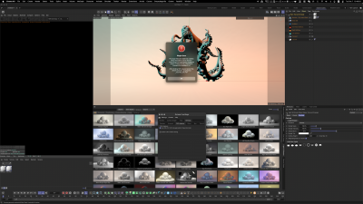

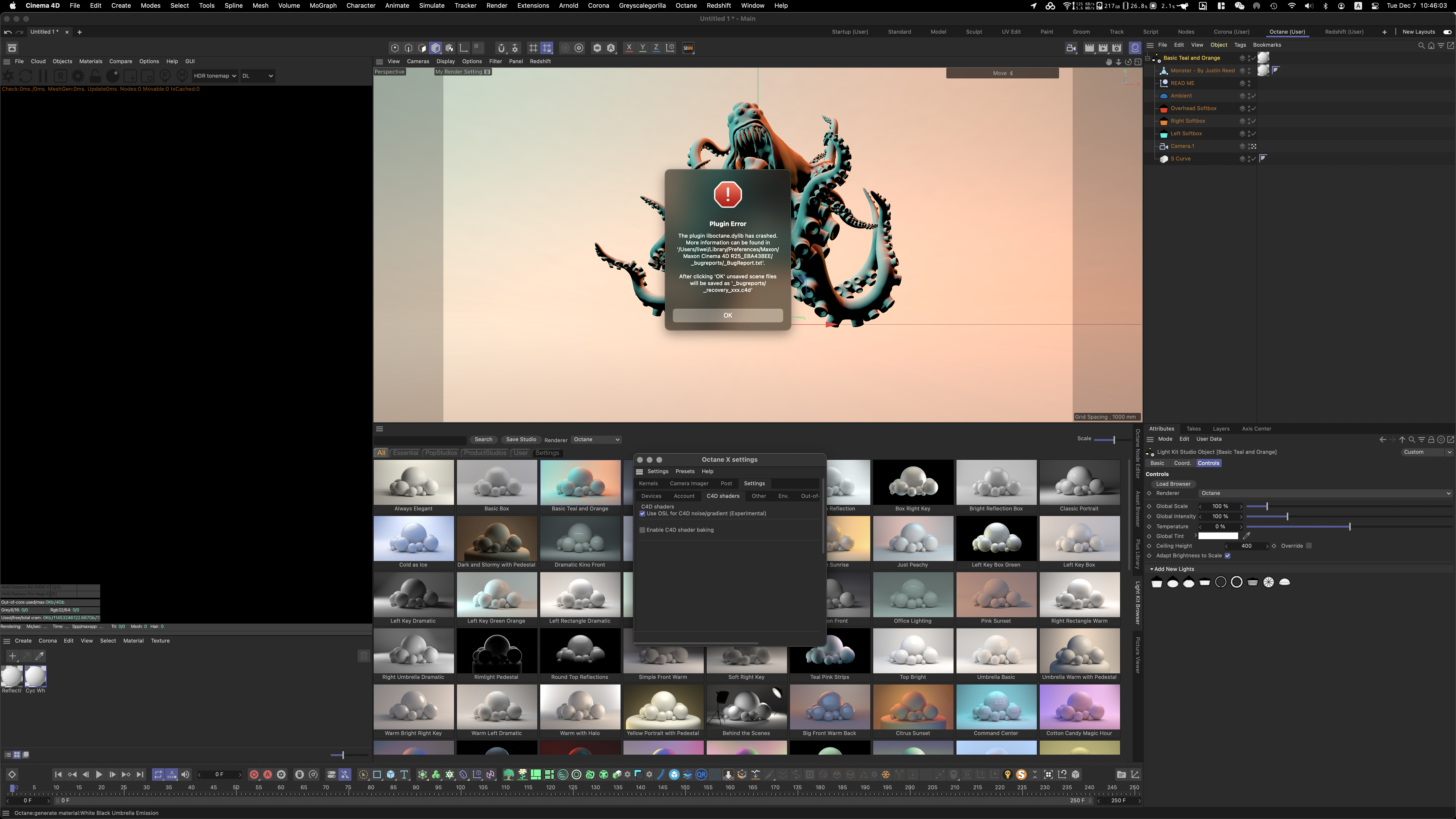

jay1990929
Posts: 3
Joined: Fri Nov 29, 2019 9:54 am
Thank you for the help. I disable the c4d shader as link below. it's still keep crashing, I can't even hit the render button, c4d immediately crashed when I open the IPR view. Still no improvement, sorry....

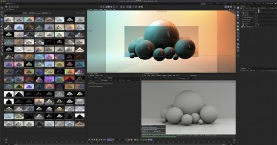

Posts: 10609
here it is working without errors, but, since they are not Octane lights, the result is completely different from c4d standard render:
Please write to help at otoy dot com, asking for Beppe, in this way I can try to investigate more deeply.
