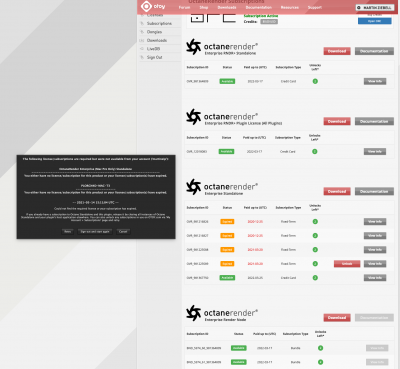

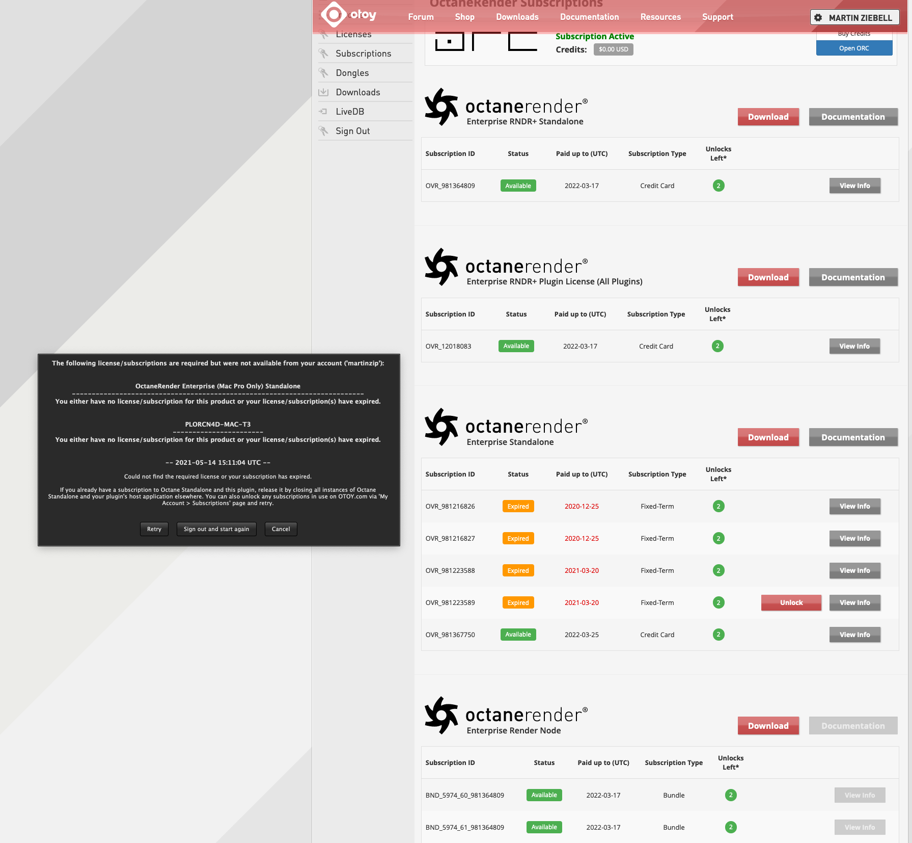

Dear Ahmet
I wanted to check the PR11 on my MacPro but find a message, that there is not the appropriate license... which is not the case, as you can see on my screenshot.
What should I do to make PR11 work?? PR8 works with no problem on the same machine...
kind regards
Martin
