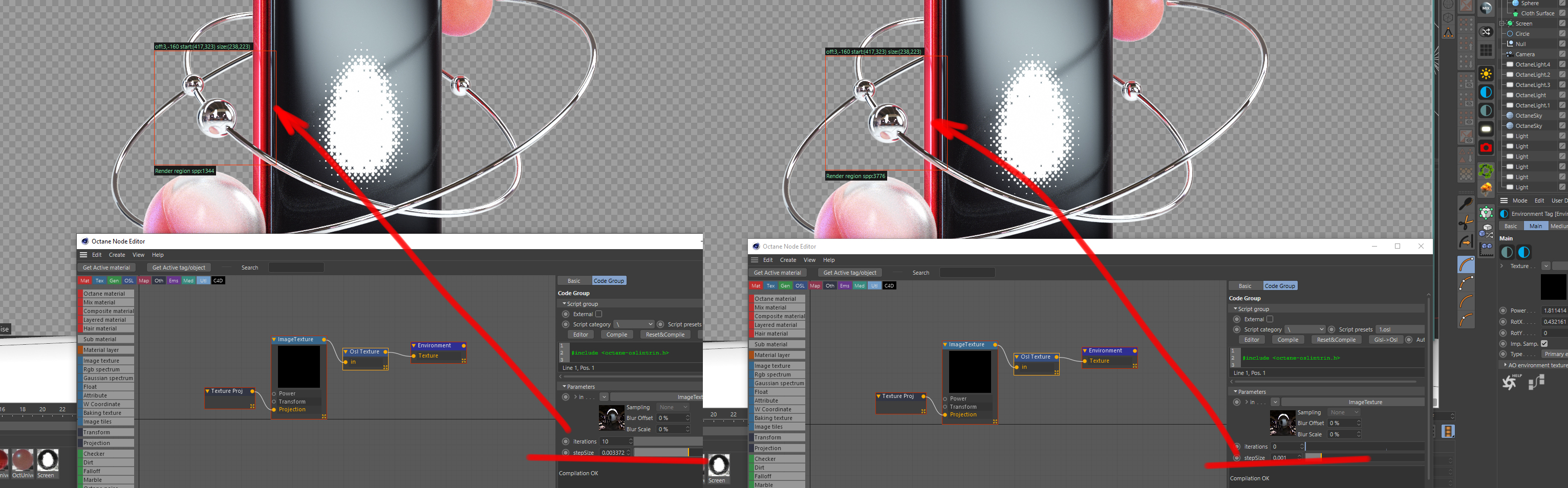

Ahmet, hi, please tell, OSL blur is broken in this build?
Setting strength of env. blur 0 to 10 give same result. No difference in reflections.

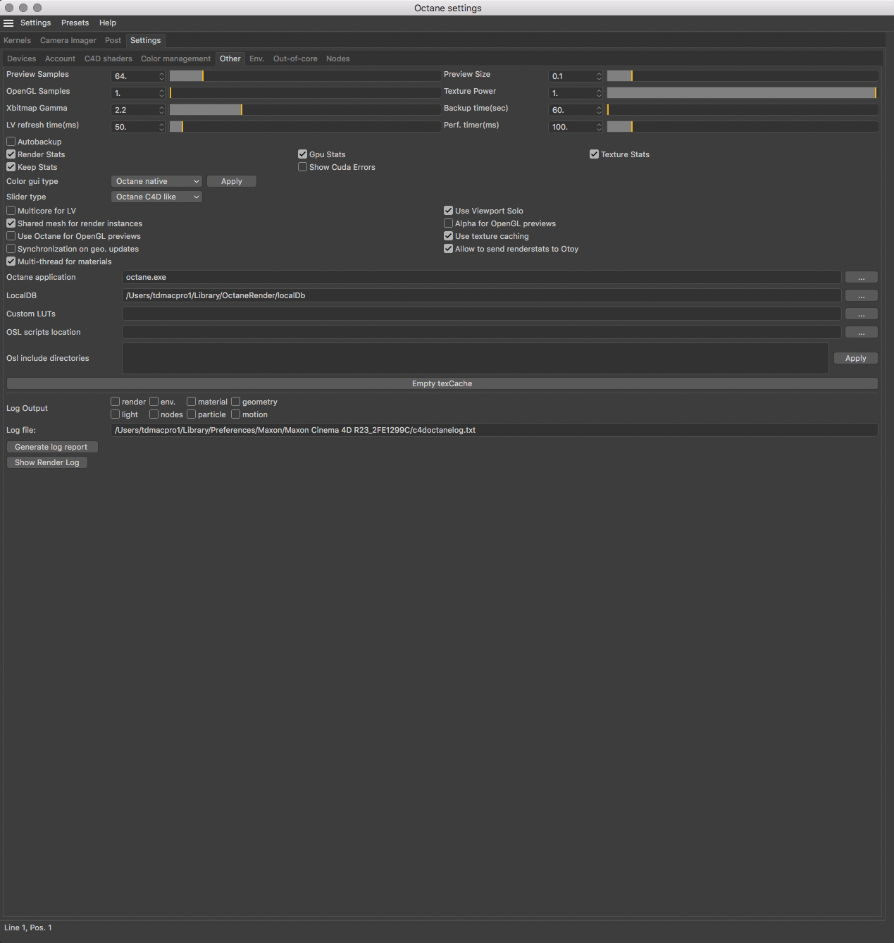

Torquee
Posts: 14
Joined: Thu Apr 04, 2019 3:41 pm
aoktar wrote:
Torquee wrote:Hi there, just wanted to send a bunch of love to the Otoy team and Aoktar! :D Installed latests 2020.2.3-R3 Octane for cinema 4D in the weekend and… No crashes whatsoever since! Wow! I have found love for Octane again :) Thank you thank you thank you! It used to crash ten times per day. A part from heavy lagging after some time in live view it is now really fun to work with!
Aiming for a for the perfect experience I’d like to hear If anyone else is using Mac Pro’s 5,1 with Nvidia/Cuda setup fluently, I’d be interested to hear if you found a solution avoiding this lag :)
The actual workstation setup: Mac Pro 5,1 (12 core), 48Gb RAM, NVMe SSD 970 EVO 1TB as cache + standard SSD’s with the applications, GPU: NVIDIA TITAN Xp (plus sometimes GTX 980 and 780 for Titan working 100% on renderings). OSX High Sierra 10.13.6, CUDA Driver Version: 418.163, NVIDIA Web Driver: 387.10.10.10.40.140. But having worked with loads of different versions previously, it has always lagged. Might migrate to Octane X and AMD solution further up. Anyone using them in the Mac Pro 5,1 with great success?
We never loose the love for that but glad to hear that! Thanks!
Using egpu that can cause lags, just estimating. Also try to disable opengl previews for testing. It's always a reason for lags if you use heavy images
Cheers Aoktar and for tips! Not using egpu though. Only place I find OpenGL settings is in octane settings (it's removed from Cinema 4D in R23 Mac version what I understand). Is this where you refer to, in Settings/Other? Turned down OpenGL samples for Alpha and switched off Alpha for OpenGL previews. Or are there any other settings I need to know of that can cause the lagging?
Settings Other OpenGL
