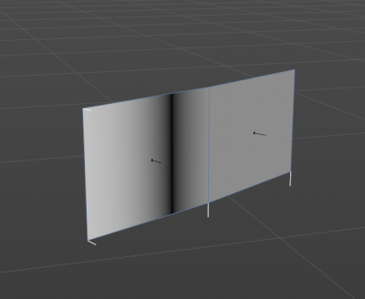

linograndiotoy wrote:Hi,
It looks like we may have a problem wit objects whose normals have been edited.
Load the scene and rotate the view. You'll notice the shading will not be constant as defined by the normal editing.
This happens in previous versions as well.
I've used the Toon Material so to make the fact more evident.
The vertex normals are coplanar to the polygon surface, i.e. are invalid. In those cases a filter comes into play that tries to fix artifacts caused by smooth normals that diverge too much from the face normal and are viewed from glancing angles. This filter takes the viewing angle into account and makes the "fixed" smooth/shading normals view dependent. In your case the vertex normals are so far off that there is nothing that can be done anyway.
-> It's not a bug but a feature.

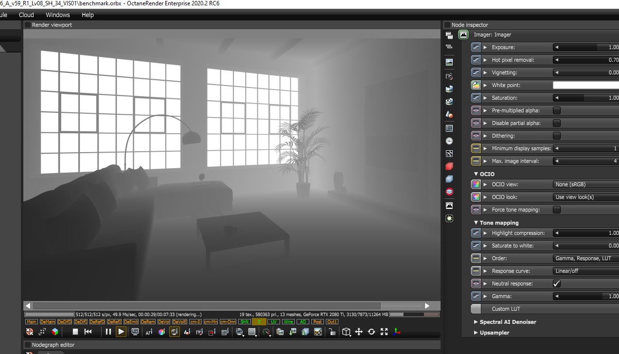

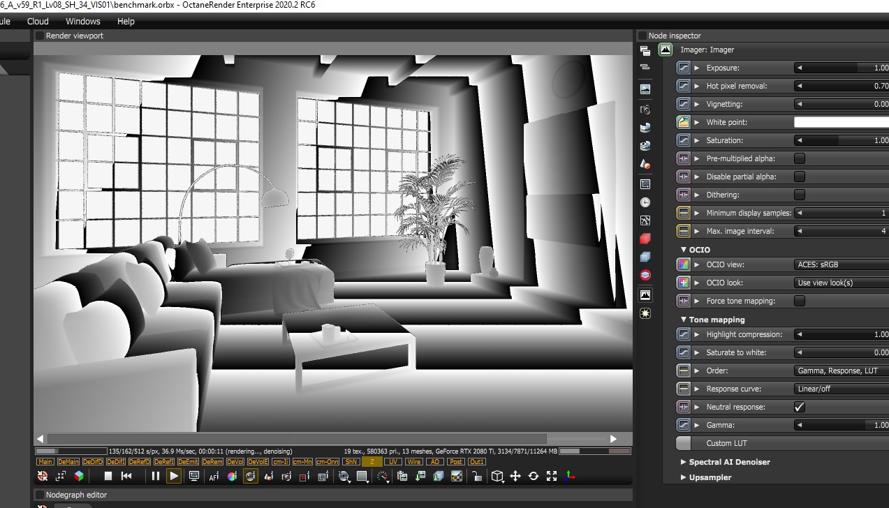

Hi Guys,
I find a bug, everything is working for me with ACES but when I render the output with all passes all the passes is good except the Depth pass is rendering weird when ACES is activated. the exr as linear is not exporting also properly. All other passes looks like is all good color passes
but on the info channel should be ignored by aces I think specially when we export linear :)
ACES ON
ACES ON
ACES OFF
ACES OFF
As a 3d artist, I have to say I don't like this feature that much, and I would love to be able to turn it off if possible. Defining custom normals may be really important for NPR and game assets, and those should stay consistent from any camera angle.
I made a video showing how other renders (in order LightWave and Cycles, but it really works fine in any other render I tested) can correctly manage this kind of situation:
https://youtu.be/ijWK1dNmKvo

Jolbertoquini wrote:Hi Guys,
Thanks for the report. The issue with the weird stripes in the depth pass will be fixed in the next build.
I'm not quite sure about the EXR export problem though - that seems to work fine. What problem are you seeing? If it's that the entire image looks white, that's just because the depths are likely to be greater than 1.0 - they're there, you just can't see them in a normal viewer unless you reduce the exposure.
no export is working sorry my bad I didn't express properly haha is the info passes normal, uv , depth, position they have issues
