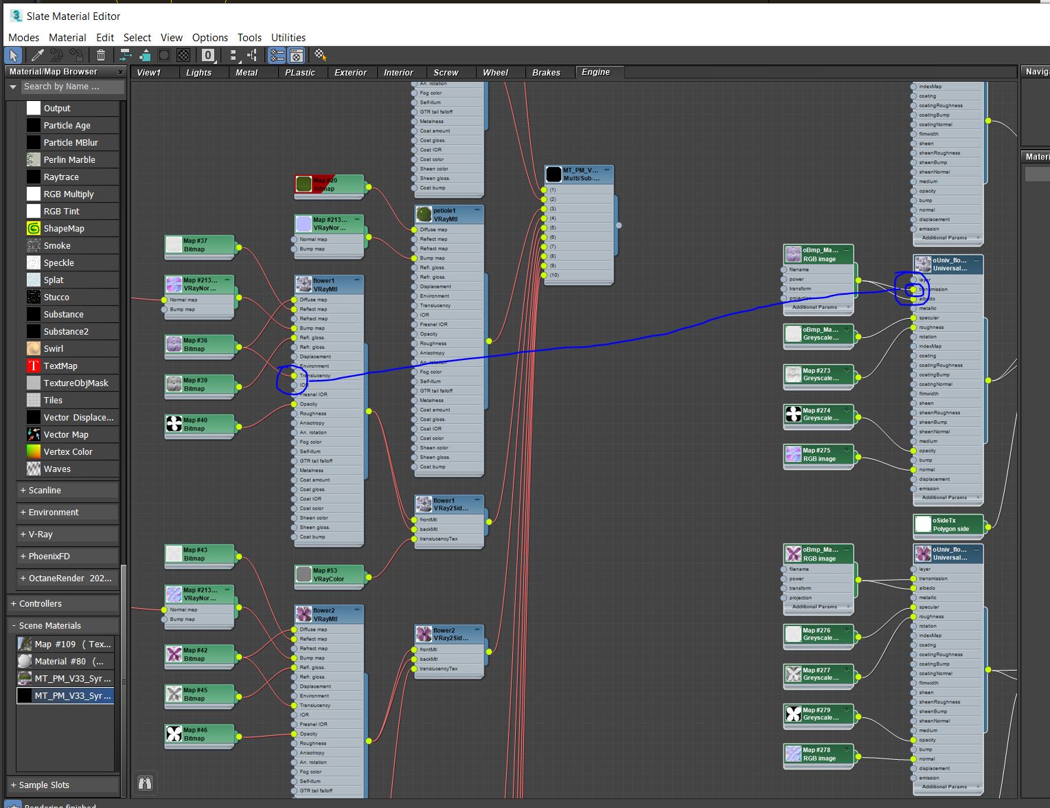

nick73 wrote:Hi Paride,
Converting materials has been broken in 10.19. Previous release did convert normal map and I should only toggle it from bump node to normal. Now It's missing at all. I guess I preferred as it was before. Another thing, I believe the script should convert transparency map into transmission node with a gamma of 2.2. I am using this all the time with good results.
Thank You.
Hi Nick73,
yes, the normal/bump conversion is a know issue.
About vray trasparency map, it is the opacity map in Octane, not transmission.
Regards
Paride
nick73
Posts: 29
Joined: Sun Jun 11, 2017 2:05 pm
Thank You.
Hi Nick73,
Regards
Paride
Hi Paride,
My fault that was a standard material. I think Vray Translucency Map is Octane Transmission (at least this works good for me).
Kind Regards
Nick

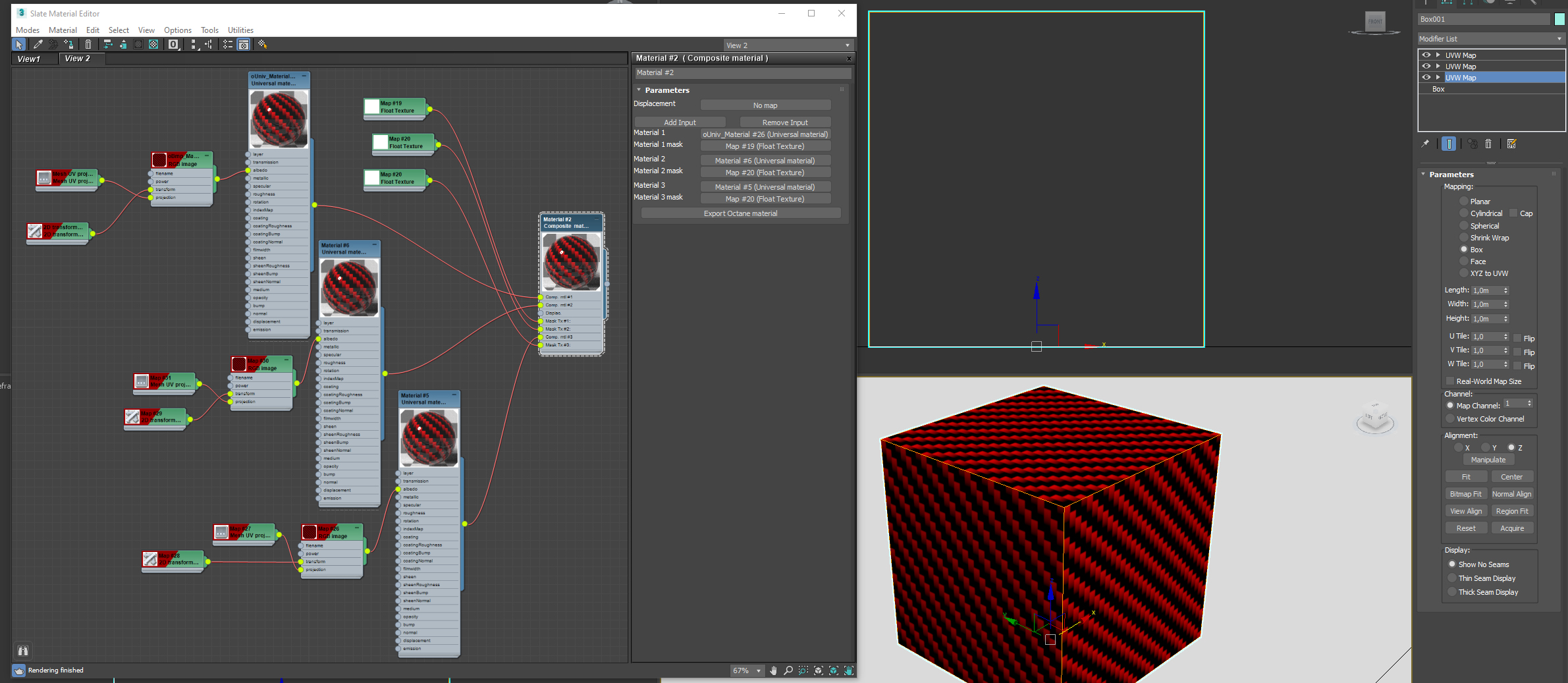

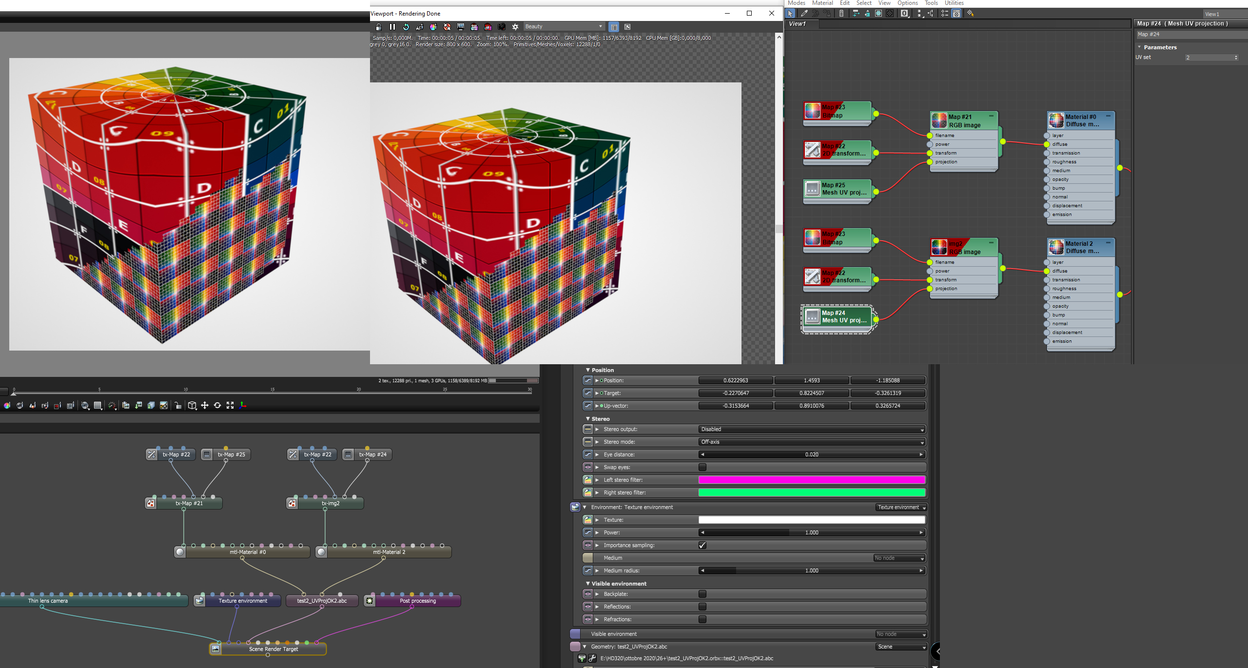

paride4331 wrote:Hi Nick73,
It seems to work, could you share your issued scene?
Regards
Paride
In this case the bug might be in the exporter...
Thank you!!
Test_Octane_UV.zip
(230.06 KiB) Downloaded 288 times
paride4331
Posts: 3989
Hi Nick73,
exporting to .orbx, SA gets the Mesh Uv projection active only; I guess it depends on SDK.
You could try using a composite material node.
Regards
Paride
composite.zip
(316.37 KiB) Downloaded 253 times
