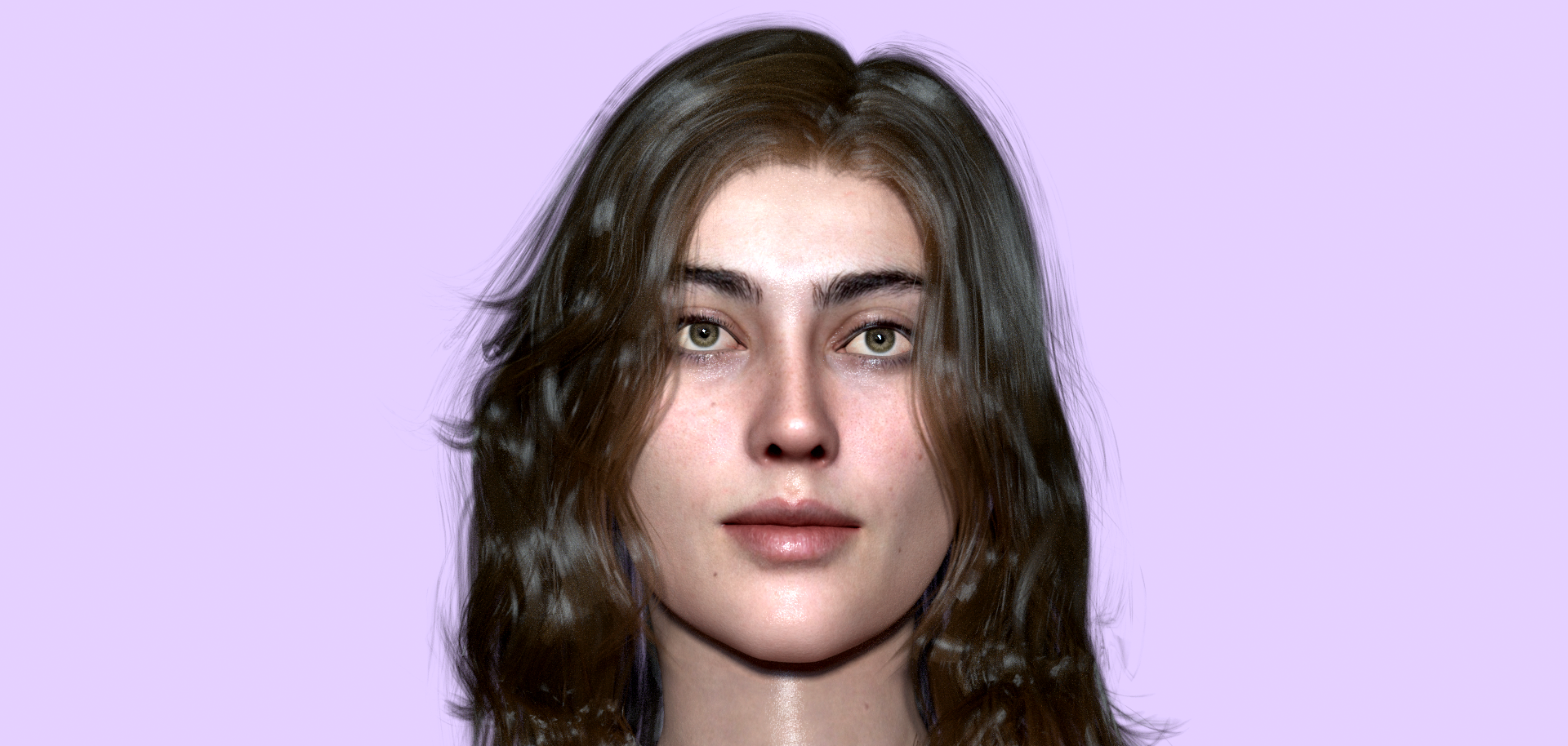

Can we see some examples of the new randomization pins on the hair material?
I was expecting random strands of hair to change color, but Im just getting a single random color on all strands.
