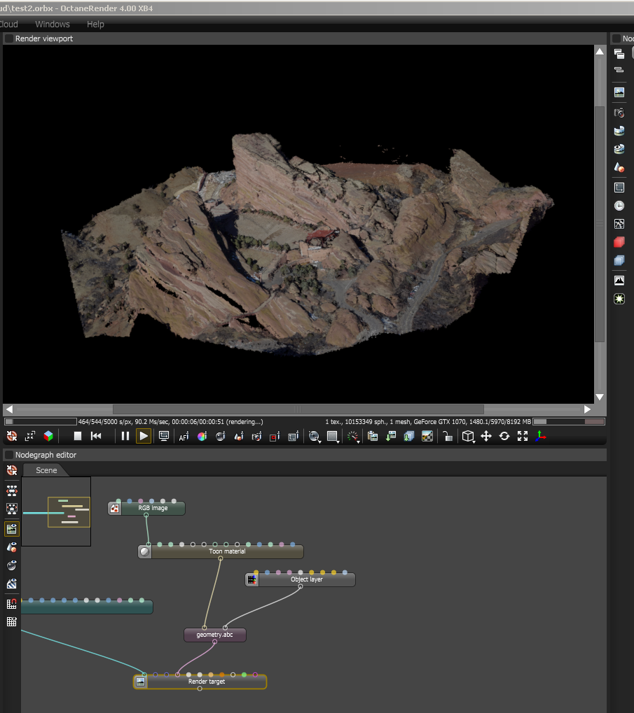

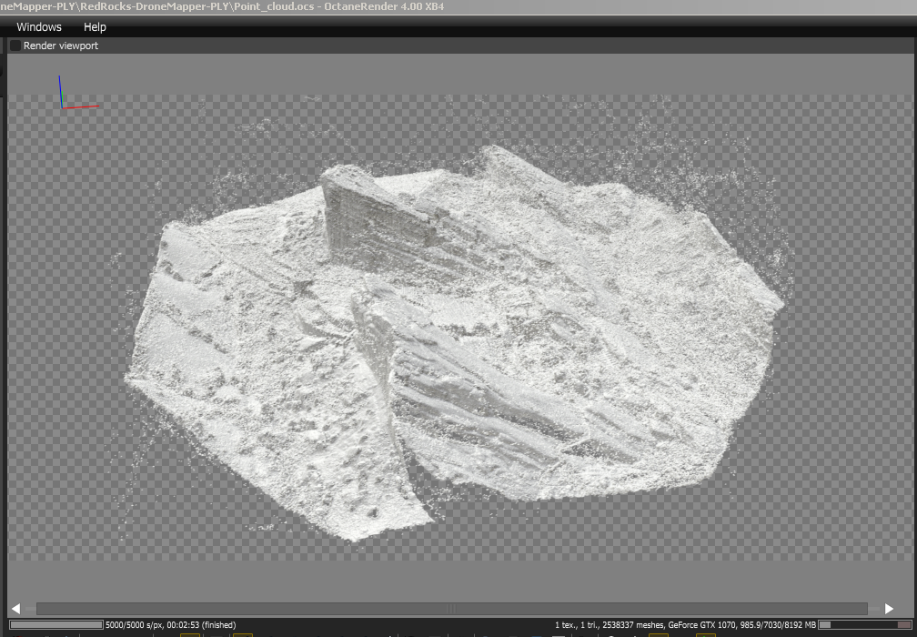

Hi Issa,Issa wrote:I am making some sort of point cloud rendering in octane using scatter node.
I can easily load over 10 millions points in octane 3 but no way for v 4, even with out-of-core turned on. Please tell me that will be fixed.
The dream for v4 may be to be able to handel 1 billion instance or closer.
I deal with billion of photogrametric points from time to time at work.
I took the model from this site for my test:
https://dronemapper.com/sample_data/
This is interesting, and looking really good did you use the ply with the vertex color and generate the scatter on Houdini? or other way?

Hi Jolbertoquini,Jolbertoquini wrote:This is interesting, and looking really good did you use the ply with the vertex color and generate the scatter on Houdini? or other way?
Yes this is exactly my workflow for Houdini. You can also wrote a script to directly translate the .ply, What I've done for my company

Thanks a lot Issa.Issa wrote:Hi Jolbertoquini,Jolbertoquini wrote:This is interesting, and looking really good did you use the ply with the vertex color and generate the scatter on Houdini? or other way?
thank you : )
Awesome I also did meshlab save as xyz file change to .txt and is working well only trying to find how to put the color but you totally right Houdini save the day there hehehe!

Pretty ! Follow this to get the color in houdini:Awesome I also did meshlab save as xyz file change to .txt and is working well only trying to find how to put the color but you totally right Houdini save the day there hehehe!
https://vimeo.com/172594655

Yes, I realize the plug does it automatic, basically not need Roahn stuff anymore also get as Alembic cache (not csv scatter) I realize is perfect and way stable for XB4 I have full PLY Pointcloud straight there really faster and stable. with the alembic cache.Issa wrote:Pretty ! Follow this to get the color in houdini:Awesome I also did meshlab save as xyz file change to .txt and is working well only trying to find how to put the color but you totally right Houdini save the day there hehehe!
Yes but we need stable .csv for octane standalone. This is pretty handy and straightforward in our workflow with scripting all the boring stuff, no more need of Houdini
