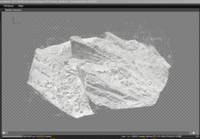

Issa wrote:I am making some sort of point cloud rendering in octane using scatter node.
I can easily load over 10 millions points in octane 3 but no way for v 4, even with out-of-core turned on. Please tell me that will be fixed.
The dream for v4 may be to be able to handel 1 billion instance or closer.
I deal with billion of photogrametric points from time to time at work.
I took the model from this site for my test:
https://dronemapper.com/sample_data/

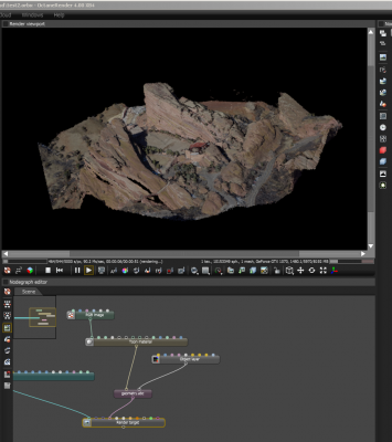

Jolbertoquini wrote:This is interesting, and looking really good did you use the ply with the vertex color and generate the scatter on Houdini? or other way?
Hi Jolbertoquini,
Yes this is exactly my workflow for Houdini. You can also wrote a script to directly translate the .ply, What I've done for my company
thank you : )
Jolbertoquini
Posts: 1067
Joined: Sun Aug 31, 2014 7:08 am
Location: London
Hi Jolbertoquini,
thank you : )
Thanks a lot Issa.
Awesome I also did meshlab save as xyz file change to .txt and is working well only trying to find how to put the color but you totally right Houdini save the day there hehehe!
Cheers,
JO
