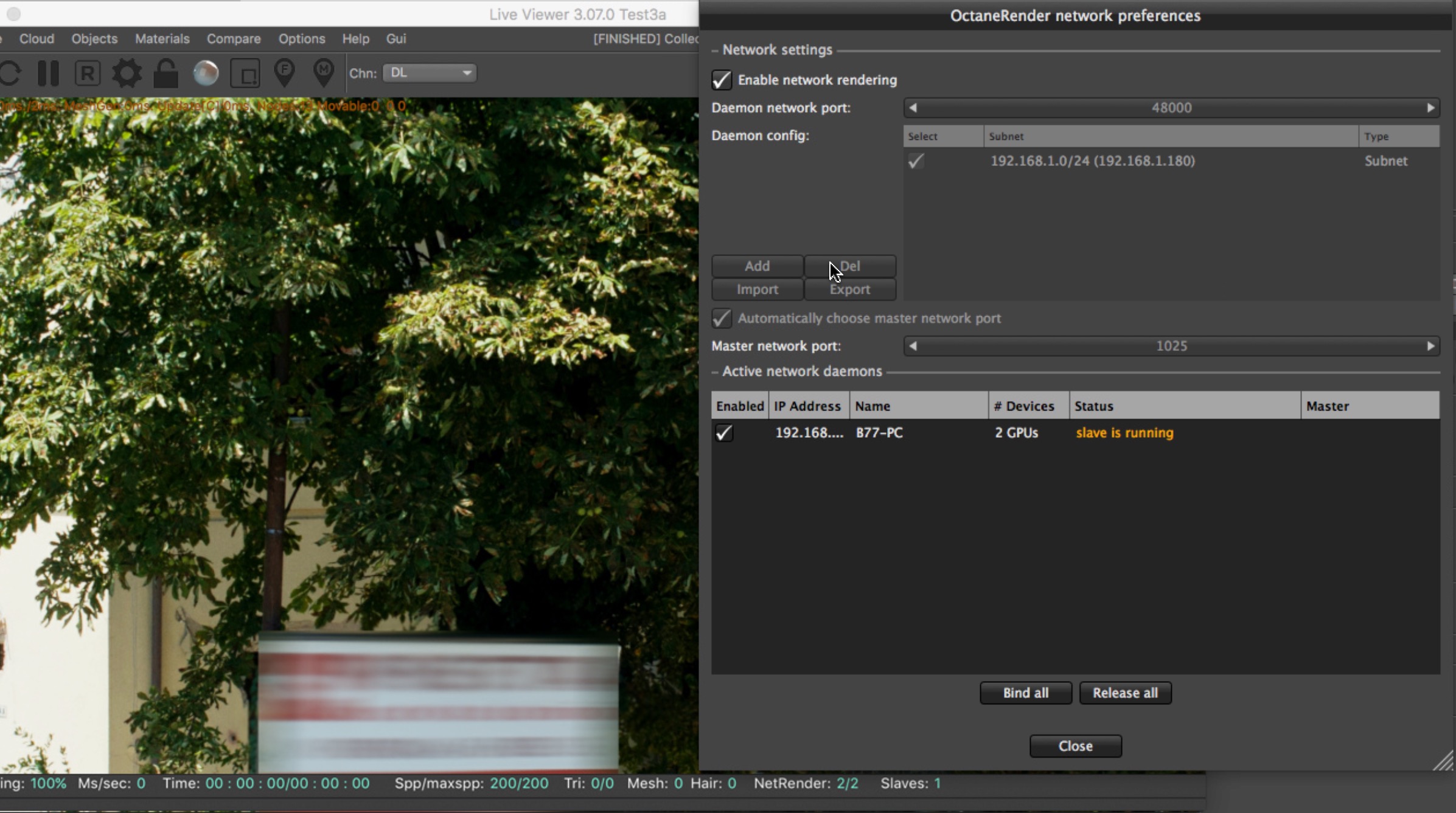

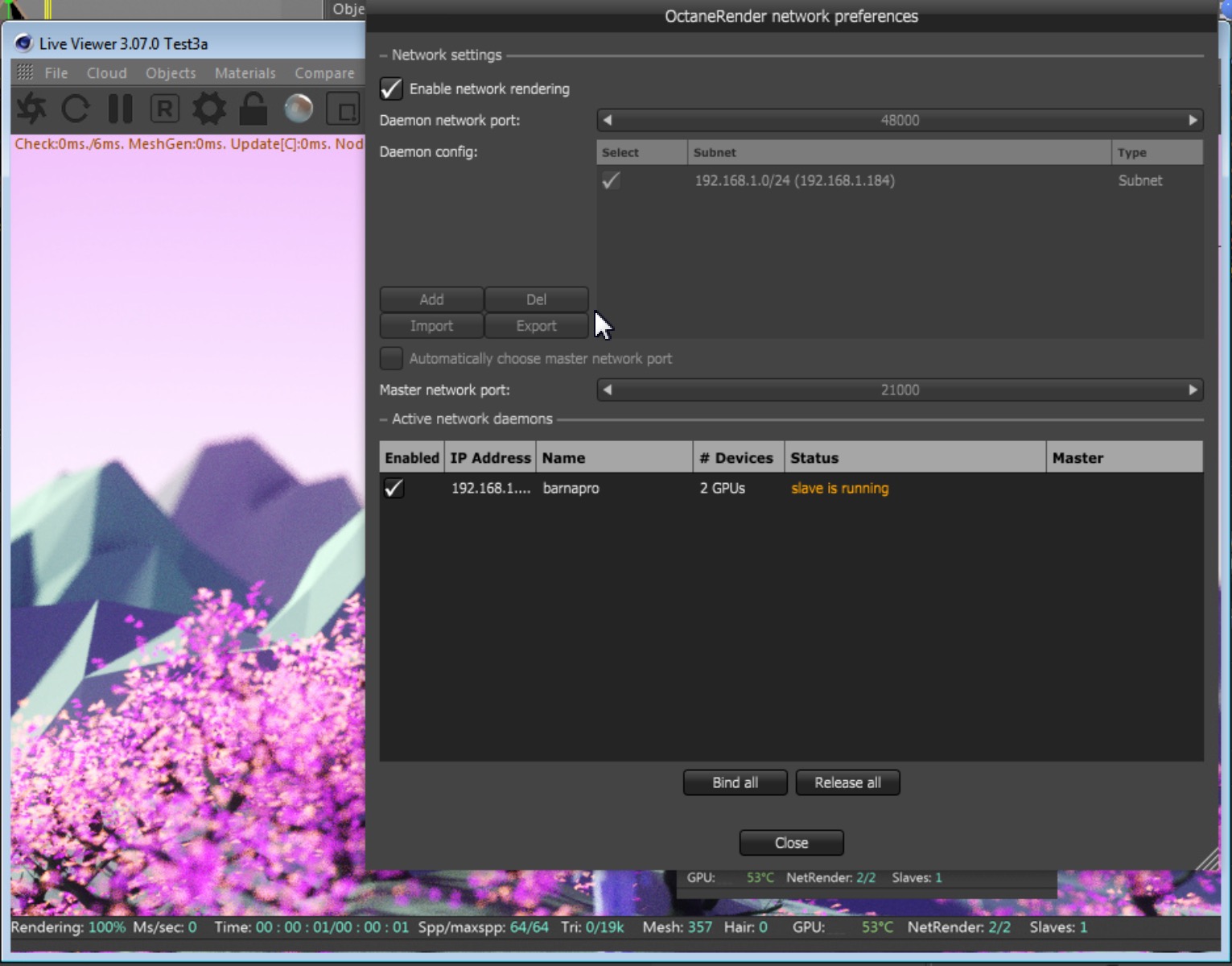

Posts: 10609
Hi BCres and useruser,
here net rendering is working as expected on both Mac and Win with 3.07 t3a:
Did you enable the Subnet in the Daemon config section?
ciao beppe
