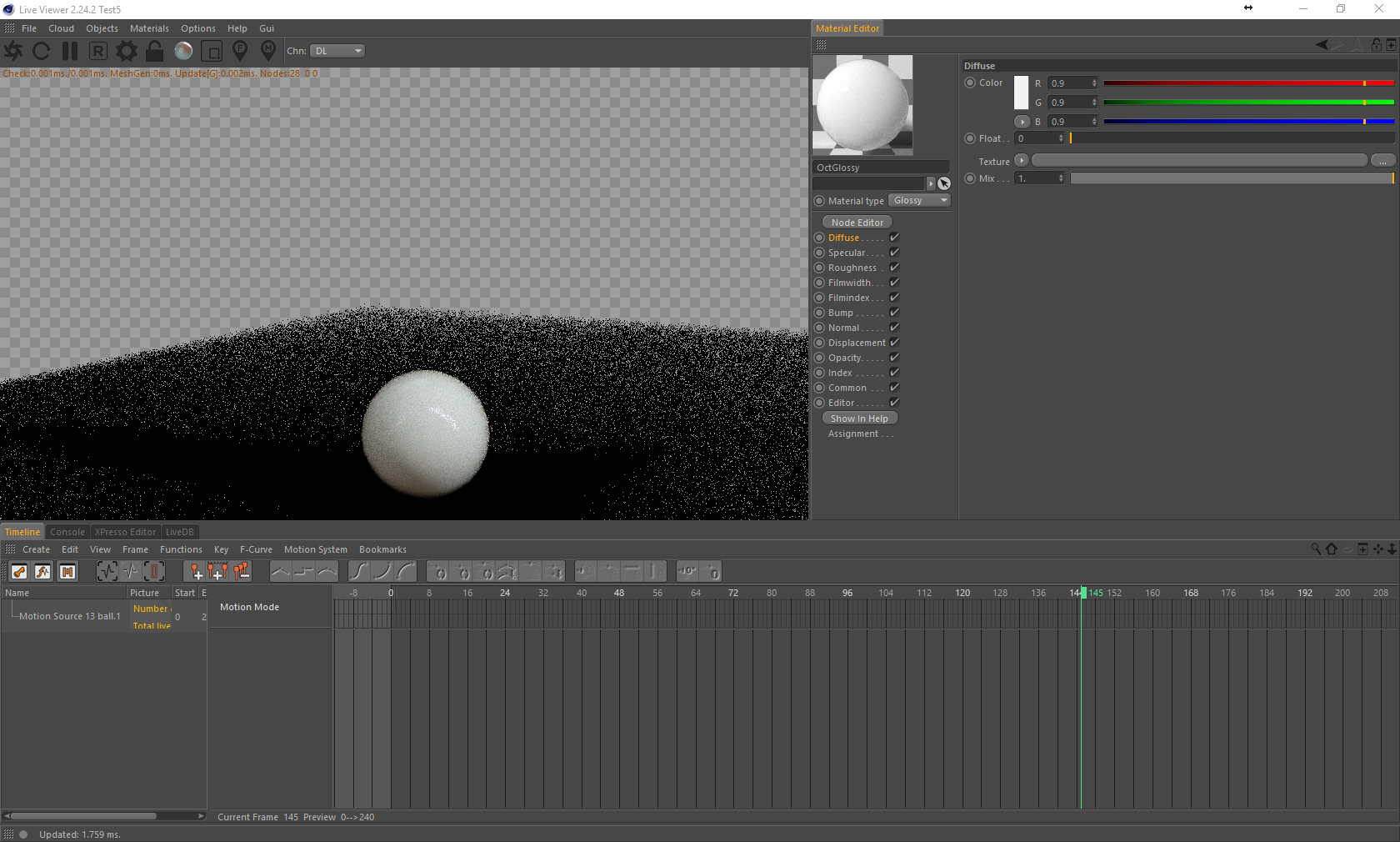

But there is a another issue i found today, regarding the the "matte" option inside the shader - scene file attached, i will explain:
This is a project i started with the prevoiuse version and it worked properly, right now when the "matte" option inside the diffuse material is on - there are some black noise weird stuff going on in the live viewer. Instead of just behave as a shadow catcher.

got you, on previous versions it behave differently.

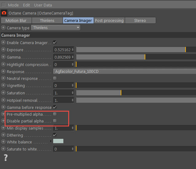

What does the "Disable partial alpha" is doing?

Simply don't select it. It's for removing thin edge effect on mattes.Yambo wrote:got you, on previous versions it behave differently.
