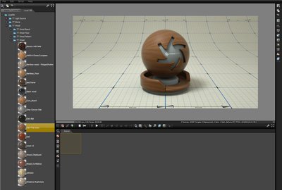

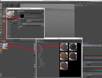

sodapop66
Posts: 33
Joined: Sat Jun 01, 2013 11:20 am
Location: Nice, France
Thanks for sharing your last Octane C4D 2.16.1, i have no longer crash with LiveDB and C4D, really nice :-)
however i have lot of missing textures with the personnal materials saved both in the User LiveDB folder and LocalDB folder
i' have also missing textures with some otoy materials moved in my personnal user folder
Several materials saved from the localDB do not appear in the C4D materials list. :cry:
i have no missing textures with octane 2.16 stand alone with shared Local DB
thanks in advance for your help

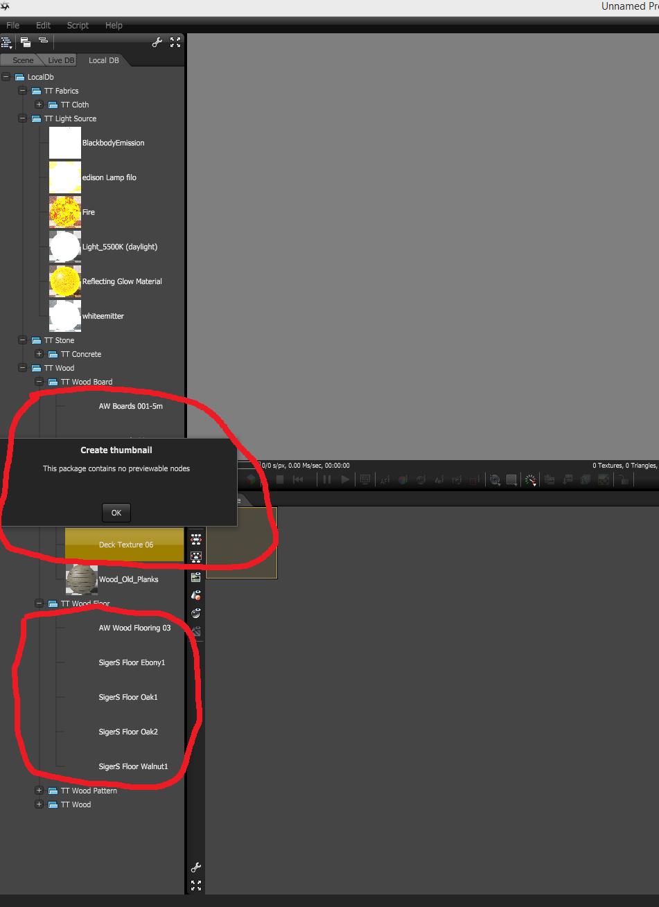

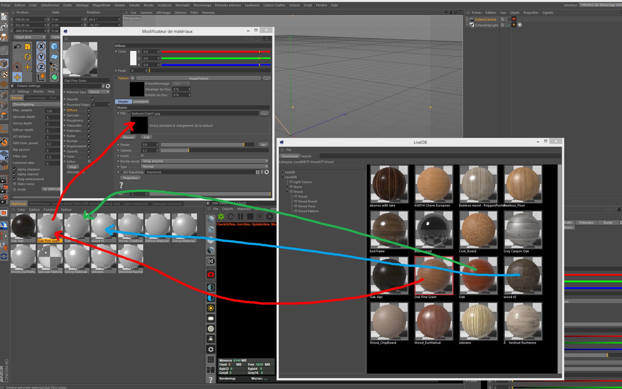

sodapop66
Posts: 33
Hi Aoktar
i've checked new test2 but it's worse than before :ugeek:
lot of missing textures from localdB and UserDB
see screenshot attachments
i've no problems with octane stand alone
Thierry Tutin
Nice, France

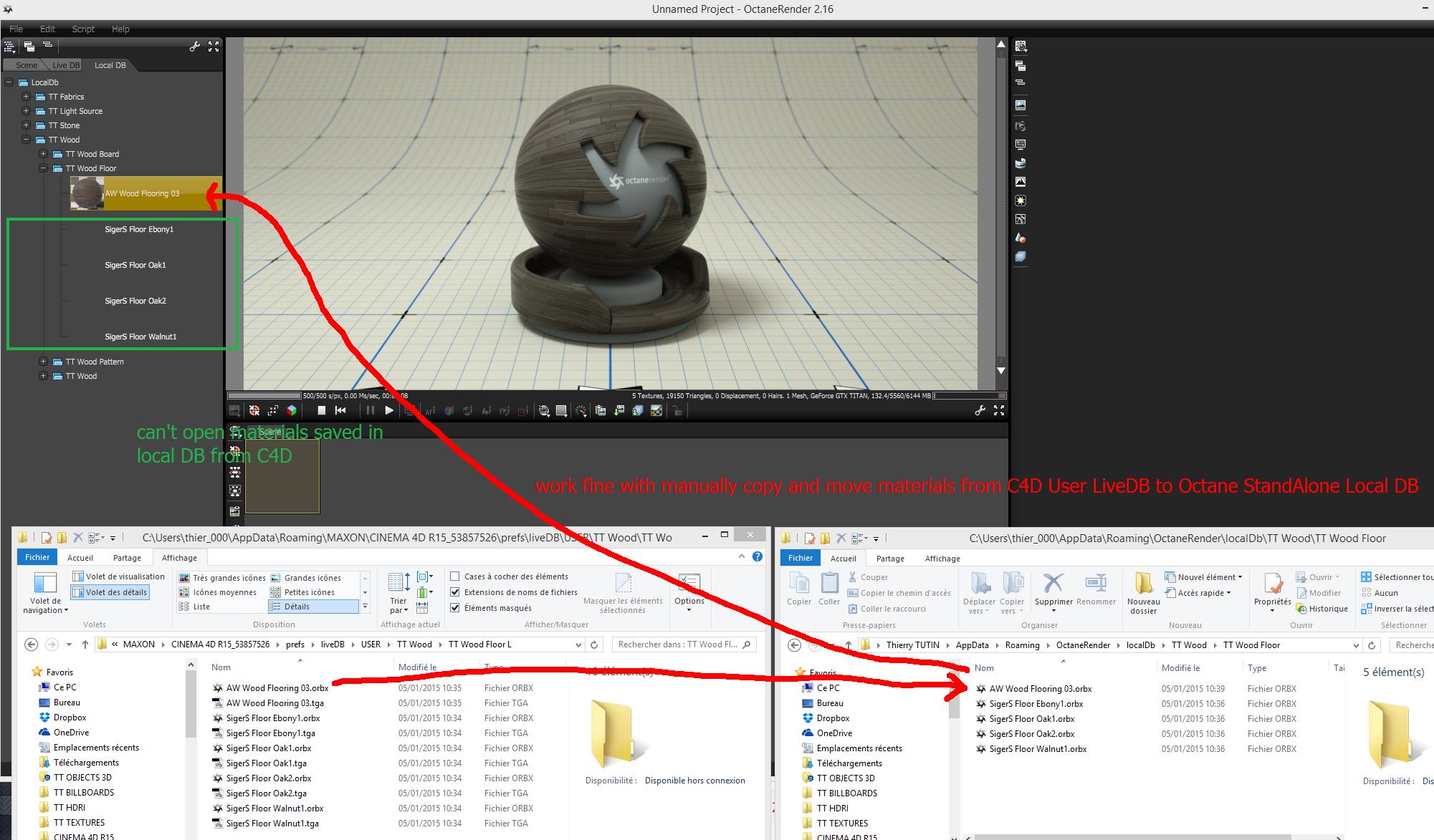

sodapop66
Posts: 33
new problem with materials directly saved from C4D in LocalDB, error in Octane Stand Alone
Work fine with materials saved directly from C4D in User LiveDb and manually copy and move in LocalDB folder.
Thierry Tutin

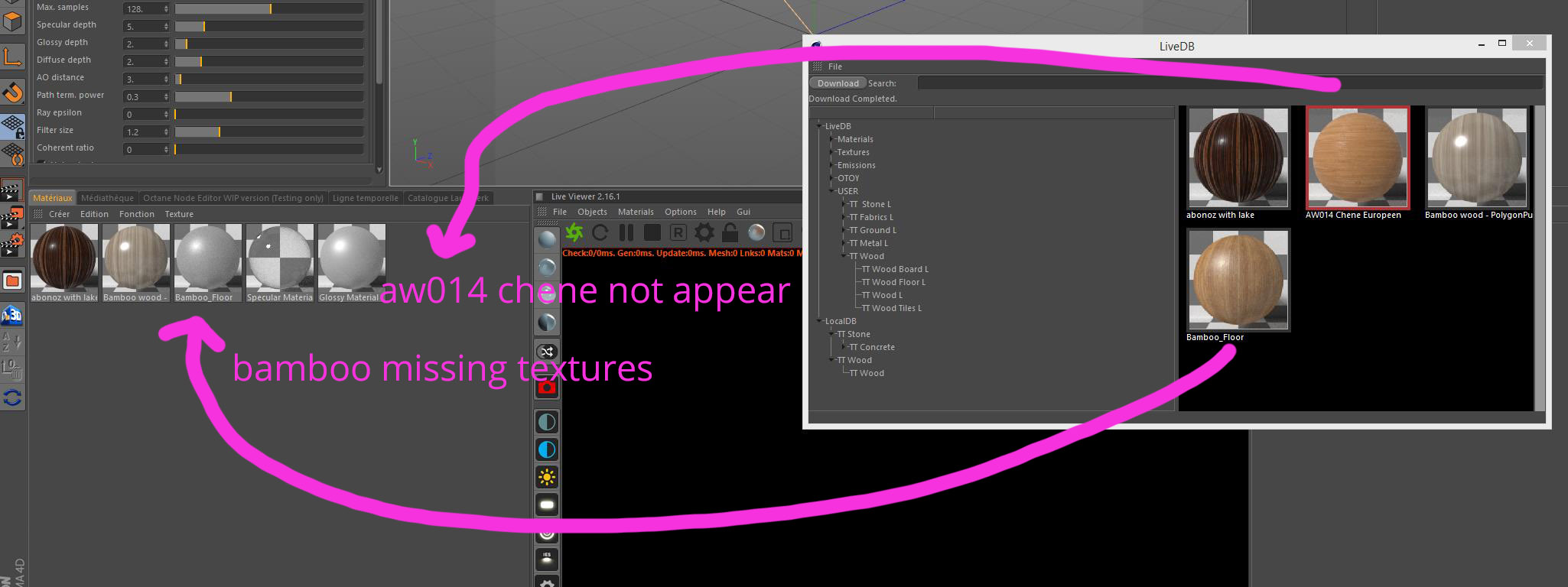

sodapop66
Posts: 33
unfortunately, new opening in c4d and same material lost, missing texture again
Thierry Tutin
