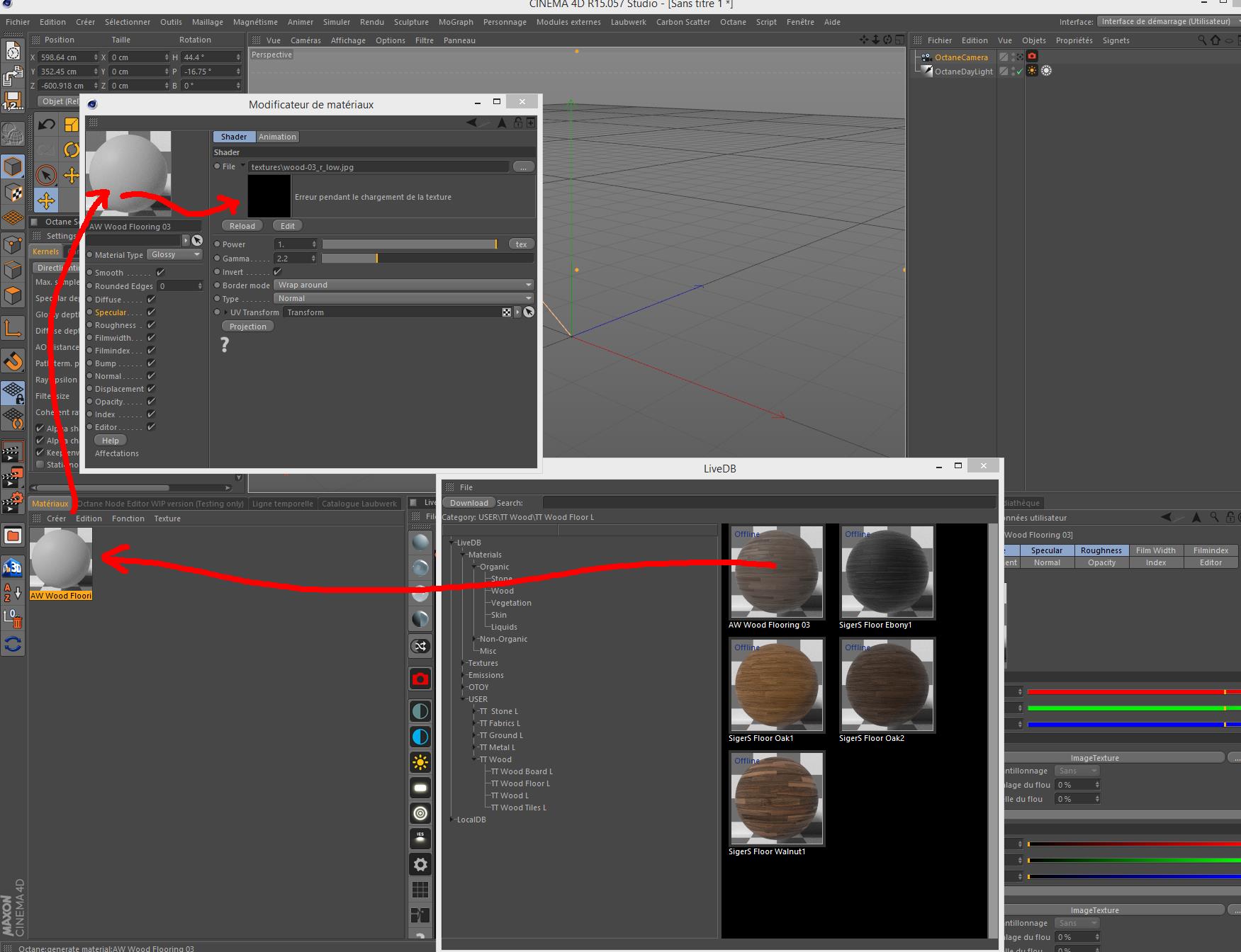

Thanks for sharing your last Octane C4D 2.16.1, i have no longer crash with LiveDB and C4D, really nice
however i have lot of missing textures with the personnal materials saved both in the User LiveDB folder and LocalDB folder
i' have also missing textures with some otoy materials moved in my personnal user folder
Several materials saved from the localDB do not appear in the C4D materials list.
i have no missing textures with octane 2.16 stand alone with shared Local DB
thanks in advance for your help

ok, i'll hopefully fix it today. Sorry for confusionsodapop66 wrote:Thanks for sharing your last Octane C4D 2.16.1, i have no longer crash with LiveDB and C4D, really nice
Several materials saved from the localDB do not appear in the C4D materials list.![]()
Download links has been updated with a bug fix version(2.16.1 test2). Please check it.
