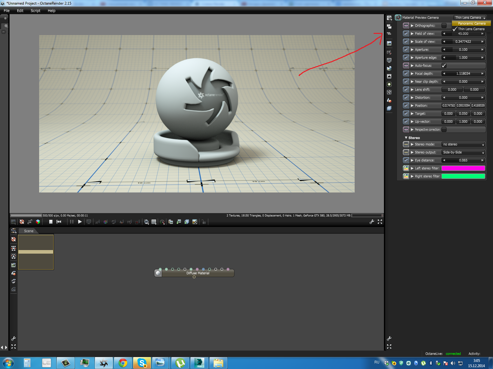

Elvissuperstar007 wrote:panoramic camera not working
Can you post a screenshot because it's working fine on my machine.

The material preview camera can't be deleted and therefor can't be replaced by a panoramic camera. That's by design. But in a normal scene or even in the regular preview render target you can replace the camera node by a different one.

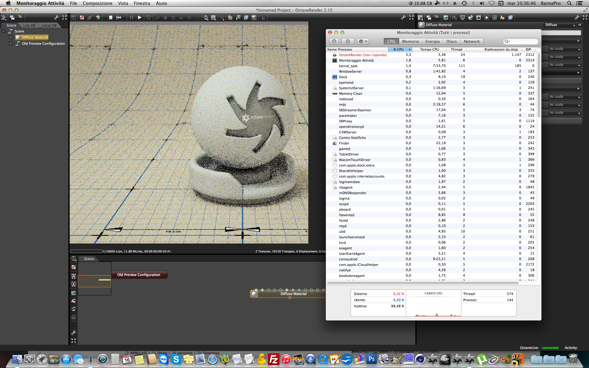

a couple of bugs in the osx version, at least on my system:
if you try to resize any window, octane stops to respond.
if you create a new material node, as soon as the material ball scene is loaded, octane stops to respond.
