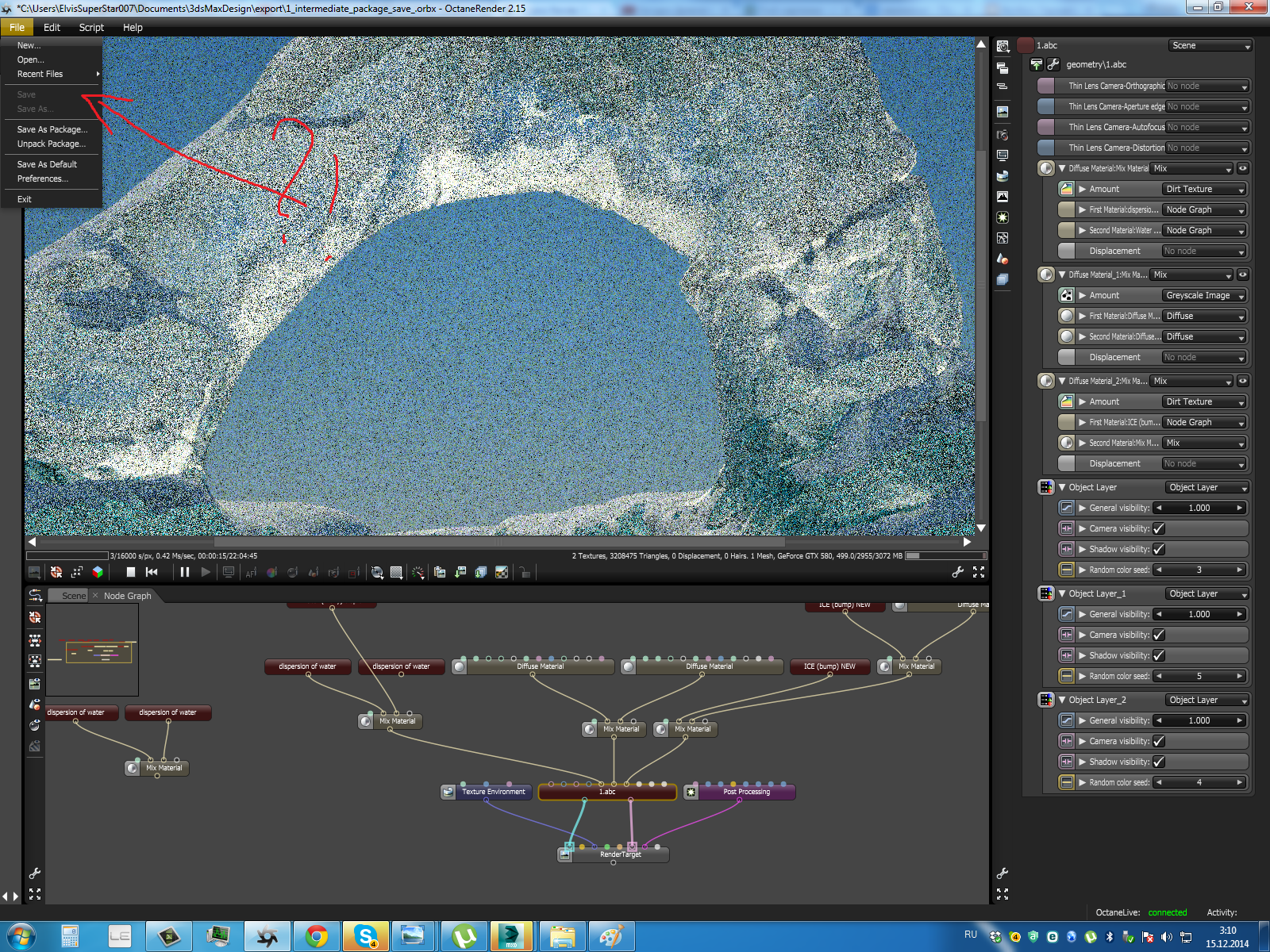

Elvissuperstar007 wrote:panoramic camera not working
Can you post a screenshot because it's working fine on my machine.
cheers,
Thomas

Packages (.ORBX) need to be unpacked first, before you can save them via File -> Save... . Packages are for moving projects around, not for working on them. If you accidentally made a change in a package, before you unpacked it, you can save it as a new package, then load the new package and unpack it.
The material preview camera can't be deleted and therefor can't be replaced by a panoramic camera. That's by design. But in a normal scene or even in the regular preview render target you can replace the camera node by a different one.
