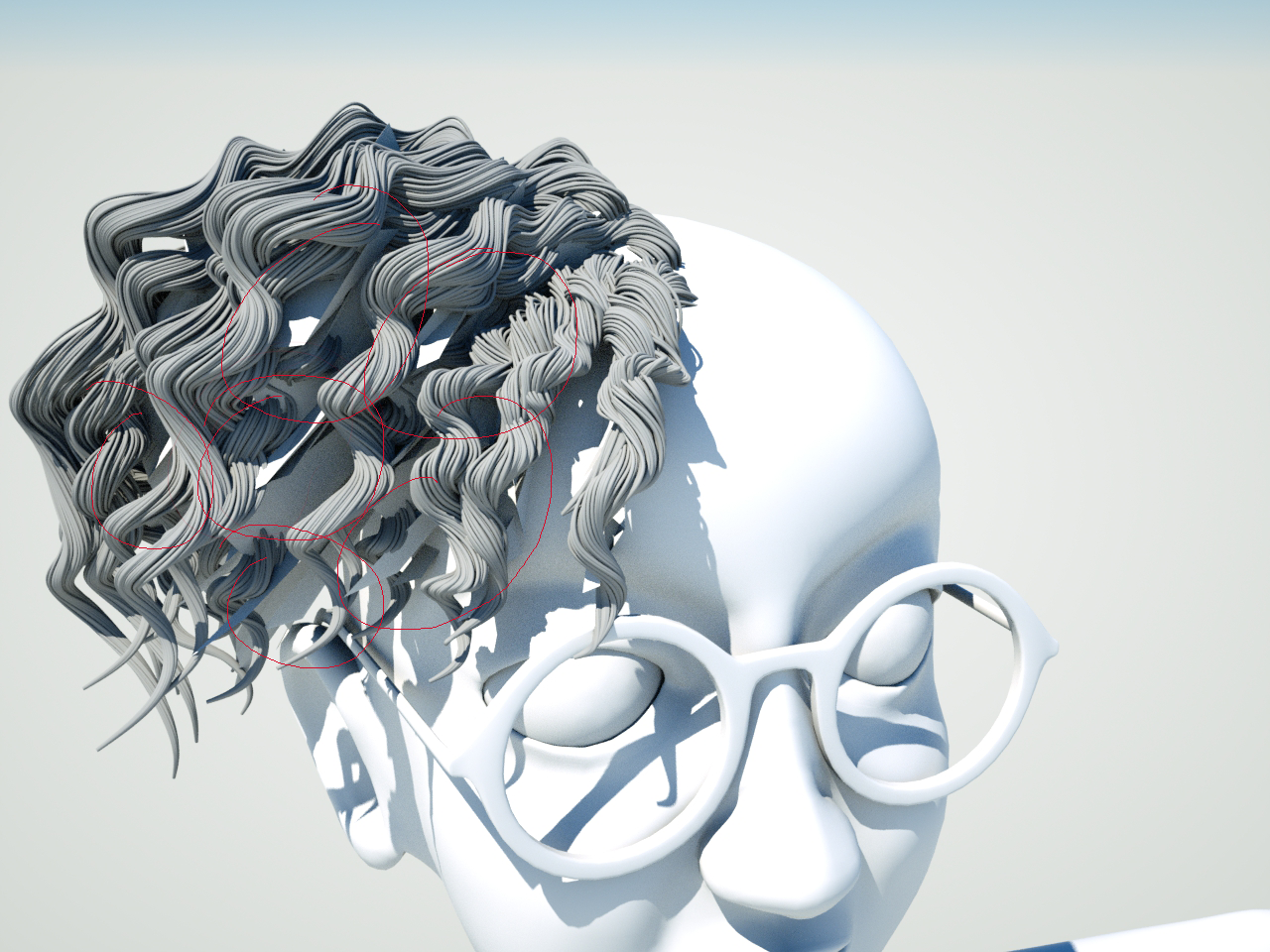

Hello Juanjo I need your help,
First off thanks so much for all you've done for the lightwave octane integration. Second, I need help I am having issues with my Fiberfx render. I am using guides to drive fiberfx hair style and i get these weird polygons showing up throughout the fiberfx flow as a render it in octane. Please advise thanks!
fiberfx polygon issues

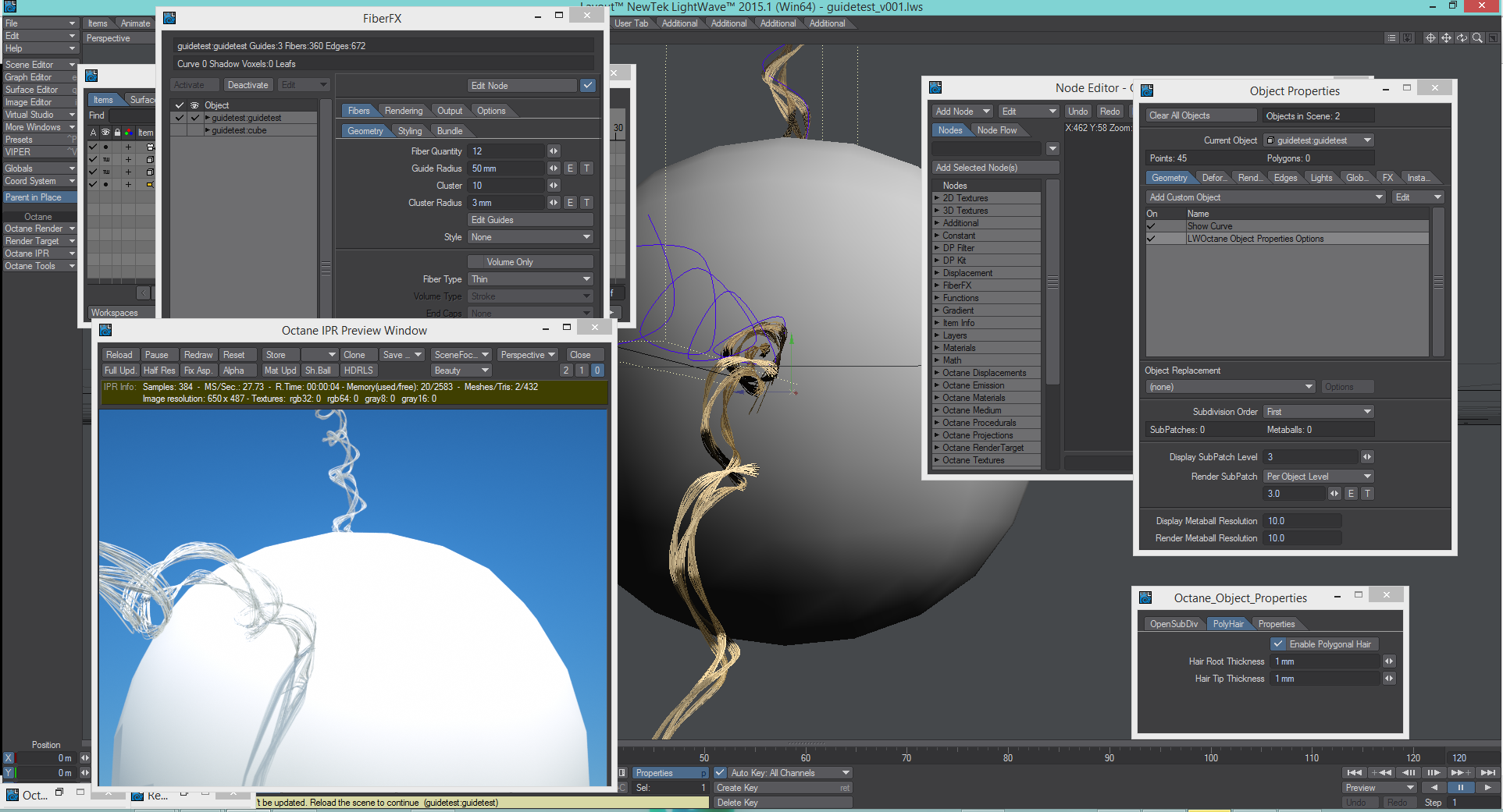

EUREKA
I do not know if this is the standard process but i figured out how to fix it, apparently when using guides for fiberfx, the octaneobject property setting on the guides have to be activated aswell ( like if you were using 2 point poly chains for fibermesh in the pre-lightwave 2015 hair process) once both are activated the octane fiberfx with guides process works.
fiberfx fix
fiberfx fix
