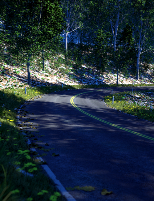

Tugpsx
Posts: 1155
Location: Chicago, IL

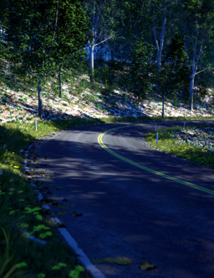

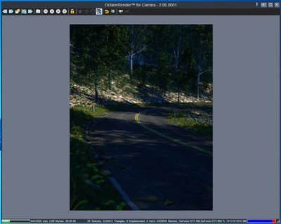

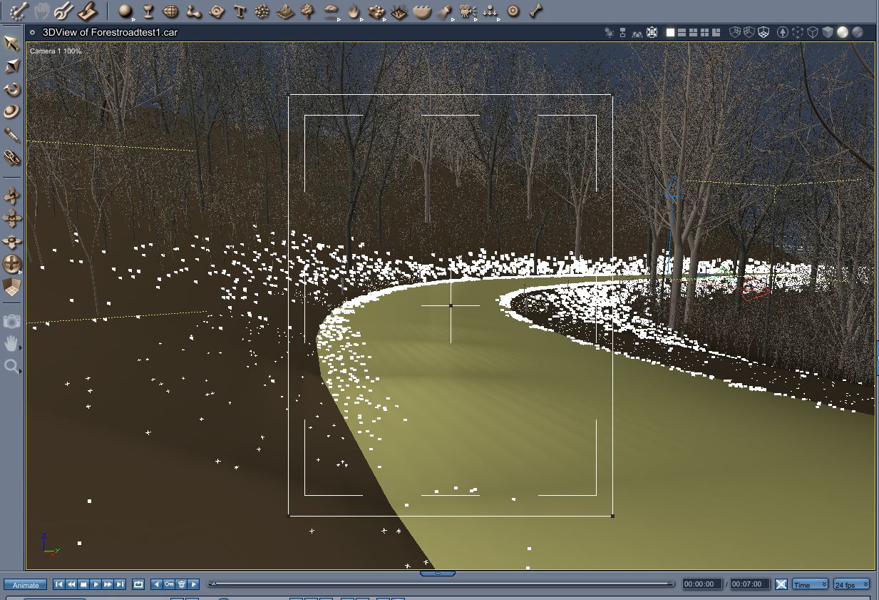

Flattening the trees does allow the Forest Drive scene to be loaded on a 660Ti 3G card.
Forest Drive in Carrara
Forest in OVP
Forest in OVP
Forest Drive in Octane 4 Carrara

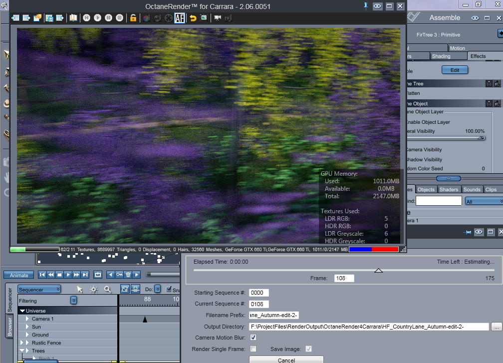

orion_uk
Posts: 713
Joined: Tue Oct 25, 2011 2:56 pm

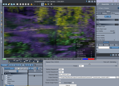

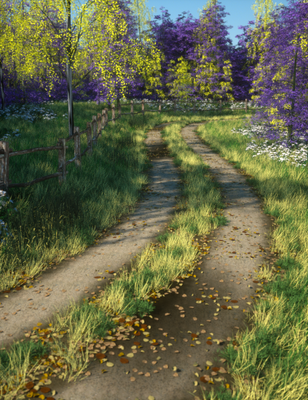

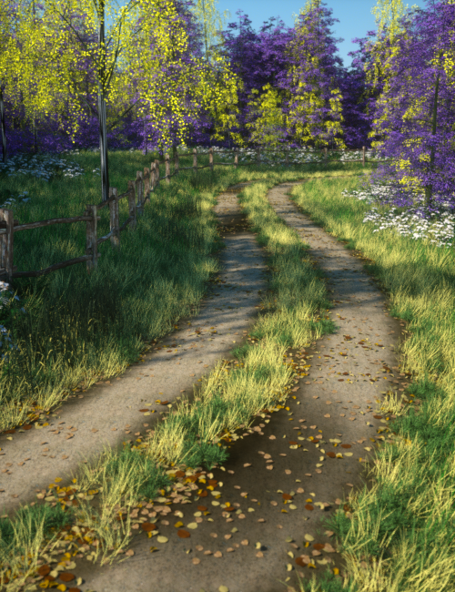

HF CountryLane test, I am currently running a camera blur anim sequence and its looking great so far :D
Maxed out 2x1 660Ti cards..(2Gb each)..
200 MaxSamples..
The trick to loading this scene is by unflattening the fir trees. The 'leaves' of a fir tree consists of hundreds of needles that have to be scattered over the tree. Flattening a fir tree (as is) makes the mesh too big to fit into GPU memory. Simply select each fir tree (there are only 3 in this scene), go to the Effects tab and uncheck the Flatten option. Needless to say that you cannot scatter the fir tree but, fortunately, this scene does not try to.
Thanks for the tips Sighman ;)
