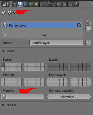

Tonight I was looking for clay render mode with the plug-in and had no luck finding it. Is there a clay render mode for plug-in?

You can use the material override function.

Saramary wrote:Hi Ephdot,
Thank you Saramary. I was sure that it was in there somewhere and I was missing it.

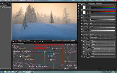

@Jimstar : Hi, It is easy to parent an object (typically a sphere with normals Inside for fog/Scattering Medium) Inside Octane Standalone using ascendent links and a Position node shared by the camera and the sphere, but is there a way to extract transform data from the camera of an Alembic node ?
:arrow: Or maybe, would it be possible to add an output Transform pin for the camera when exporting the Alembic node ?
Below, just to remember, how to parent the sphere to a regular camera :
