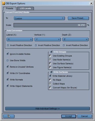

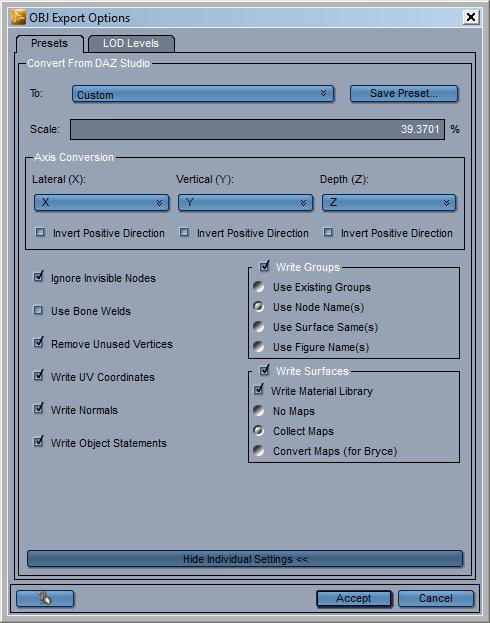

Not sure if anyone is interested, but these settings work very well for DAZStudio exported objects.
I find it best to collect the materials in a local directory, but you can leave them in their origiinal directory and the .mtl file will link to the materials.
If the materials are stored in a complex directory structure then it's best to use the "Collect Maps" option and it will make a MAPS folder with the textures.
DAZStudio export settings

thanks, that's very handy :)
can we put it in our PDF manual ?

Sure, not a problem.

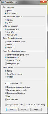

For coming out of Rhino, clearing "Export mesh vertex normals" seems to make happy OBJs. This dialog is from Rhino 5 beta, Rhino 4 does not have this as an OBJ export option.

SamPage wrote:For coming out of Rhino, clearing "Export mesh vertex normals" seems to make happy OBJs. This dialog is from Rhino 5 beta, Rhino 4 does not have this as an OBJ export option.
2.2 will allow you to use export vertex normals and have much better quality rendering.

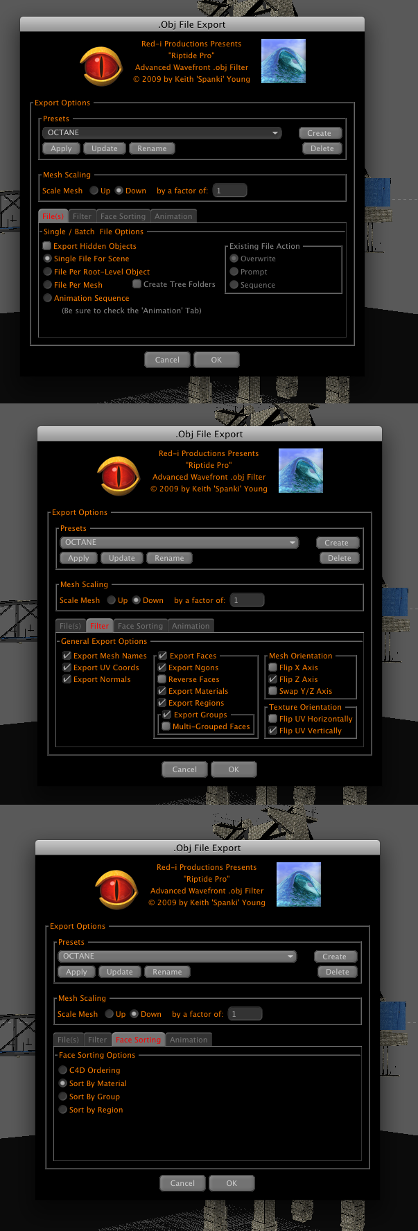

Hi radiance ,
here you will find the screenshots of raptide pro settings.
Any advice so that Octane doesn't crashes when i import the scene exported through Riptide Pro ? And keep the textures ...
can you try with the export mesh vertex normals enabled, and using the new 2.2 RC1 i just posted ?
Seems to be working very well, thank you :)
