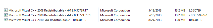

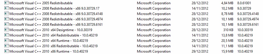

Can you please open the installed software window available in your Windows 8 control panel and make a screen shot like this one with all your Microsoft Visual C++ packages?
I can't figure why the test plugin doesn't install. The only problem I can imagine is try to install it in a x32 LW or don't have the needed Visual C++ redistributable package

Here is a screen shot of the Microsoft Visual C++ packages I had installed. I uninstalled all
packages and still got the same error. Now I only have the 2010 installed after I reinstalled it.
I installed LW 11.6 x32 and Octane x32 and still got the same error.
