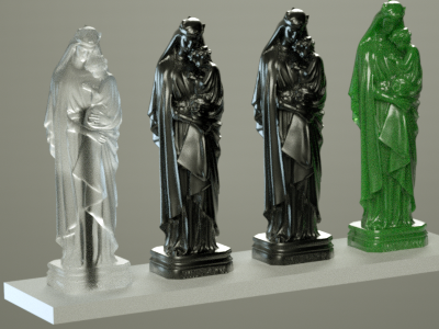

Hi Aoktar,
I tested the sample scenes and noticed that the 2nd and 3rd SSS-Madonna-material in the basicmaterial samples are not working, meaning they are not rendered as SSS.
