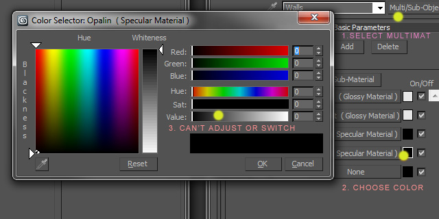

mbetke
Posts: 1297
Location: Germany
Stumbled upon a strange bug.
Can someone try to reproduce?
Just try to change the color from a multi-mat. It resets itself everytime to another value after trying to select a color.
See attachment
