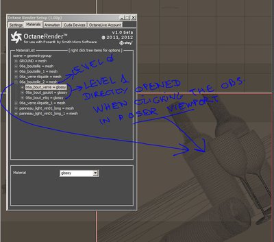

i just meant that when you select an object, actually, it selects automatically the material concerned ( which is great ! ) but just the level 0 ( see pict. attached), i propose you the same process but develop the 1st level of the material instead of keeping it 'closed': it just avoids to open it ( gain of 1 click ) -> hope you understand, here is a screen capture to illlustrate

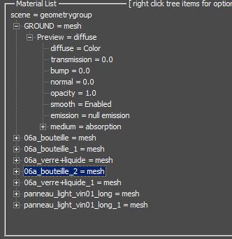

..and when there is only 1 material in the object, the must-have would be to develop directly the material tree, which become the 'level 1' ( picture attached)... if possible of course ;)
Ah, so would like the Poser prop/Figure selected AND expanded (so you see all the prop/figure materials)? Keep in mind also that as you click more Poser props/figures, it will expand more of the tree making it look a little "messy".
