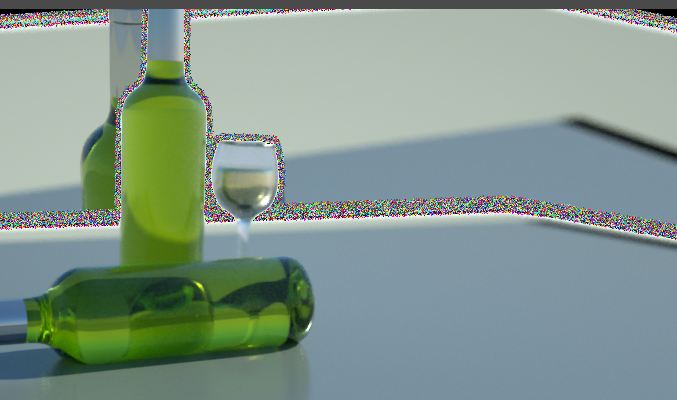

after more tests, 2 things:
* do you plan to add "float 3" parameter for texture scaling ?
* there is a bug when rendering with both "alpha enable " and "keep environment" functions enabled. ( look at the picture attached)
but even without environment alpha seem to be buggy
regards

* there is a bug when rendering with both "alpha enable " and "keep environment" functions enabled. ( look at the picture attached) but even without environment alpha seem to be buggy
You are right Vincent - I had not noticed this before. The bug is in the DISPLAY ONLY, and if you save to PNG/EXR the problem is not present on the saved image. I will fix this in the next version.

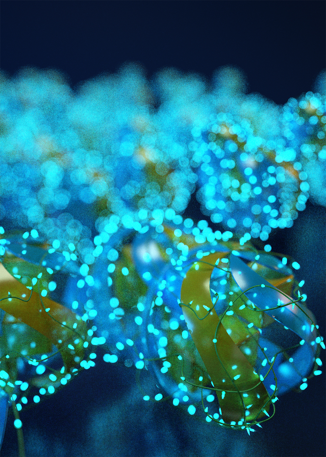

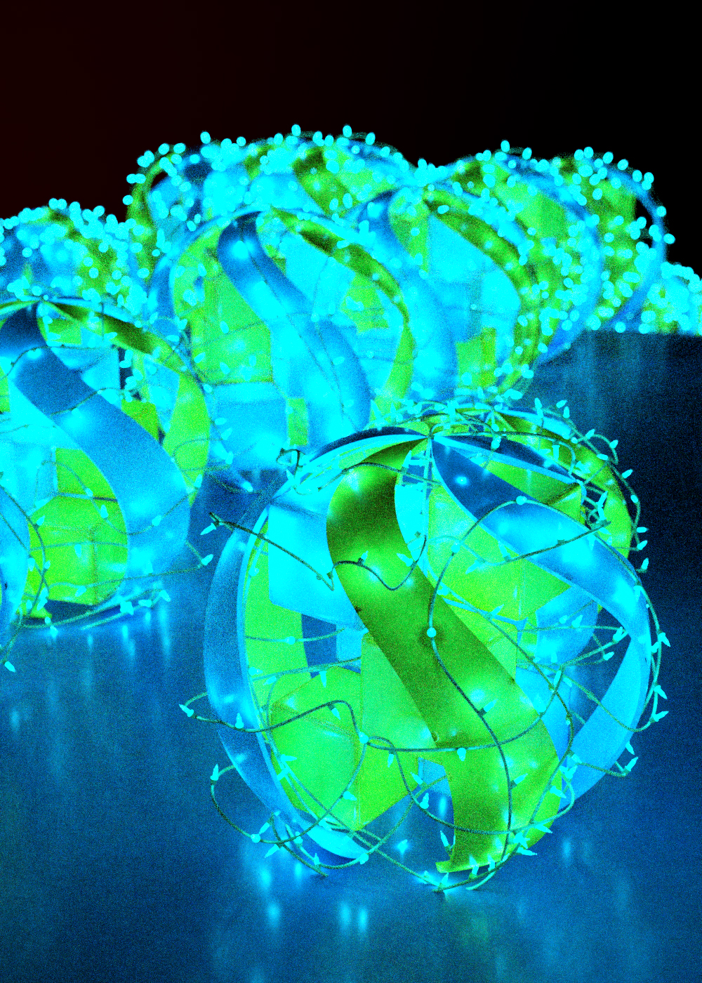

Couple of emitter instances.
I notice in 1.01d when I click on resolution in the plugin window I no longer can alter the values... is this a new thing with a different place to resize the window, a bug on my end... or something new in d?
Thanks mate
face_off
Posts: 15813
Location: Adelaide, Australia
Wow - Peter - believable renders!!! (I'll post those on the FB page if you don't mind - low rez).
Have you tried the caustic slider on renders like this? Does is take out the graininess?

I'll try that caustic slider on another render and let you know. I must admit sometimes I do like it when it looks like you shot it with an old film with a fast ASA rating and looks all grainy. But that just shows how ancient I am aye : > ))
Peter
