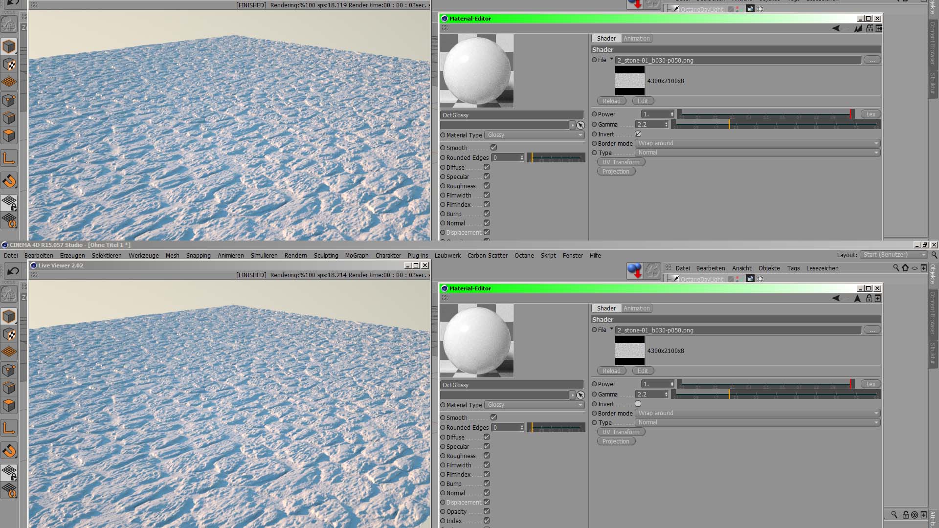

Hi aoktar
In the Displament channel the invert can't function. The image does not change.
Greetings Rudi
Posts: 16068
Location: Türkiye
Rudi wrote:Hi aoktar
Greetings Rudi
yes, it's limitation of renderer. Only works imagetexture and tranforms
Rudi
Posts: 188
Joined: Sun Sep 01, 2013 7:05 pm
In other words, it stays that way and you can do nothing at all? :(
Posts: 16068
Location: Türkiye
Rudi wrote:In other words, it stays that way and you can do nothing at all? :(
correct, we should expect some fixes on Octane core
Rudi
Posts: 188
Ah... :) So there is hope :)

Weezer
Posts: 376
Joined: Tue Dec 04, 2012 10:08 am
You can always just invert the image in Photoshop...
Rudi
Posts: 188
Thx... nice Idea :) First as a transition.

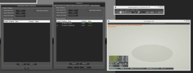

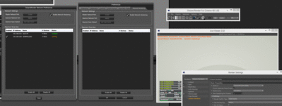

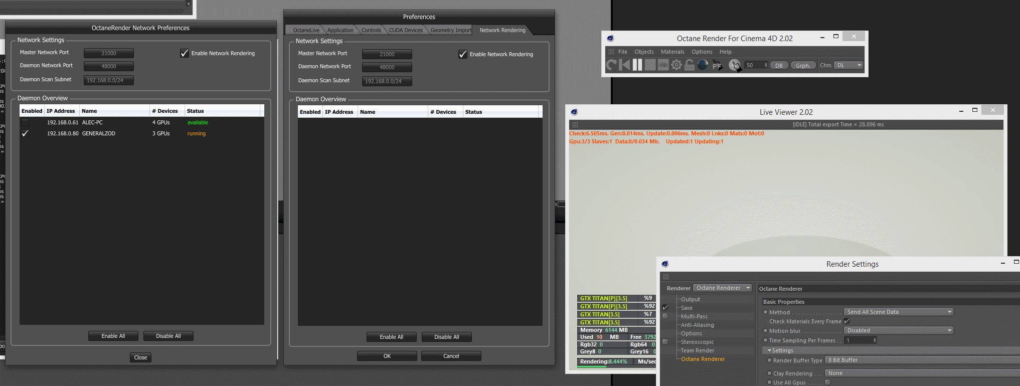

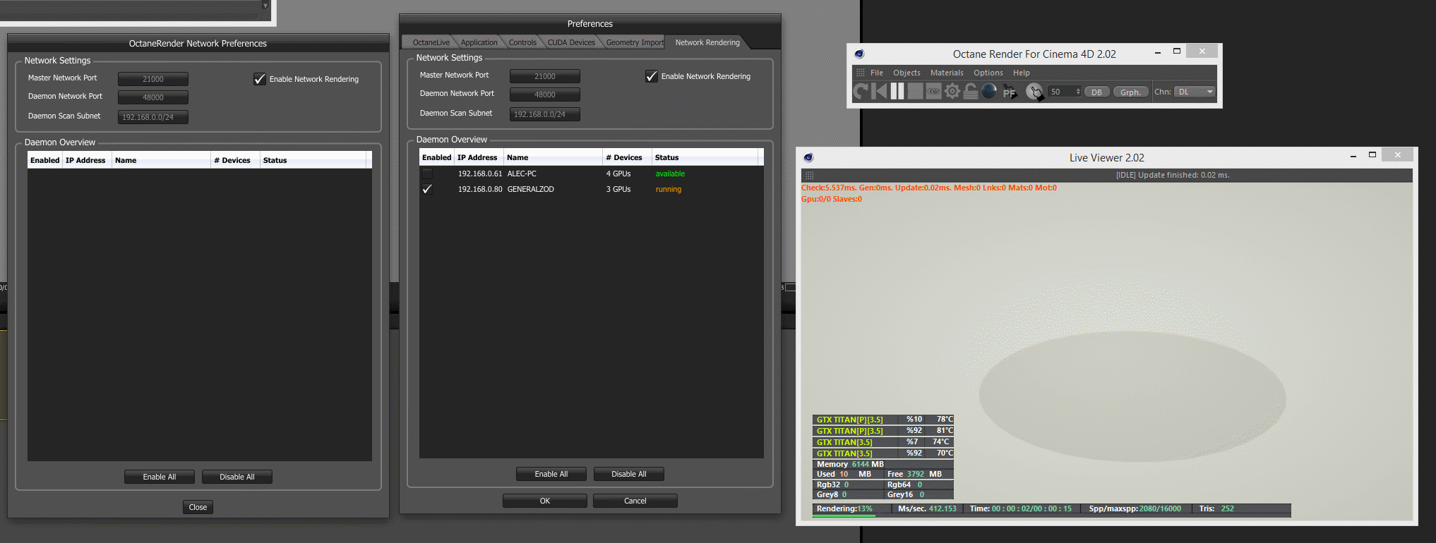

Network rendering is really random when it wants to work. Here is a screen shot of the devices in standalone and what octane is seeing:
Now what I had to do to get this to work, (For those of you who are having the same issues,) was to then turn off the standalone and then turn it back of so that the devices disappeared. Now you can go into the octane network preferences and check the devices you want to use.
My guess is that the plugin is conflicting with the standalone settings? Hopefully this can help Aoktar to make this process more streamlined.
A neat trick I had been shown to "unfreeze" the network settings when opened from Cinema is to click on the cinema icon on your task manager and makes the window unfreeze.
