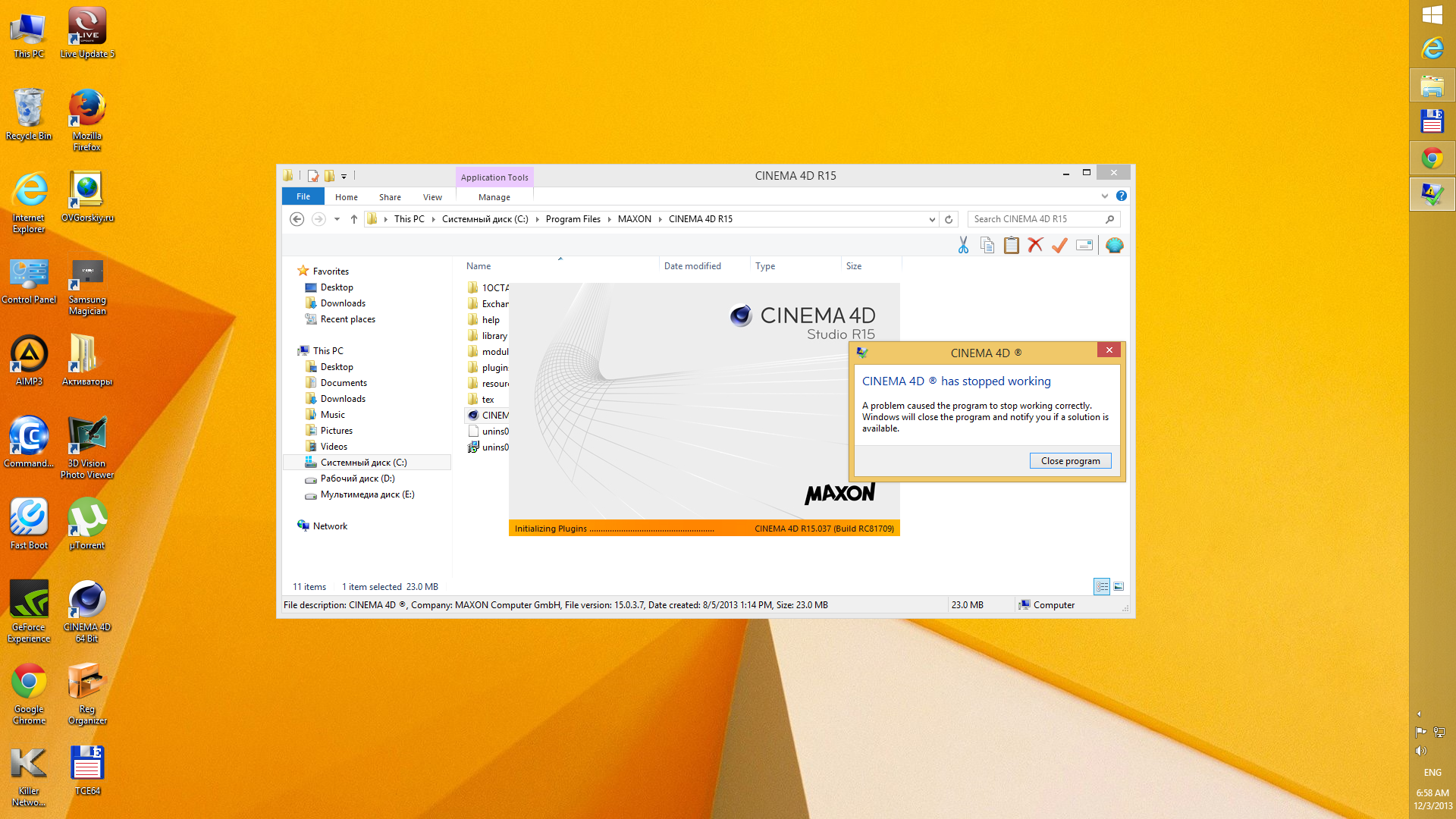

Help me ! Reinstalled octane render with laptop ( windows 7 Pro x64) on my home PC ( windows 8.1 Pro x64), set stendelon version - works very well ! Then set the Cinema 4D r15. it works great ! Then tried to install different versions of the plugins for cinema 4d r15 (0,96 / 0.99f / 1.00 RC1) - the same mistake! After installing the plugin , the program starts , but after entering the user name and password for Octane - is an error and shuts down and then not re-enabled . After removing the plug , again Cinema 4D r15 - excellent start. With the demo version of the plugin also works fine ! Tried all that is possible , even reinstalled Windows and all programs - again , this problem persists ! But I do not have "c: \ Users \ USERNAME \ AppData \ Roaming \ MAXON \ Cinema4Dr15_XXXXXXXXXX \ _bugreports \ _BugReport.zip", what would you show ((( error takes Windows (((

Hi Architect3D
You are not alone;) I can confirm all these symptoms for windows 8.1 x64 + R15 too: crash at start(official plugin 0.99f or RC1,RC2), no bugreport log, useless clean install of any geforce driver.
But standalone version works like a charm(activated, rendering).
There is temporary workaround for that from Aoktar: "You can try activate on R14 and run R15." Maybe it helps you.
Octane team works hard to fix this inconsistency with windows 8.1, so stay tuned.

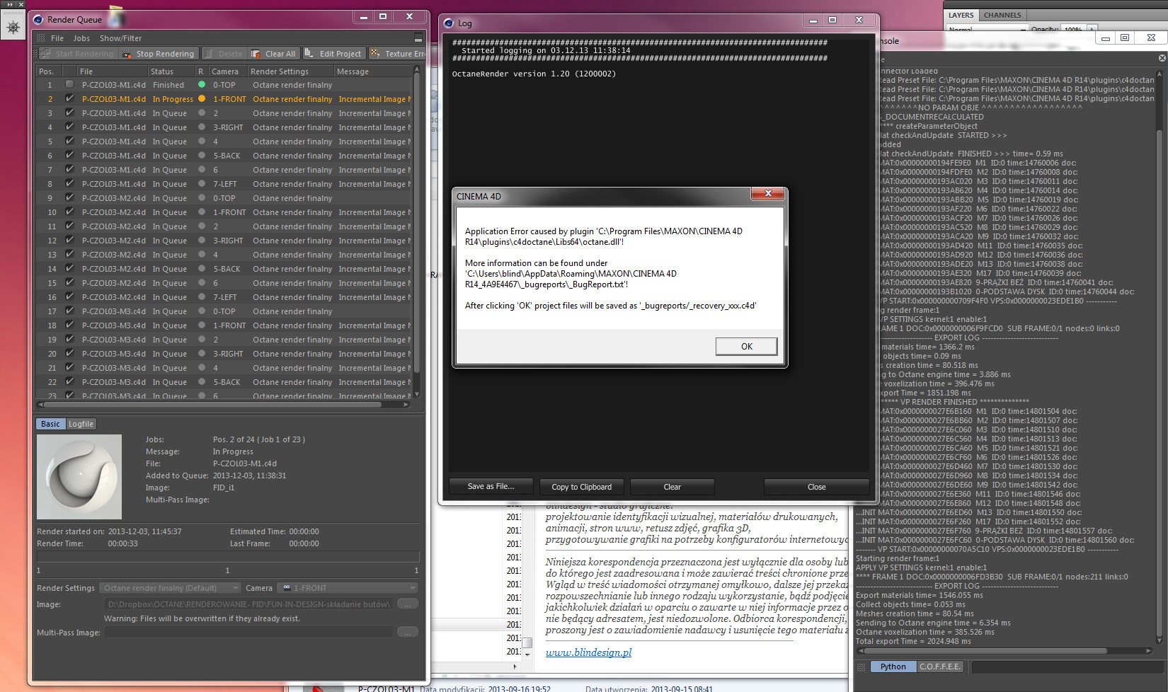

bang!
RC2
in the bugreport file - nothing..
