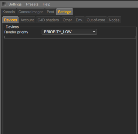

Dear Akhmet,
Version 3.00 - Alpha 6.3 doesn't see my Titan 980 Ti, please see screenshot attached.
Using Mac Pro 5,1 OSX 10.11.4, nVidia driver 346.03.06f01
When I roll out back to 2.25, it's all working ok and Octane sees the card.
Any suggestions to troubleshoot?
Thank you!
Posts: 16068
Location: Türkiye
CUDA requirements
Due to a CUDA compiler bug we had switch to CUDA 7.5, which means on Windows and Linux you may need to update your NVIDIA graphics driver to a current version which supports at least CUDA 7.5. On Mac OSX you may have to update the CUDA driver for Mac to a current version supporting at least CUDA 7.5.
