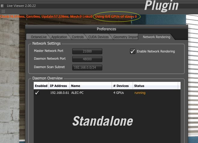

Hi Ahmet
I've been using distributed rendering with two machines just fine until this (2.02) version. The plugin is just not seeing my other computer. The standalone sees it fine. I'm missing some serious rendering horsepower. Can you fix it? Anyone else? Seems real flakey now.
alec
Alec Syme
http://www.fuseanimation.com
-Gigabyte X79-UP4 - Intel i7 3930 3.4 - Windows 8.1 Pro 64bit - EVGA TITAN X7 - 32 Gigs Corsair 1600 4 channel RAM -
Posts: 16068
Location: Türkiye
ASyme1 wrote:Hi Ahmet
alec
are you sure that you have installed exactly same SA and plugin. 2.02 and 2.02. Only reason i think this is.

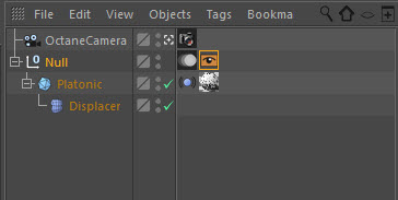

here is the file. its the same file i described a few posts earlier, where motion blur is alwas on fullvertex-mode. 'octane object tag'-settings have no influence and also 'octane render settings' have no impact at all- oce swiched on in 'octane camera tag' ist always on!
MB_test_2.zip
(75.63 KiB) Downloaded 224 times
Posts: 16068
Location: Türkiye
momade wrote:here is the file. its the same file i described a few posts earlier, where motion blur is alwas on fullvertex-mode. 'octane object tag'-settings have no influence and also 'octane render settings' have no impact at all- oce swiched on in 'octane camera tag' ist always on!
ok, pls do it as in image. Sometimes putting tag on generator objects which are on top level, this can cause ignore problem on our tags
