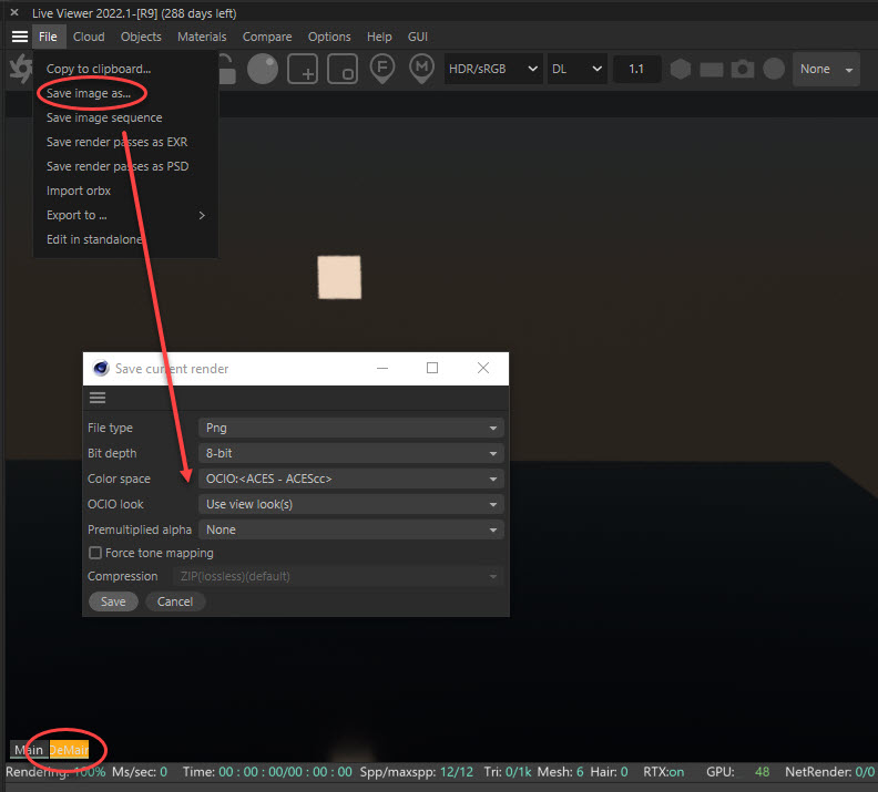

thanulee wrote:can we fix denoised pass when saving from LV to be in ACES as well? thanks
Fix? You can save it, see this pic

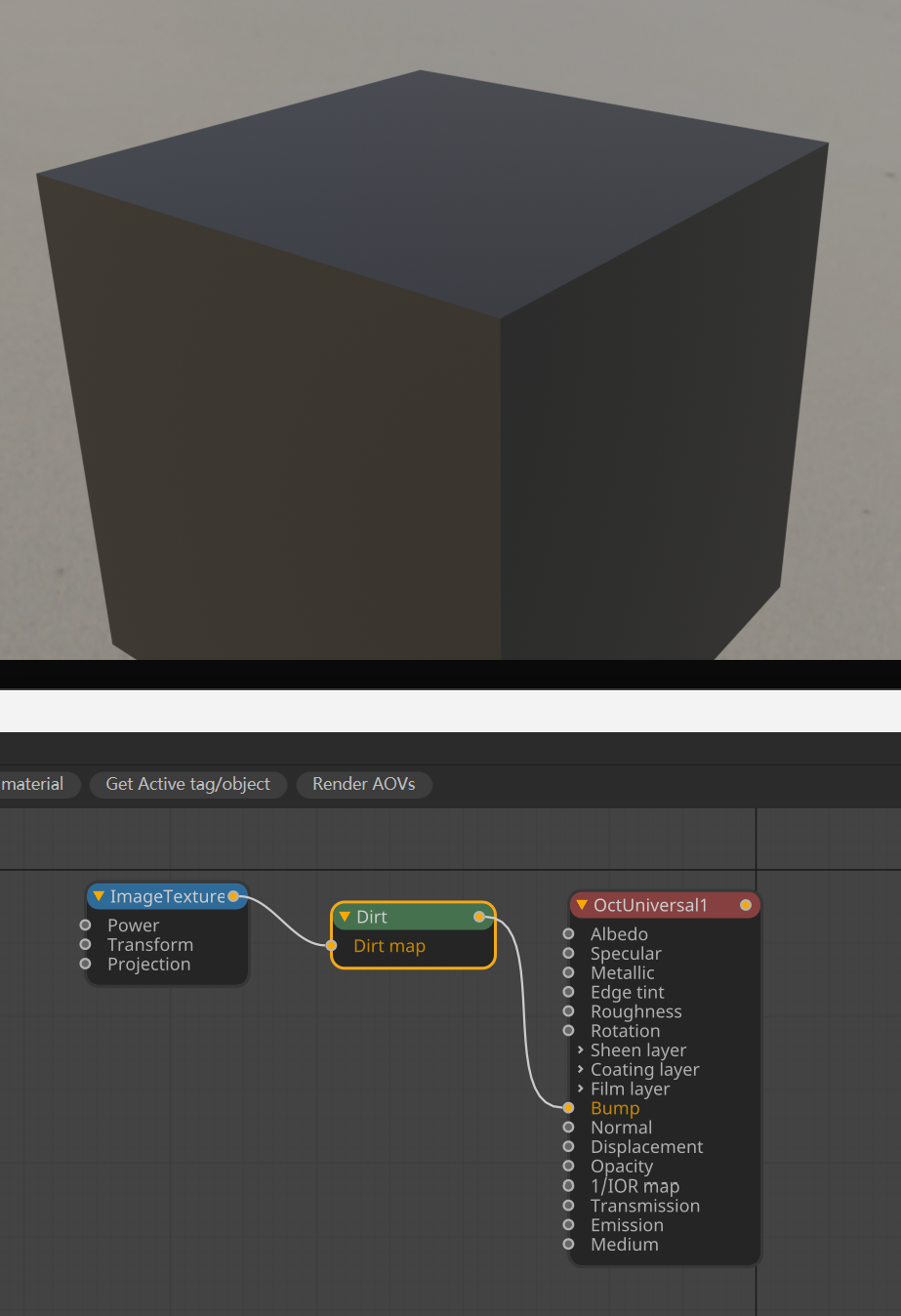

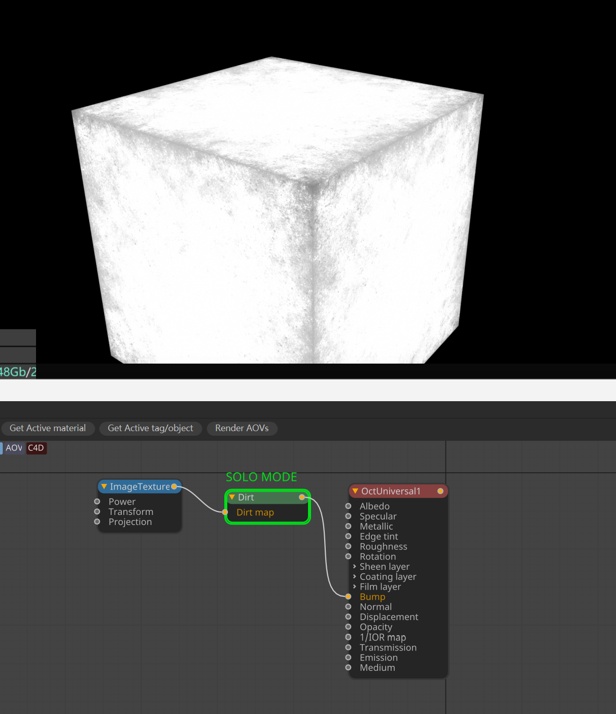

Does anyone know why the Dirt node does not respond when connected to bump or normal?
The previous version was working
Is this a bug?
Posts: 10633
RTF wrote:Does anyone know why the Dirt node does not respond when connected to bump or normal?
Is this a bug?
Are you sure?
Which exact previous version?
This is a core limitation, and shouldn't work in any versions.
You should need to have proper unfolded uvs, then use the Baking Camera to bake the Dirt to texture and save it to disk, then use it in your materials for Bump or Displacement.

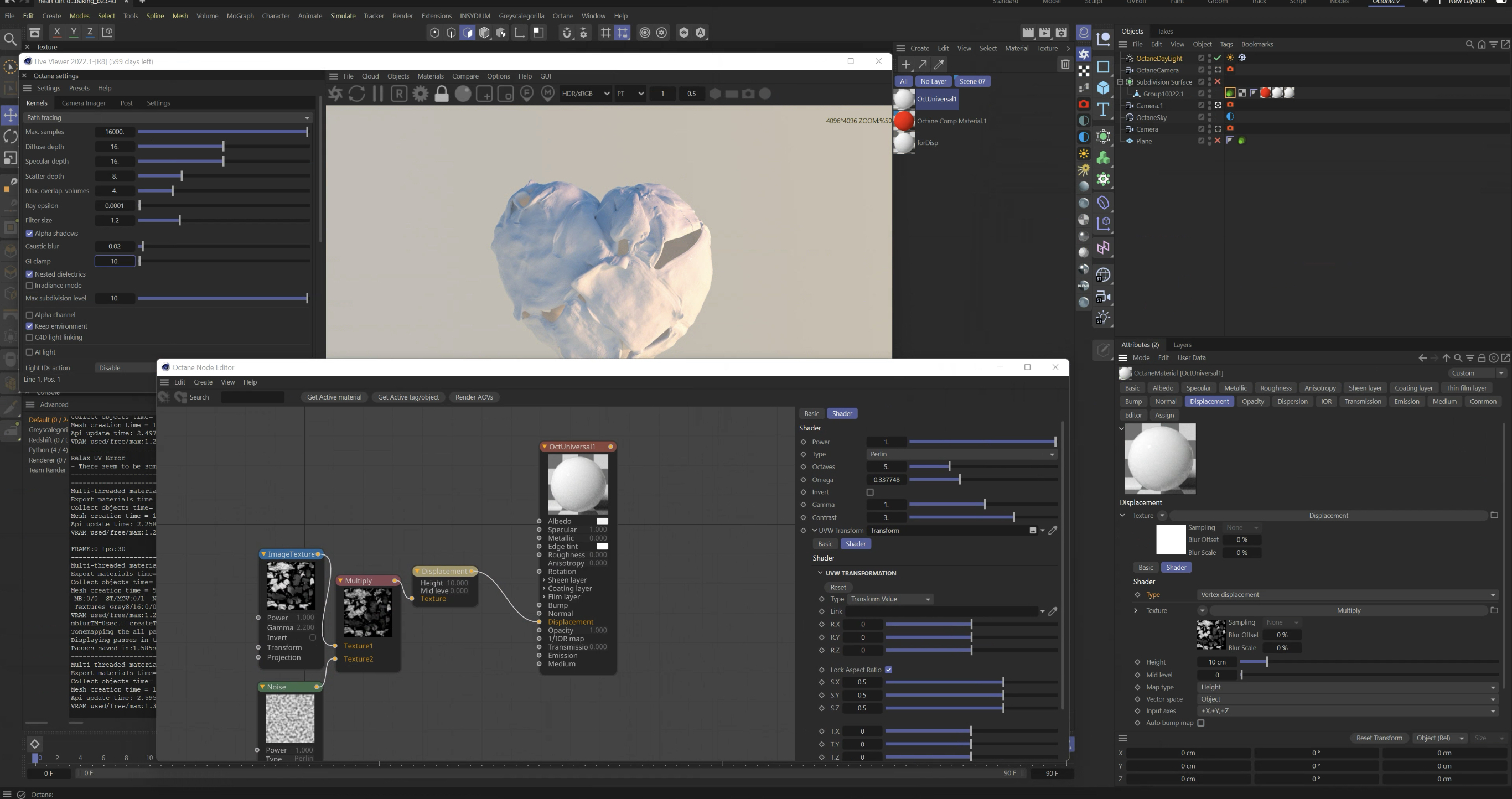

Someone in the forum has asked this question, when aoktar replied to the video inside the demonstration is possible
viewtopic.php?f=30&t=78897&p=407842&hil ... mp#p407842
