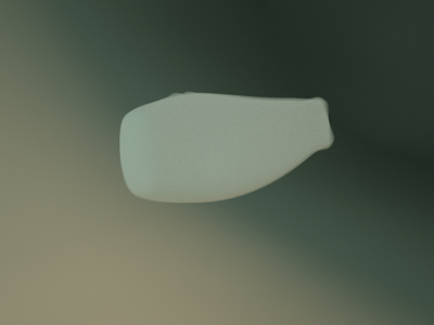

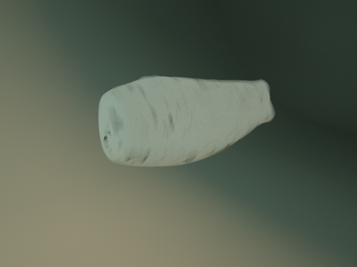

I have discovered another problem with motion blur. When Vertex motion blur is enabled I sometimes get black polys. When I turn off Vertex and change it to Transform The issue is fixed.
Vertex on:
Transform On:
Posts: 16068
Location: Türkiye
shawnfrueh wrote:I have discovered another problem with motion blur. When Vertex motion blur is enabled I sometimes get black polys. When I turn off Vertex and change it to Transform The issue is fixed.
Vertex on:
Transform On:
pls could you post your scene, for checking the issue?

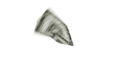

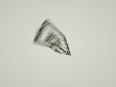

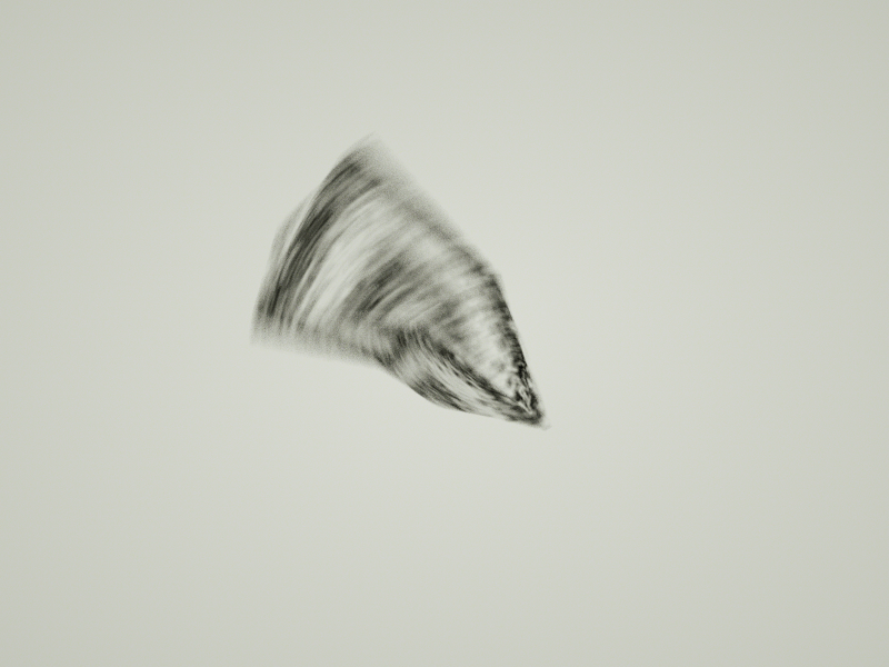

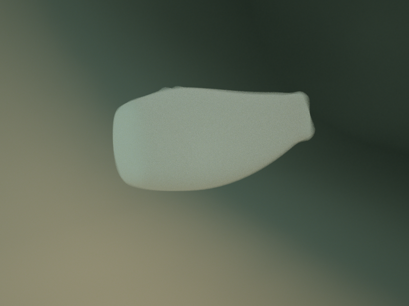

in 2.02 as motion blur in enabled in the camera-tag, the blur is globally always activated. no matter which settings are used in octane object tag or octane render settings.
plus: the images seem identical in lifeviewer/pictureviewer, but upon saving the png from pictureviever is significantly darker.
c4d win r15
file IS attached
br.
mo

rendered pictureviever with the options disabled-cameramotionblur-fullmotionblur
rendered in life viewer with didabled-transform-transforvertex
