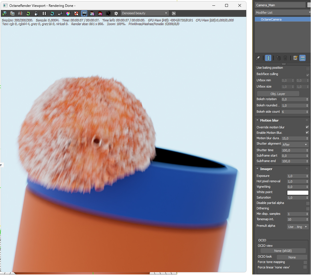

I've tried every settings available (mb duration, shuttertime etc...), nothing works when the displacement map is there

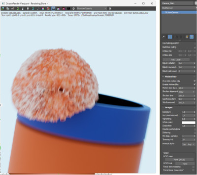

It's kind of working but only with these weird settings and not as it should (the black disk has motion blur, it shouldn't).
I've always used around 0,5 to 2 MB Duration in Octane with shutter time between 25 and 150, as soon as I put these value nothing is working correctly.
I have correct output when I remove the displacement map, please see this attached file (I'm not crazy ^^ !) :

Hi remKa,remKa wrote: Thu Jun 04, 2026 3:23 pm It's kind of working but only with these weird settings and not as it should (the black disk has motion blur, it shouldn't).

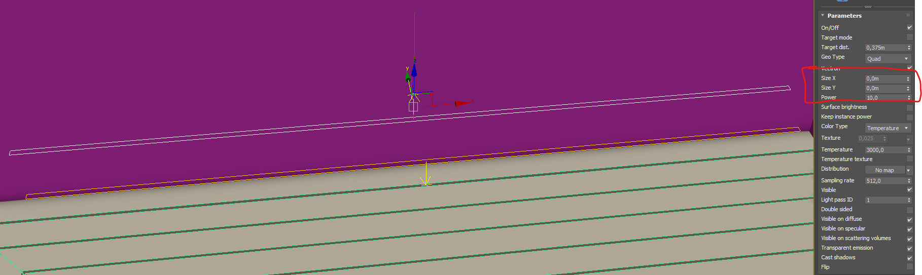

OctaneLight has no size when opening a scene from Octane 2025. But it is displayed with proper size in viewport. Had this in several files now.
