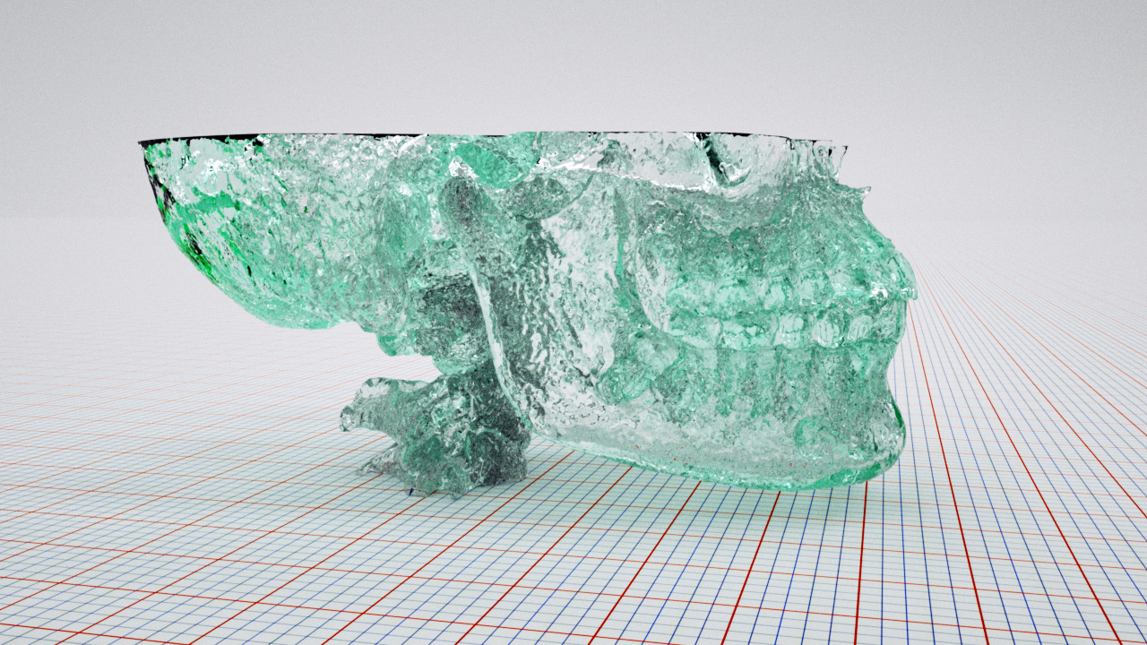

I've got to ask, is that a digital scan or a custom modeled skull? Eitherway it looks awesome!

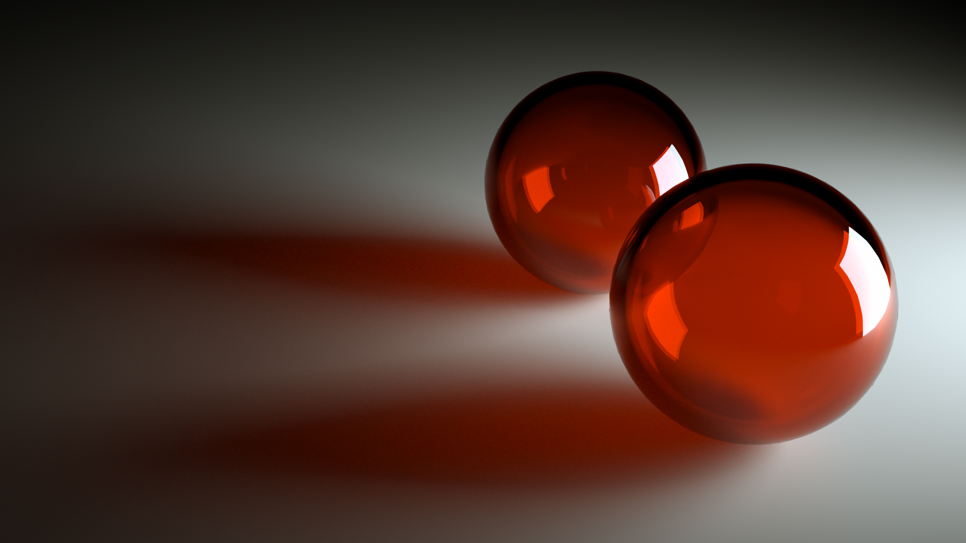

sphere test

@Draydin_r:
the skull is a 3d reconstruction from a CT 64 (computer tomography) ;)
