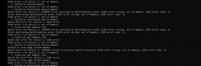

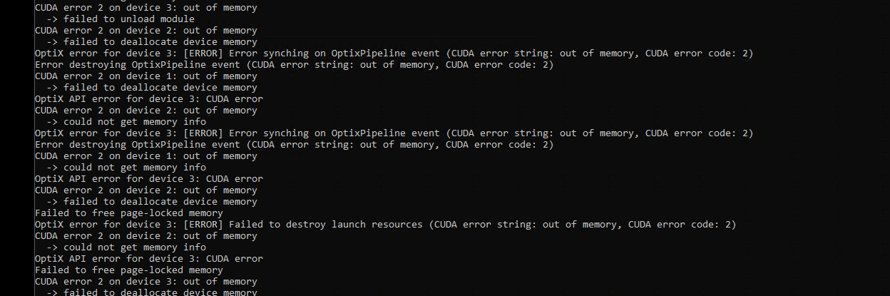

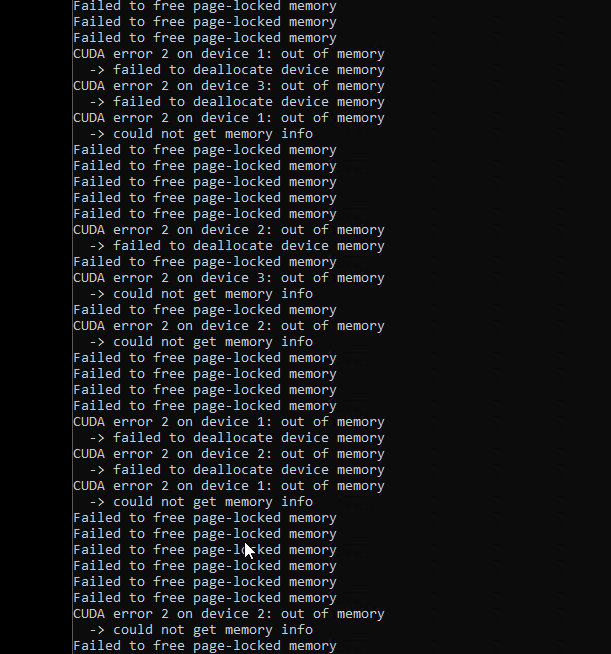

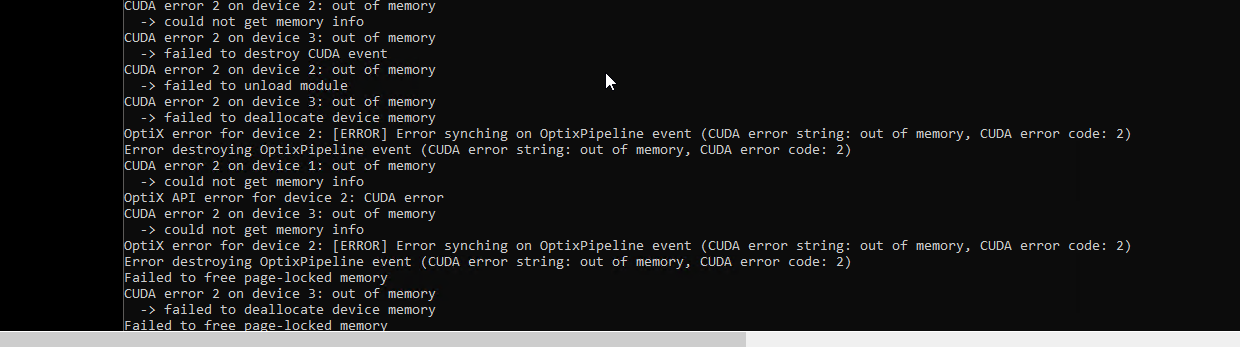

any idea? on my workstation works fine, but the server, crashs always
samsue
Posts: 393
can these problems be related to a bad video card?
