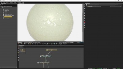

It looks like we have an issue with UV sets when using Random Walk (thanks Shaun Lee Bishop for reporting it).
Basically the Albedo input in the Random Walk node is able to correctly use UV set 1 only.
Just load the scene in Standalone 2020.1 XB2 and start the preview. The mesh has 2 identical UVs. Everything looks fine when UV set 1 is used:

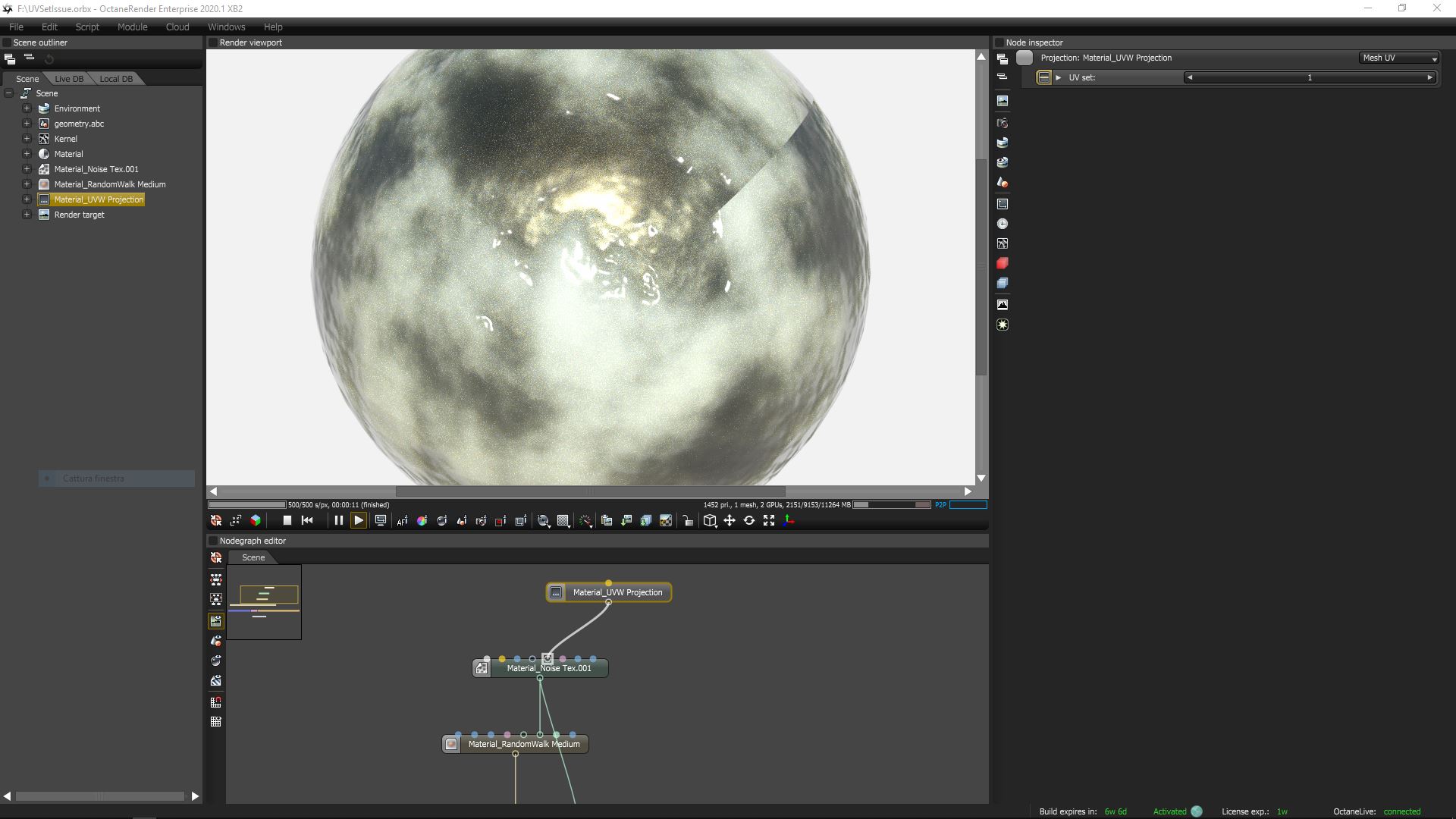

Now change the UVW Projection to UV set 2, and you'll get this:
Thanks!
