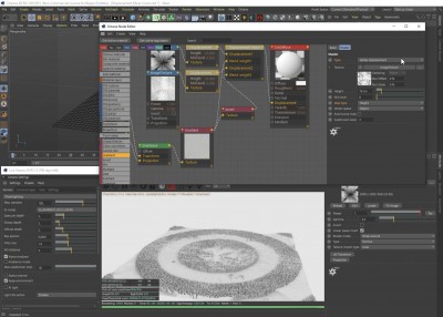

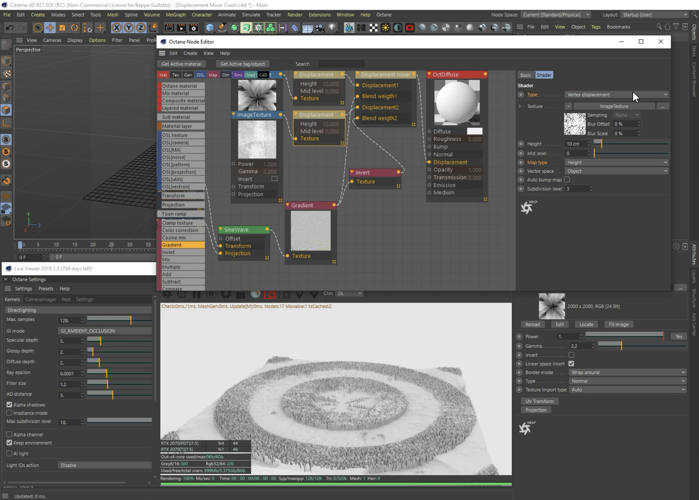

Does displacement mixer work?
As for me, it either doesn't work, or crashes the moment I use it.
Displacement Mixer Issue.rar
(5.81 MiB) Downloaded 359 times
Posts: 10632
displacement Mixer is rock solid here with 2019.1.3, maybe you have an issue with Nvidia driver.
To make it works in your scene you need to change the Displacement type to Vector Displacement, and change the Map type to Height.
ciao Beppe

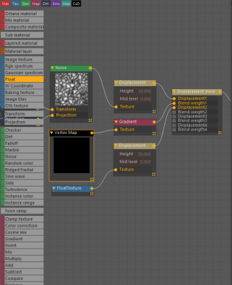

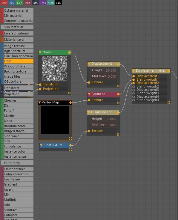

I'm not having success using a fields driven vertex map as an input for the "Blend weight" of Displacement mixer.
Auto bump works with the mask giving the illusion that the surface is deformed but the actual vertex have not moved.
Seems like all other shader inputs work just fine. Is this a core issue or am I doing something wrong? Scene file attached.
Vertex Map Displacement Mixer problem.zip
(168.51 KiB) Downloaded 307 times
