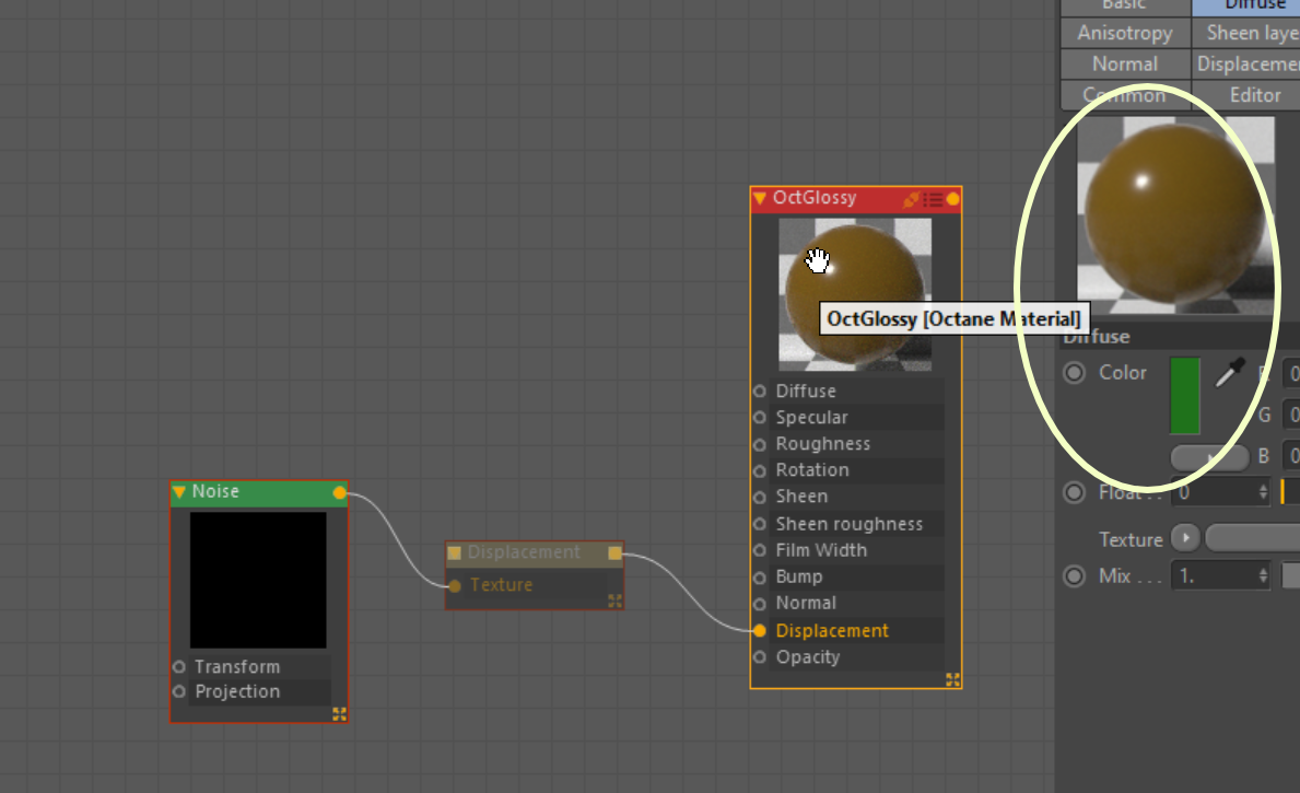

Color inputs or previews are buggy.

Iceman9 wrote:Color inputs or previews are buggy.
Yes previews are buggy from CORE. Next SDK will be ok.
The problem in selecting a color I think is limited to when using the color chip (HSV). Using the RGB sliders seem OK.
