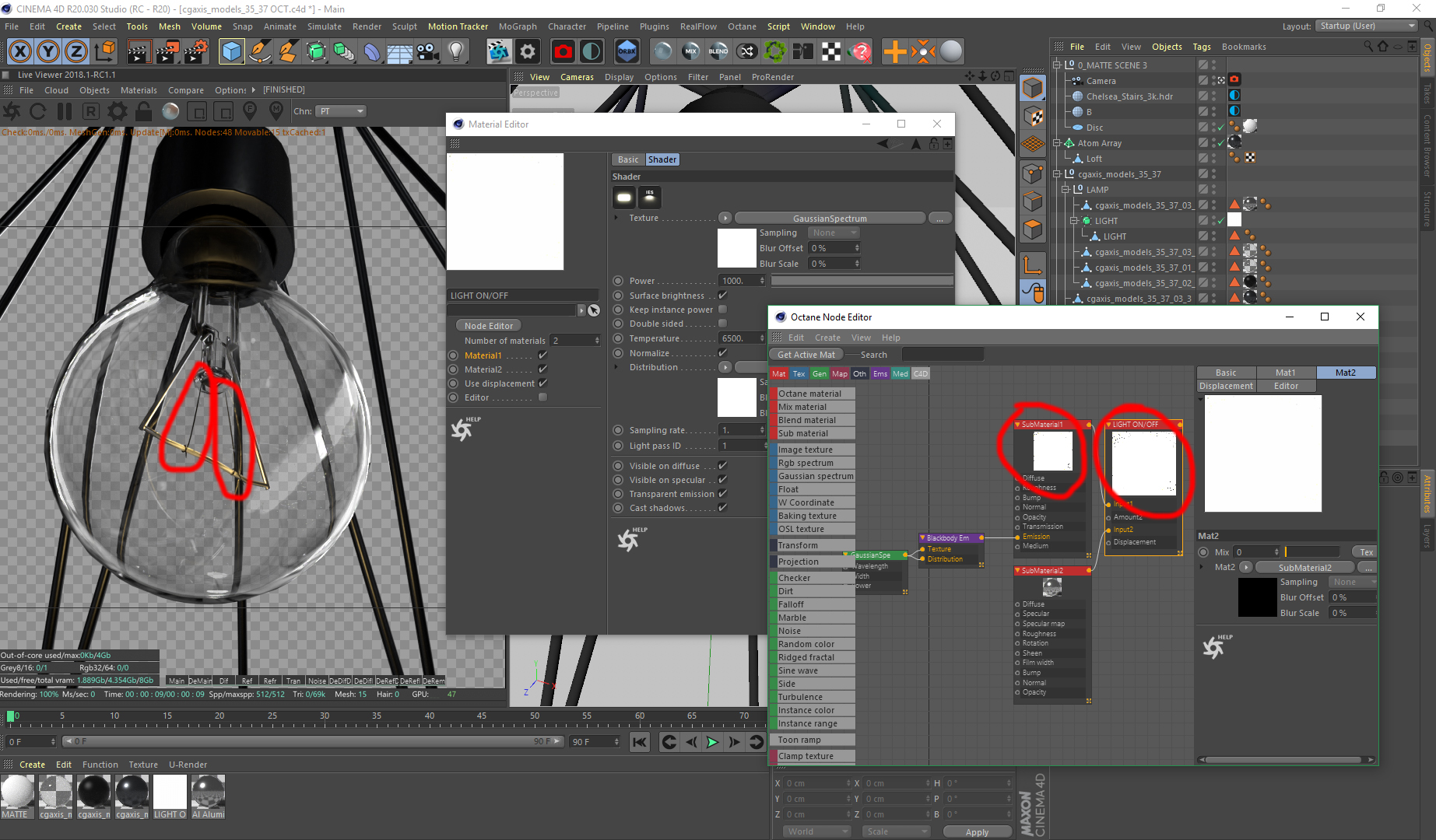

I've been playing with blend material and I found a issue: not sure if it's supposed to work like that but when I got a diffuse shader with emitter blended with another material, the light doesn´t behave as usual.
Look at the picture.
Thanks for all the good work, Aoktar!

PS: Like mentioned by max383, it also happens with MIX materials.

Kalua wrote:I've been playing with blend material and I found a issue: not sure if it's supposed to work like that but when I got a diffuse shader with emitter blended with another material, the light doesn´t behave as usual.
Cheers!
It's coming from a possible bug from the renderer. We'll look in to that.. Thanks!

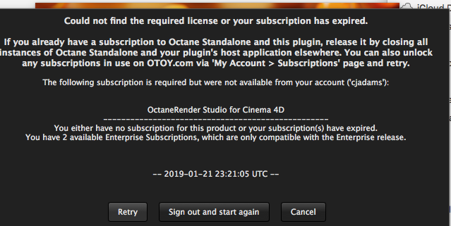

Ok. im at a loss here... Ive tried both builds "regular" and "studio" no luck the plugin won't log in.
I have done the V3 to V4 upgrade.. and also bought AA for 199... I don't see a C4d plugin in downloads so i came here to see if it just wasn't listed.
Now i tried the latest beta ones from at the beginning of the thread and i get an error looking for enterprise.. also why it says i have 2 is beyond me?
Is that for extra render slave or something???
Posts: 10611
cjadams wrote:Ok. im at a loss here... Ive tried both builds "regular" and "studio" no luck the plugin won't log in.
Please install the regular commercial version, not the Studio subscription version:
