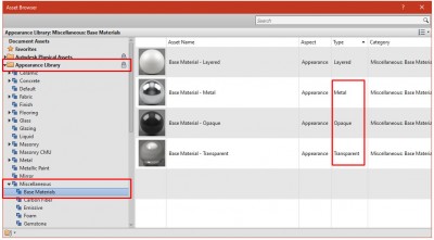

Hi Jan. I have been able to find some time to look into this, but do not understand your screenshots. I cannot see any "Parameter" section in any of the materials in Revit 2020. Under the Physical tab I see Information, Behavior, Basic Thermal, Mechanical and Strength. These do not translate to any Octane material nodes. Under the Appearance I see Information, Generic, Reflectivity, etc. I think I would need a copy of the .RVT file that you used for the screenshots above in order to be able to progress this feature request.I tried to markup how the conversion should be done.
Green marks converted values, red are fixed values which should be set.
1. Metal
- Hightlight shape "Long Falloff" translates to BSDF model GGX, short stands for Beckmann.
- All (used in this examples) textures need gamma setting of 1 except albedo, though I'm not 100% sure for transmission.
- Proper texture scaling for all textures should be converted.
- Inside Relief Pattern (Bump) settings is a switch for either normal or height map, that needs to be evaluated somehow and converted accordingly.
- Smooth should be default imo

The Revit material system can be quite confusing, materials are made up of assets, imo we can ignore all except "appearance" wich basically defines the shader.
Appearances marked with a yellow exclamation mark are legacy materials, at least in 2019 new materials are still created with a legacy appearance.
You can find new shaders in the appearance library.

I have had a further look at this. Firstly, the Revit API has no information on any of this. Even googling gives no help. I can tell you that "Aluminium - Bead Blasted" has a material schema type of "PrismMetalSchema" - and if you google that schema name, or search for it in the Revit 2020 API documentation, or search for the schema definition in the C# API, there is no trace of it. So there is a lot of reverse engineering required here. The traditional Revit schemas (GenericSchema, HardwoodSchema, ConcreteSchema, etc) at least have a definition in the API. So it is unclear if there are other schema's that are undocumented that I have not yet found.
I was able to reverse engineer through experimentation that the PrismMetalSchema and PrismOpaqueSchema schemas are the usual types for a material with a Parameters section in their appearance.
It would be possible to convert PrismMetalSchema and PrismOpaqueSchema materials to Octane Universal materials and leave the other schema materials converting to Octane Diffuse, Glossy and Specular materials as per the current rules.
However there would be some testing needed to get this right, and it may take a few iterations to get the conversion working as you need.
I am sure you will understand that this level of work is something I can only take on for licenses customers.
So in summary, if you have a plugin license (Enterprise or Studio), I can send you a test release, and tweak the rules as per your feedback.

In the API docs you can find classes like AdvancedMetal which looks like being connected to PrismMetal Schema, no clue how that works...
