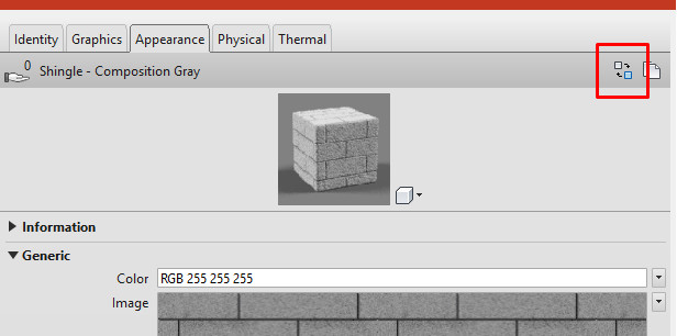

Hi Jan. I have been able to find some time to look into this, but do not understand your screenshots. I cannot see any "Parameter" section in any of the materials in Revit 2020. Under the Physical tab I see Information, Behavior, Basic Thermal, Mechanical and Strength. These do not translate to any Octane material nodes. Under the Appearance I see Information, Generic, Reflectivity, etc. I think I would need a copy of the .RVT file that you used for the screenshots above in order to be able to progress this feature request.

face_off wrote:Hi Jan. I have been able to find some time to look into this, but do not understand your screenshots. I cannot see any "Parameter" section in any of the materials in Revit 2020. Under the Physical tab I see Information, Behavior, Basic Thermal, Mechanical and Strength. These do not translate to any Octane material nodes. Under the Appearance I see Information, Generic, Reflectivity, etc. I think I would need a copy of the .RVT file that you used for the screenshots above in order to be able to progress this feature request.
Paul
Hi Paul,
thanks for looking into it. I'm using Revit 2019, but there shouldn't be any major difference to 2020, regarding material appearance.
I don't have any access to a file sharing system, but I could send you a file by email if you can give me the address.
The Revit material system can be quite confusing, materials are made up of assets, imo we can ignore all except "appearance" wich basically defines the shader.
Appearances marked with a yellow exclamation mark are legacy materials, at least in 2019 new materials are still created with a legacy appearance.
You can find new shaders in the appearance library.
