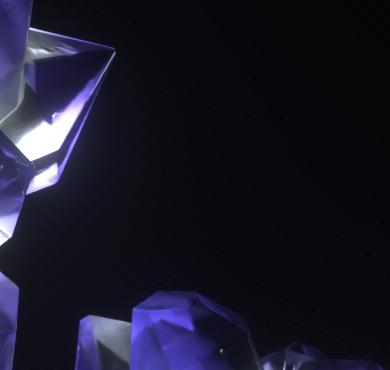

When I export a denoised beauty pass and open it in Photoshop it seems to have a slight transparency that isn't present in the original beauty pass. Format is PNG, no alpha and the background is an octane environment with power set to 0.
Is this the expected result?
