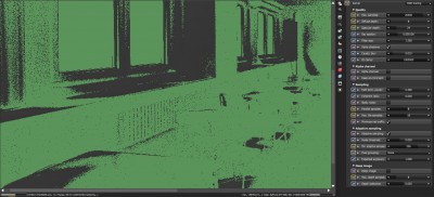

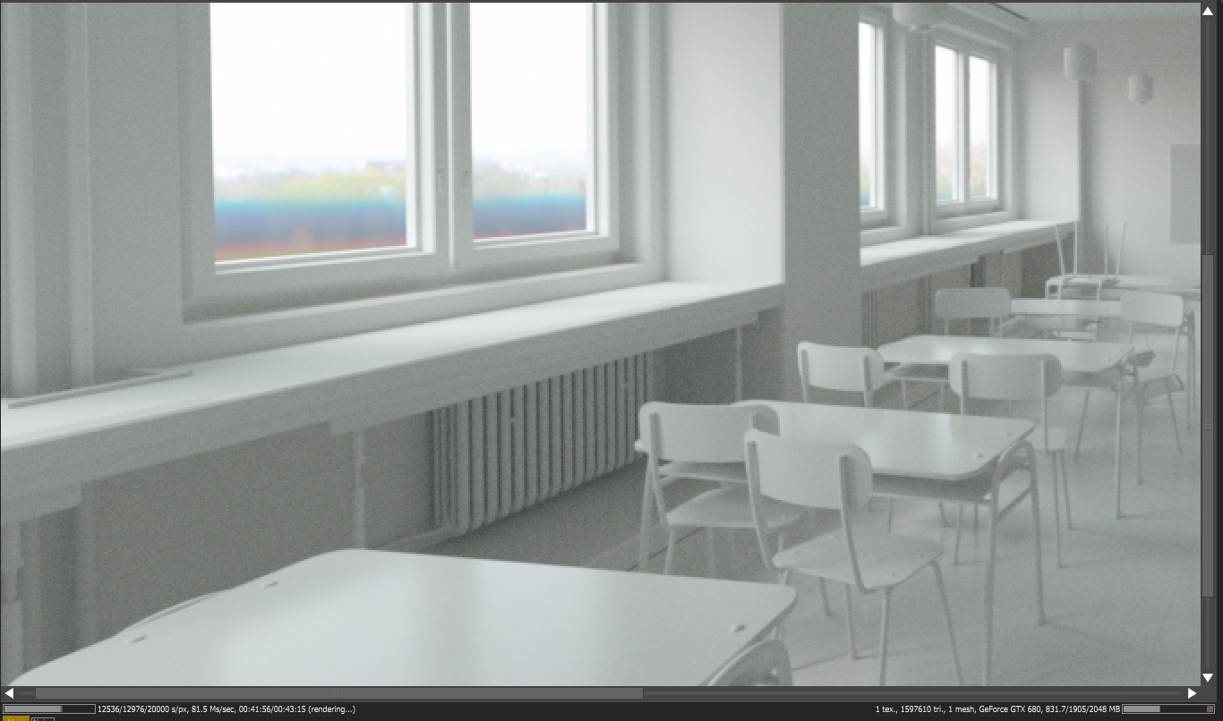

If I do not change the noise threshold to the lower side, is displayed correctly. I apologize for such a long post.
OctaneRender™ Standalone 3.06 TEST 3

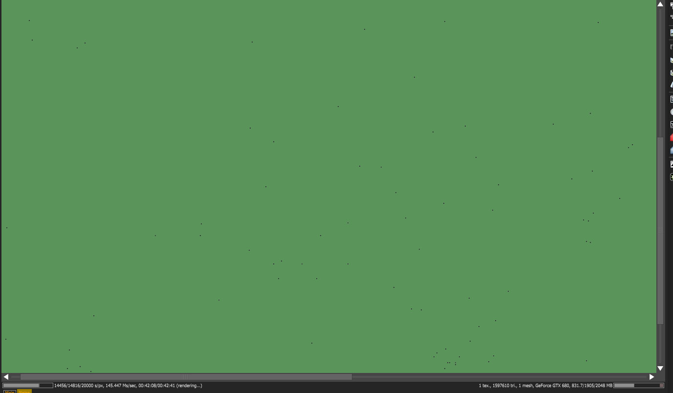

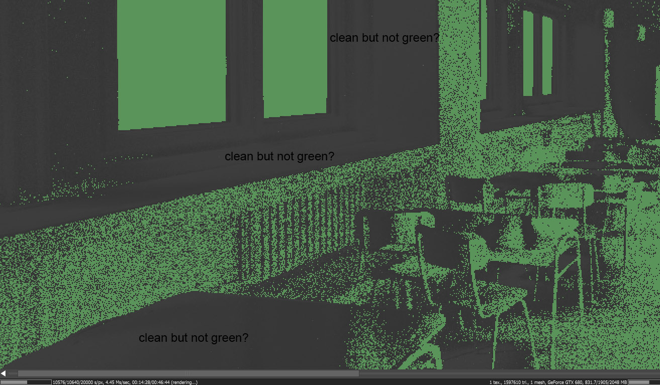

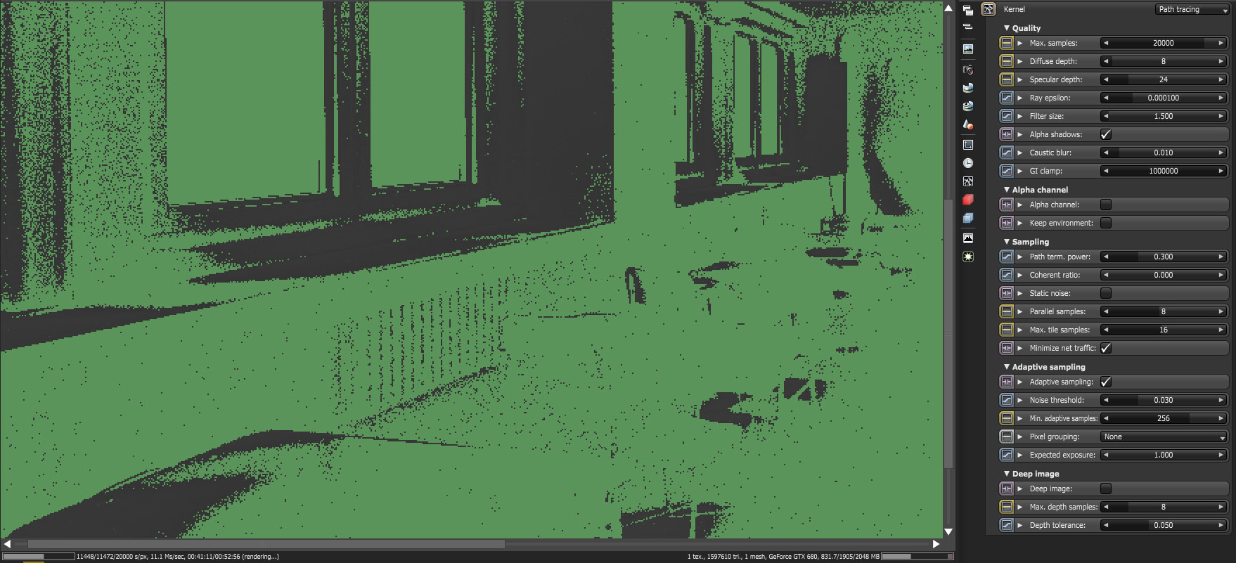

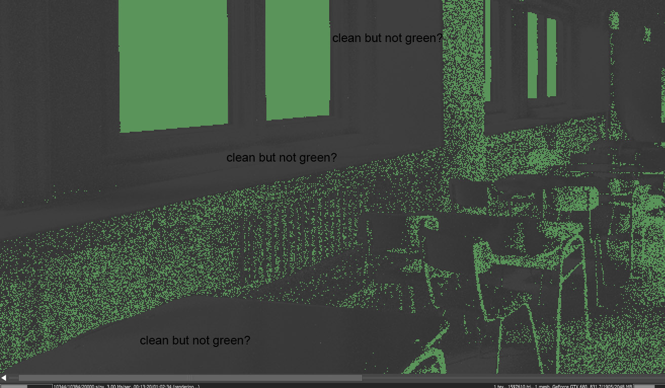

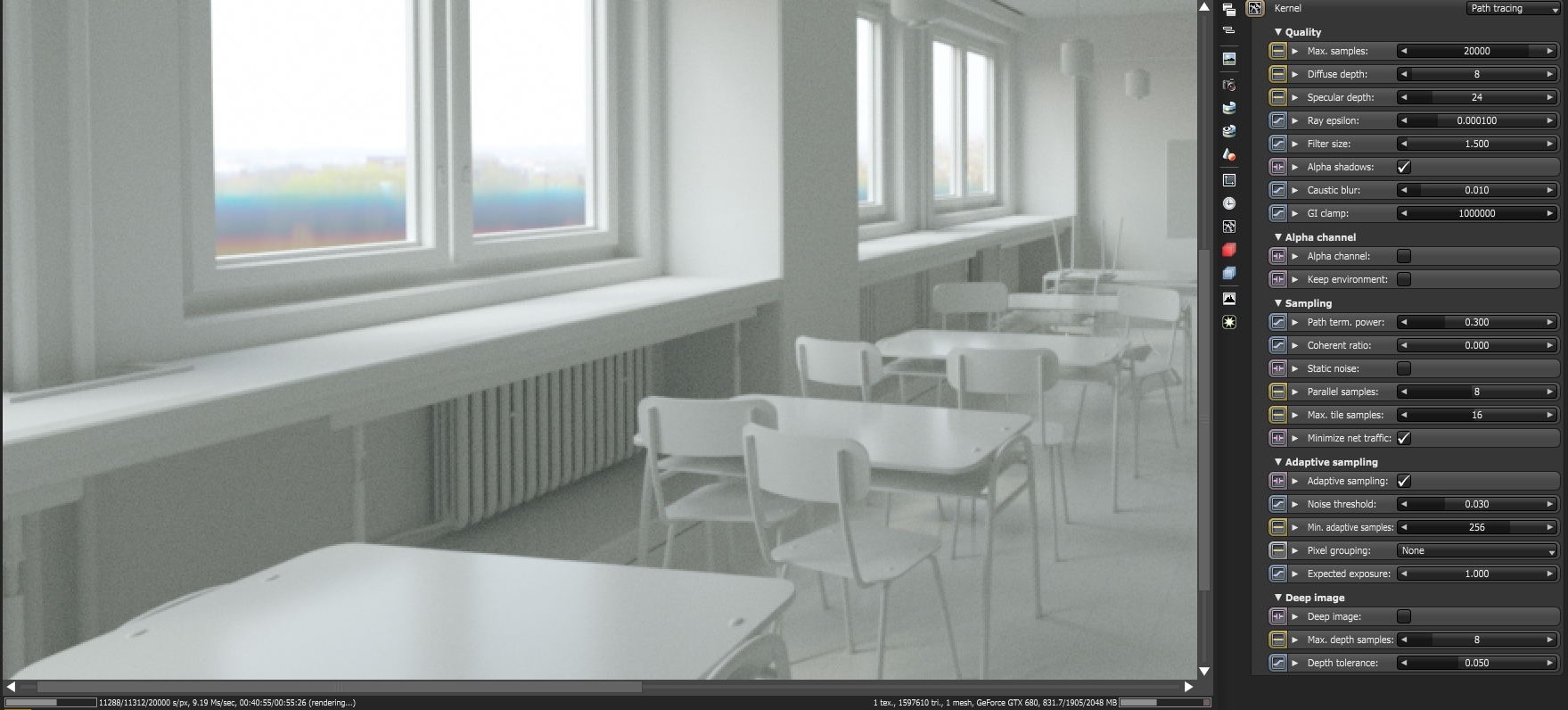

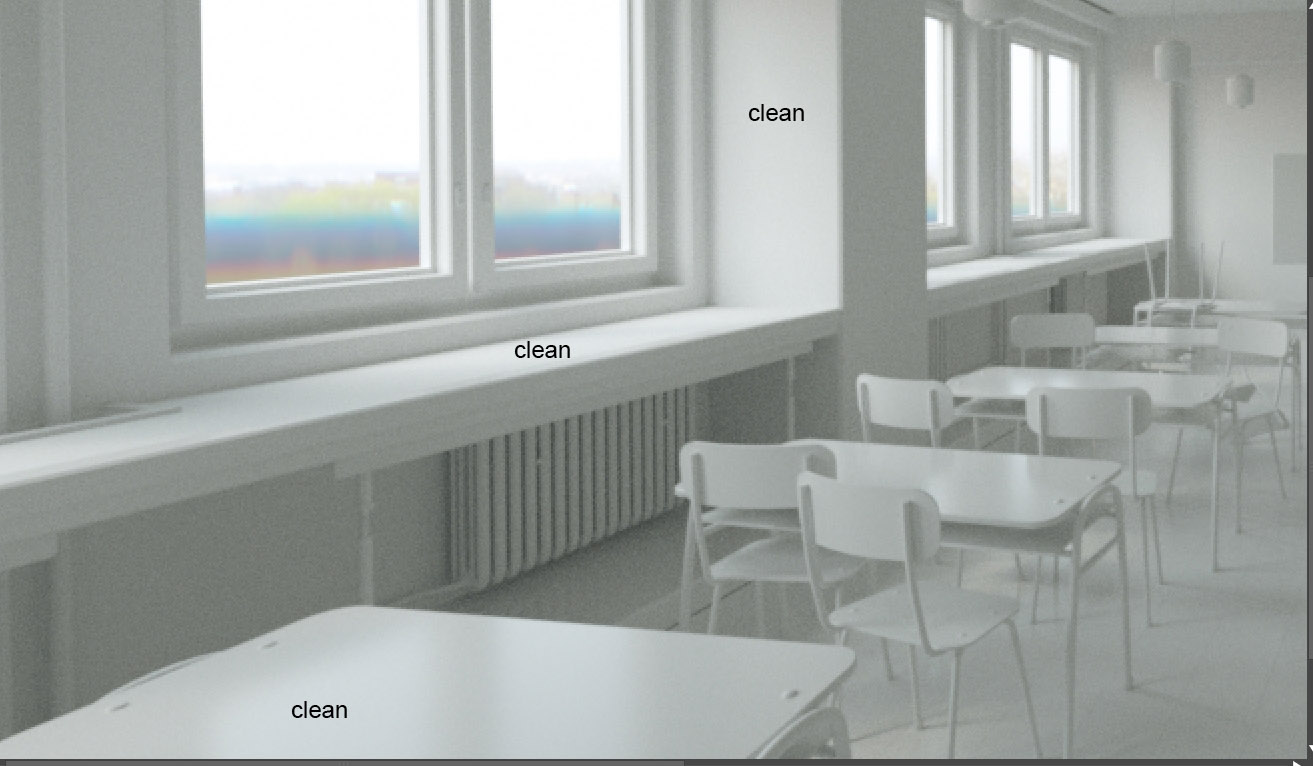

After changing the noise threshold during the rendering sampler does not work correctly. Shows that reached the threshold in dark areas and continues to render there where everything is clean, judging by noise passes.

Hi Mikinik, where you marked clean it looks like it is still a little noisy to me but more to do with glossy reflection. I think it is still trying to clean up that, that is why it hadn't gone green.

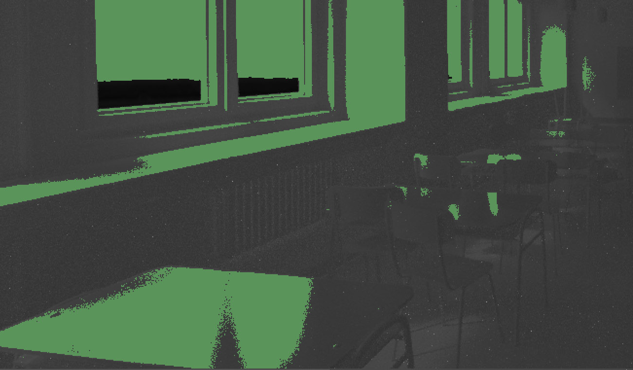

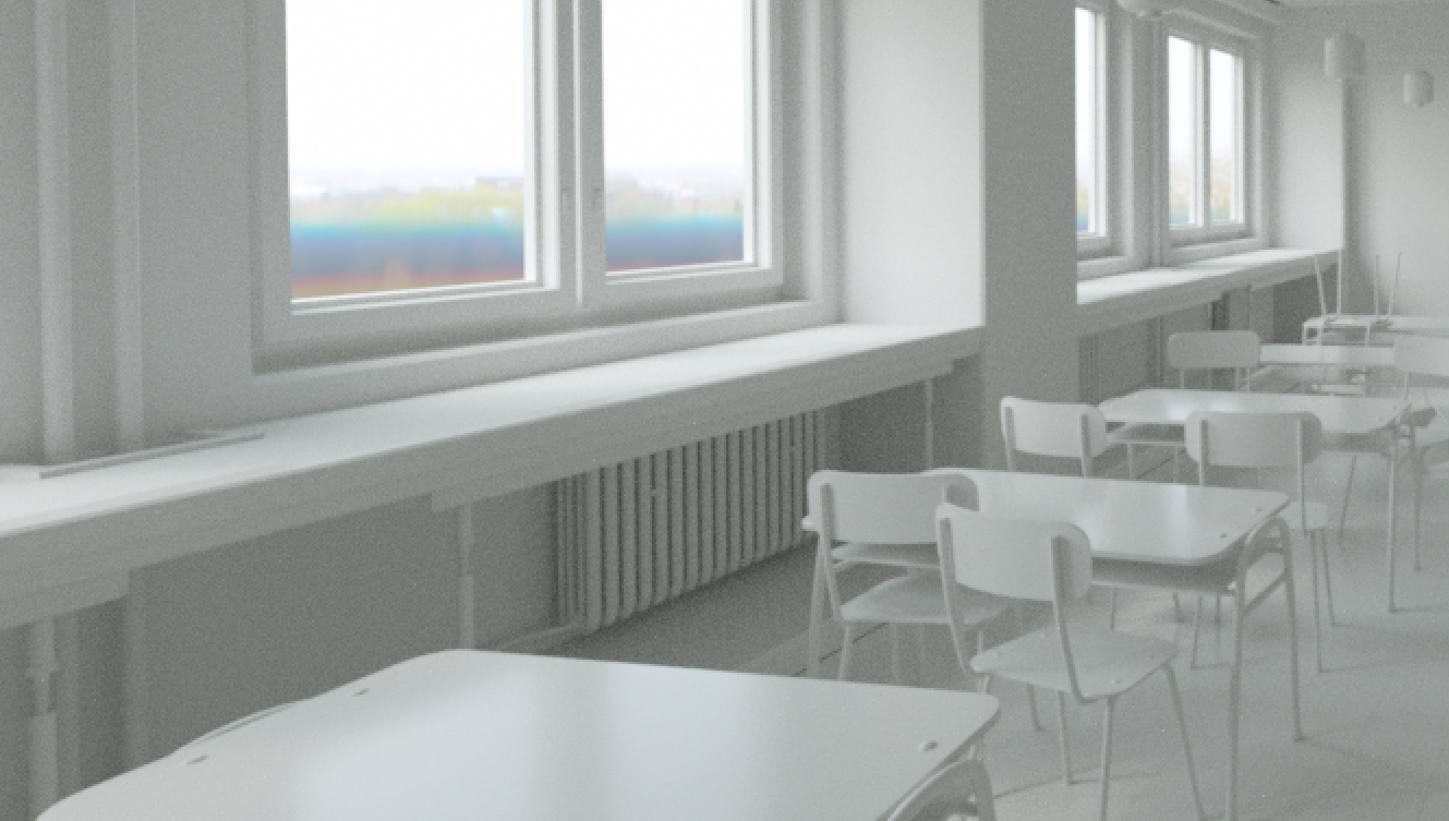

MildMustard, I think this is an error, the noise does not go away. On the second from bottom picture shows how it should be.

Oh ok, sorry i misunderstood. It could then very well be a bug.
