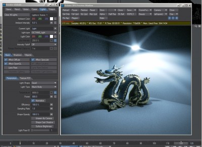

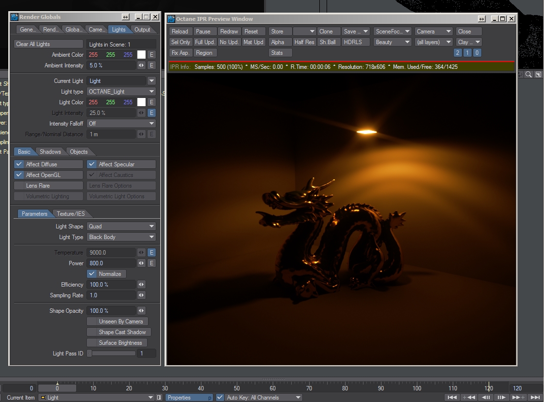

I remember Juanjo mentioning light parameter changes are now reflected in IPR but it is not working on my end. I have activated update light parameters in options and Mat Upd in IPR window but it doesn't update. I have a curve on light intensity and it gets the intensity on whatever the frame it was when I started IPR or reloaded the scene, but it doesn't update when I scrub the timeframe.
- BorisGoreta
- Posts: 1421
- Joined: Fri Dec 07, 2012 6:45 pm
- Contact:
I was changing the power parameter which doesn't have an envelope in your case.
I've tested also the power parameter and works fine. It seems a problem related to something in your scene. Can you reproduce this problem in any scene, even in a simple one?BorisGoreta wrote:I was changing the power parameter which doesn't have an envelope in your case.
