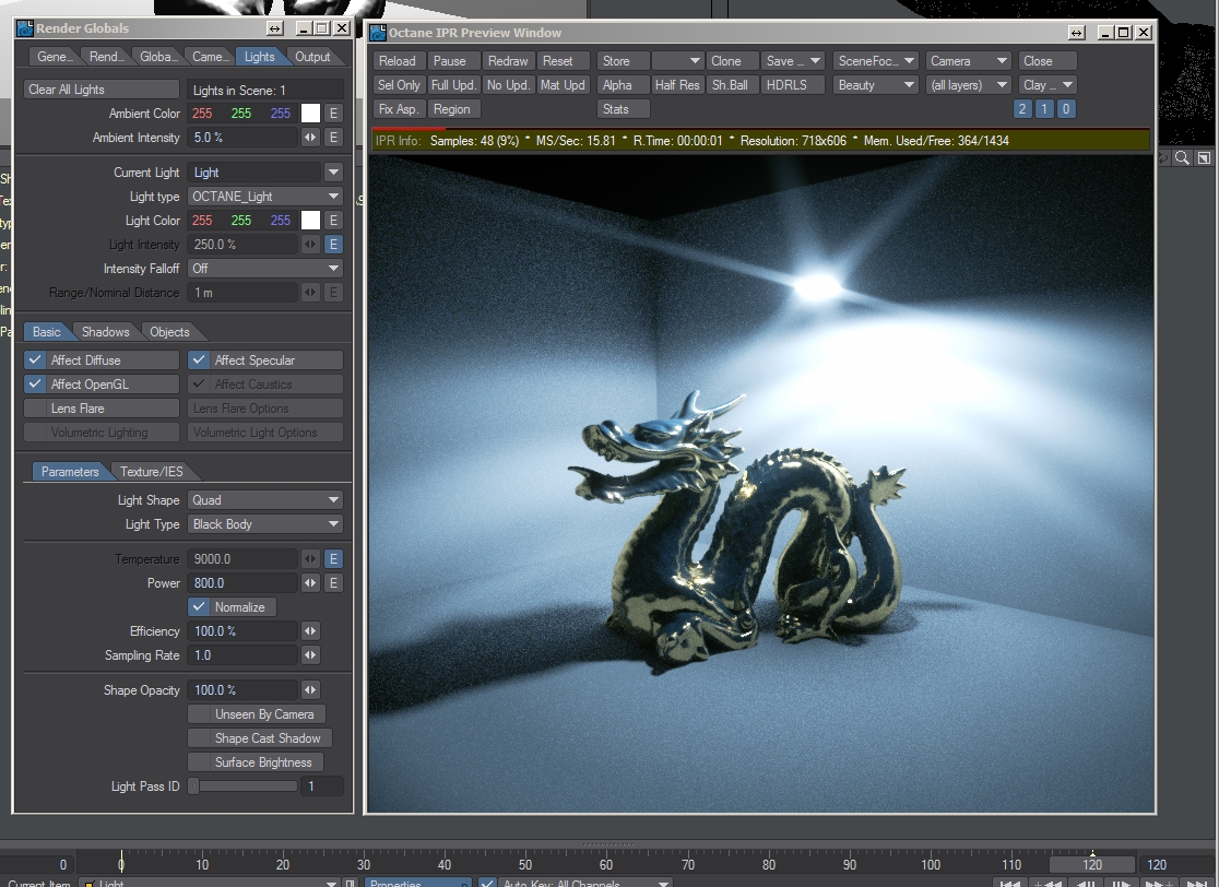

I remember Juanjo mentioning light parameter changes are now reflected in IPR but it is not working on my end. I have activated update light parameters in options and Mat Upd in IPR window but it doesn't update. I have a curve on light intensity and it gets the intensity on whatever the frame it was when I started IPR or reloaded the scene, but it doesn't update when I scrub the timeframe.
juanjgon
Posts: 8867
Location: Spain
Boris, can you send me a sample scene with this problem. I'm testing this feature here and it seems to work fine. in the sample images you can see how the IPR updates the light color and intensity scrubbing the timeframe.
Thanks,
-Juanjo
BorisGoreta
Posts: 1424
Joined: Fri Dec 07, 2012 6:45 pm
I was changing the power parameter which doesn't have an envelope in your case.
juanjgon
Posts: 8867
Location: Spain
BorisGoreta wrote:I was changing the power parameter which doesn't have an envelope in your case.
I've tested also the power parameter and works fine. It seems a problem related to something in your scene. Can you reproduce this problem in any scene, even in a simple one?
Thanks,
-Juanjo
