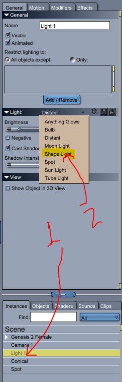

Also about the lights are we still working on setting Carrara lights to shape lights so they can have Octane emitter properties added to them. Its not bad doing it manually but would be great to give the user the option.
Do you want full access to the render target or just to a few parameters that you can override in the render room (such as max samples)? The thing is, overrides will work with the batch queue, full access will not.
I have not looked at shape lights before. I'll see what I can do...
